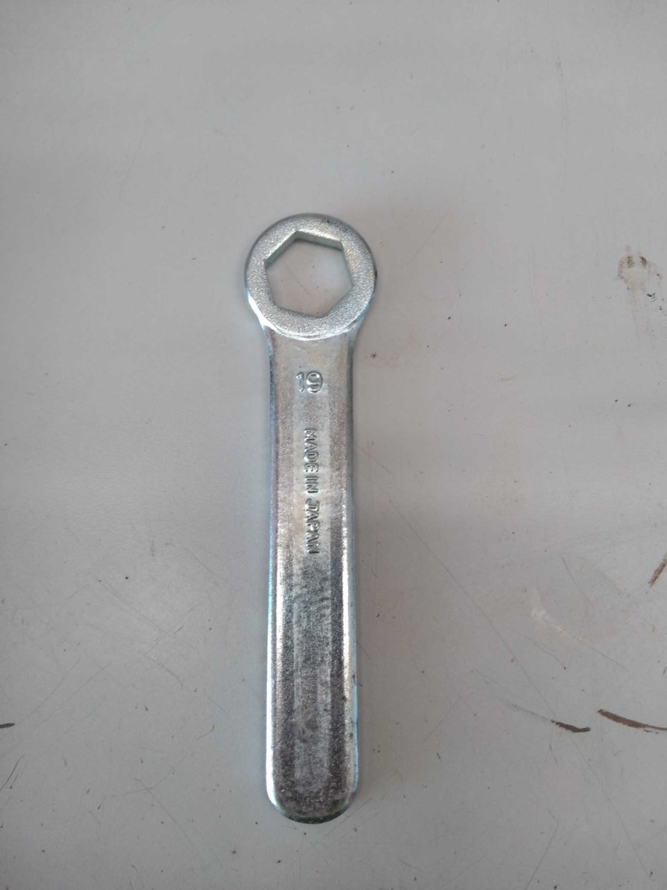

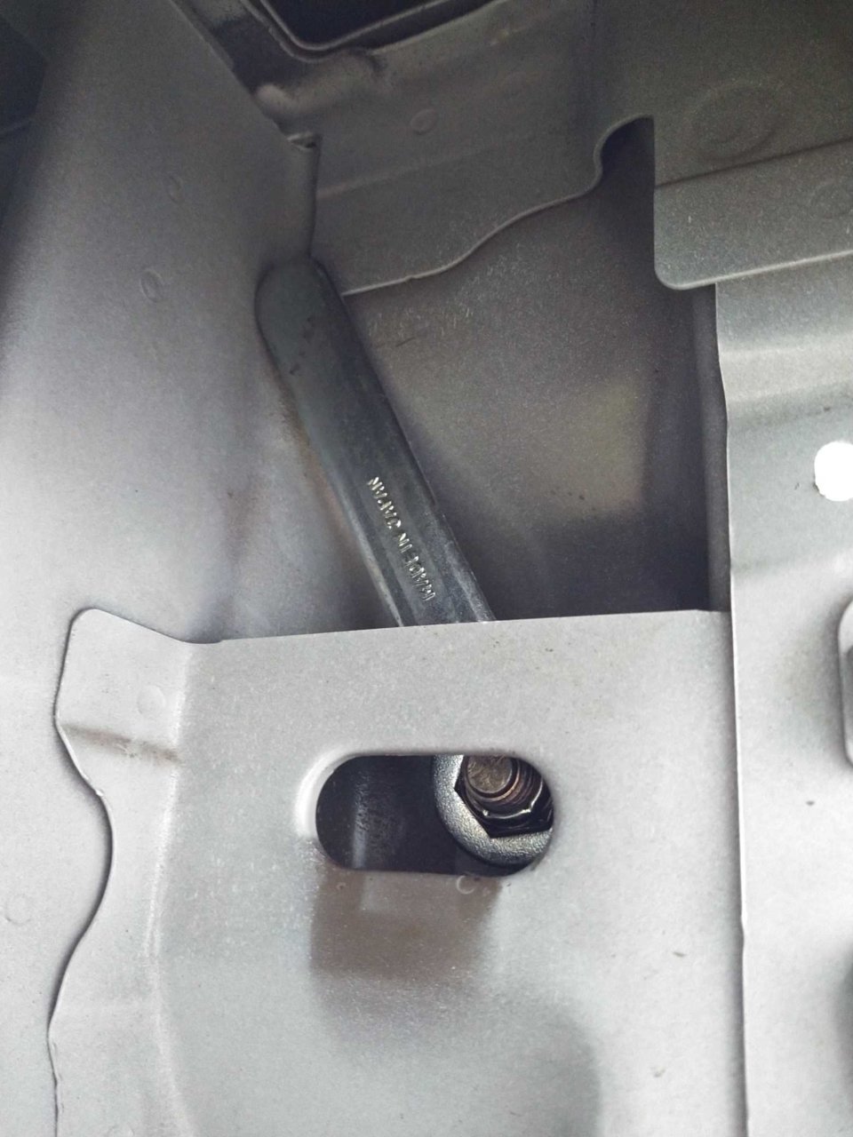

    I am picking up my Summit Topper Monday.
    I had procrastinated, and waited months to put in my Rago Stiffeners, until today!
    When attempting to get a wrench or socket on the highest (top) bolt, I was not able to get enough leverage with my usual Craftsman boxed end wrench(when coming in from the side).
    I was scratching my head and thinking of other methods to hold the 19mm nut still, while I used the socket/ratchet from inside the truck bed, to get it tight.
    I ride a couple of motorcycles. So I pulled out the unused factory tool kit(Suzuki Vstrom 650), and sure enough, there was a short 19mm wrench, that is perfect.
    I think Rago should see about getting these available for a couple of bucks, when folks order these.
    Worked like a charm.
    I also have the group 31 battery cage from Rago. I really like their quality, and the wonderful you tube video for instructions. Very happy customer.
    R65
    Here is the wrench and also as it was used in my Tundra today.
