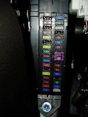

  6. Apr 26, 2020 at 7:14 AM
    spdrcer26
    spdrcer26 New Member
    Aug 20, 2017
    #9166
    61
    Bakersfield, CA
    2017 Crewmax
    I blew a fuse when installing my front camera on my radio and couldn’t figure out where the fuse was under the hood then I realized there was another fuse panel under your left knee. Here it is for reference.
    2a_TX_Tundra likes this.
  7. Apr 26, 2020 at 11:59 AM
    2a_TX_Tundra
    2a_TX_Tundra New Member
    Dec 7, 2019
    #39649
    86
    2020 SR5 CM TSS in Quicksand
    Yea I checked that one, it's good, mine a 2020, I even pulled the stereo and have one 12v constant wire and 2 switched ACC power wires coming into the radio. I have no clue what wires are supposed to do what because I can't find the pinout for the 2020 stereo.
