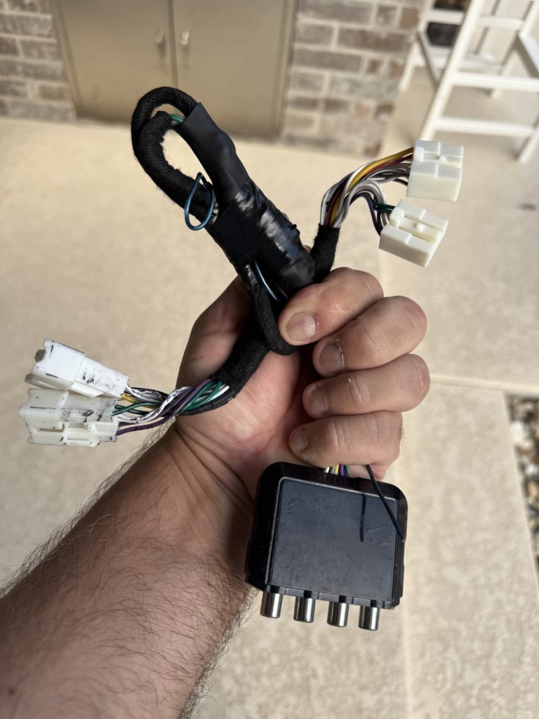

    This is a JRT line out converter to add a subwoofer to a Tacoma. I am looking for someone that can either sell or make one for the 2025 non JBL Tundra

    I added a Sub and amp without a LOC. I bought a few of these and spliced them up.
    https://www.amazon.com/dp/B09DTY8PMD
    I only used the 10-pin for speaker line out and didn't mess with the other out since I ran power direct from the battery.
    T* Tunes also sells a long t-harness you could use with a LOC, but they use a larger AudioControl units. I've also seen some smaller LOCs like this from various companies.
    Unless you have an AMP/Sub that won't take a high level input, the signal from my '24 Limited head unit worked well direct. I used a Kicker Key200.4 amp/DSP and the Kicker 51HS10 just barely fits behind the back seat.
