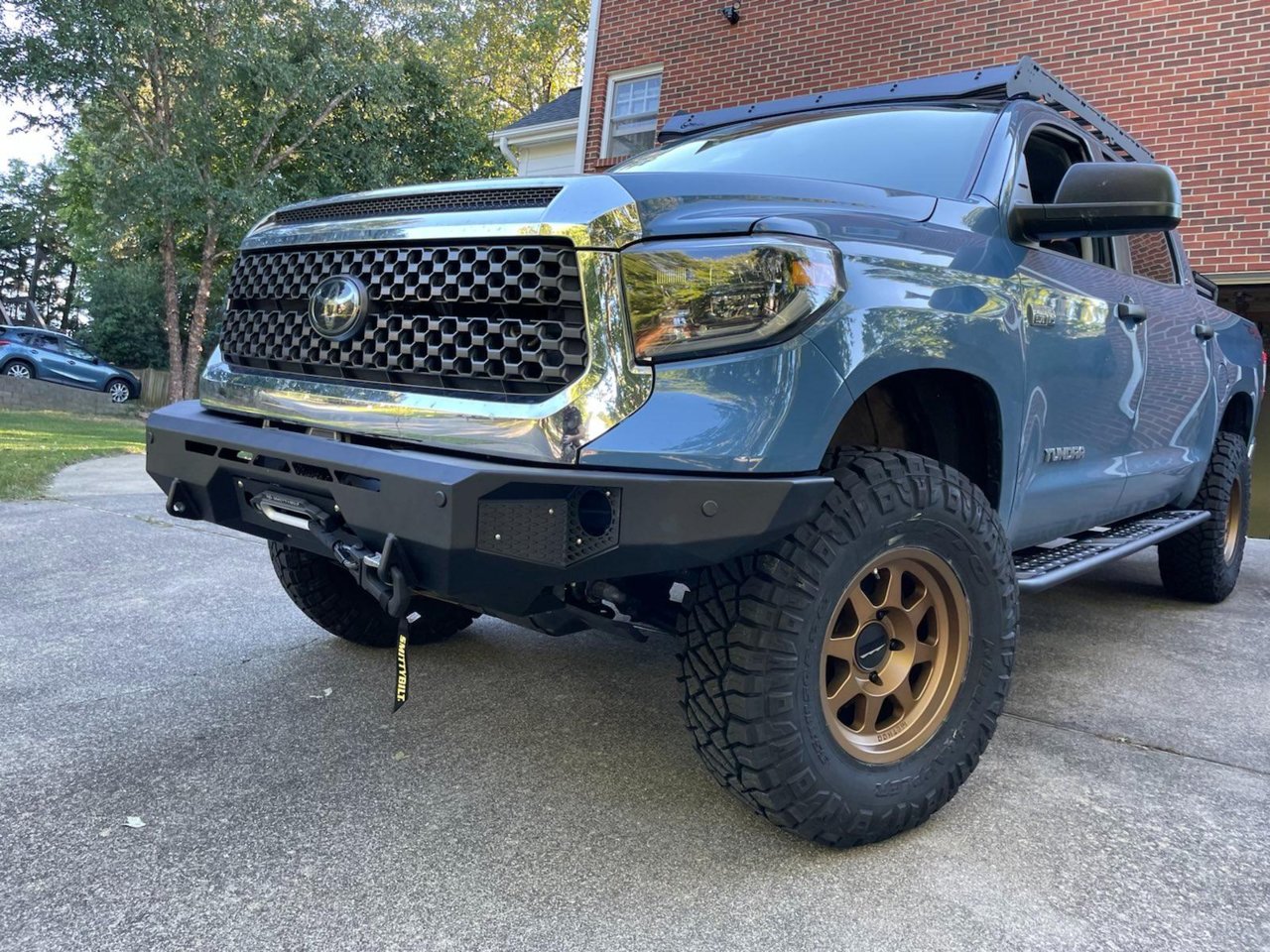

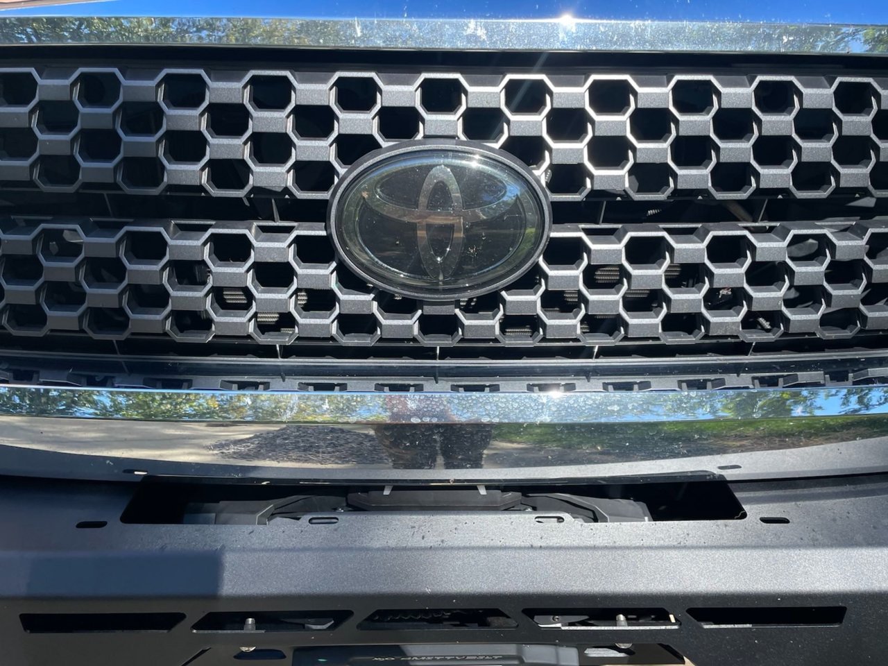

    The vast majority of lighting you see added to aftermarket bumpers block the radar sensor:
    I have a 2019 Sr5 with a cbi classic front bar. I want to add spotlights without blocking the radar sensor. CBI told me to look around on forums for the answer, and I came up short.
    Here you can see in the second pic the cutouts for spot lights, and where they overlap with the sensor.
    -Does anybody have input on what lights they got to clear the radar sensor and leave it functional?

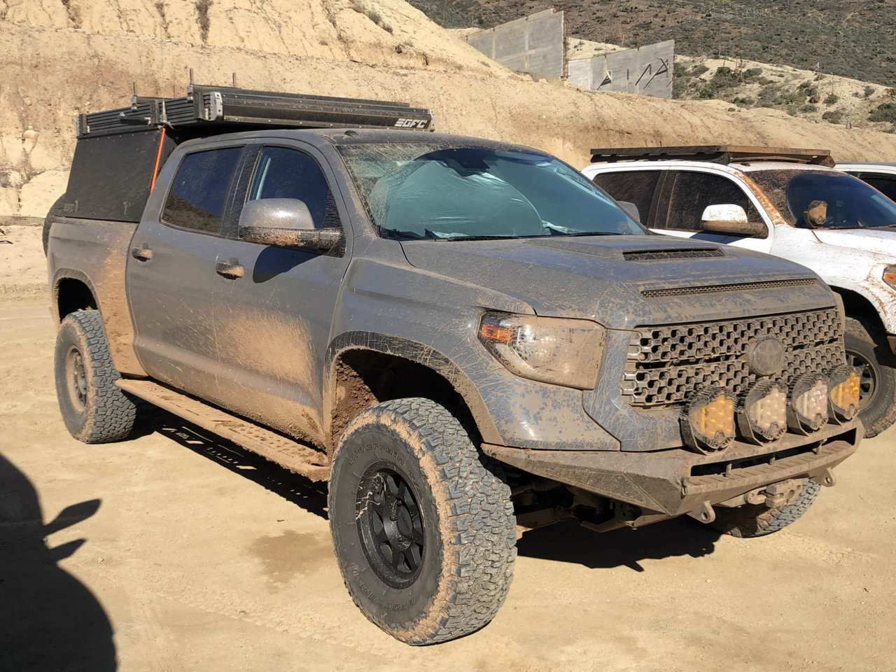

    Examples from online of the lights blocking the sensor (CBI Classic):
    CBI BAJA
    Baja Designs likes this.

    Since you are not running the TRD Pro grille you can get away with pretty much any light you want. The TRD Pro grille pushes the radar sensor lower in the overall grille area which is making that conflict that you have identified. You could run something as large as a Baja Designs LP9 and still be OK.

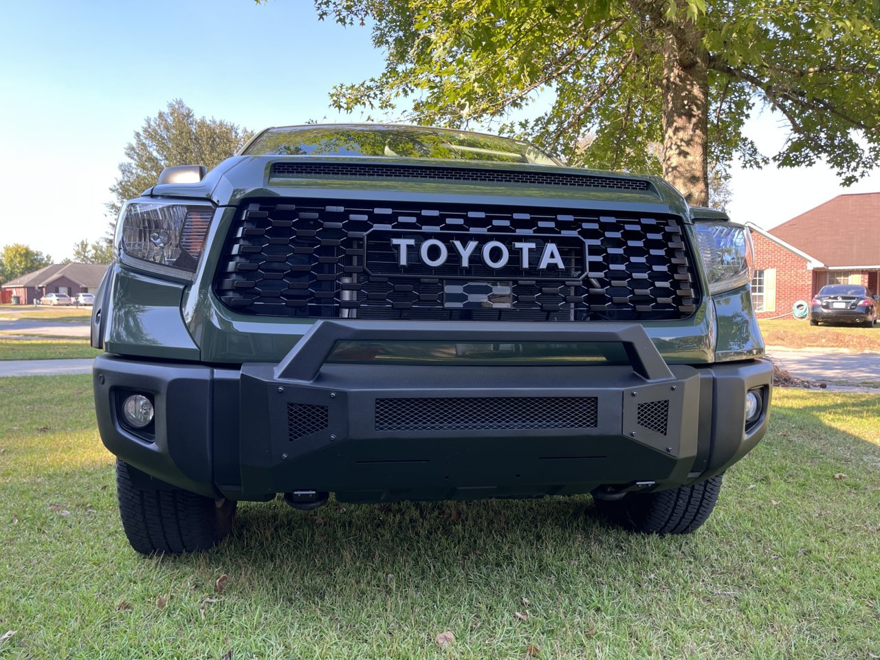

    I added the HD Barricade Stubby Bumber center piece...Can add the light bar in the upper opening and it sits below the radar sensor as I have the Pro grill...May not be your choice but an option that works!! LOL! IMG_5049.jpg

    Hey threlfall, like memario1214 mentioned you will be fine running upwards of our LP9 series lighting without interfering with the radar sensors with that bumper. Feel free to reach out to me directly at brandonk@bajadesigns.com if you have any questions about our lights or would like me to get some on order for you. I'll throw in some links to the options we have below.
