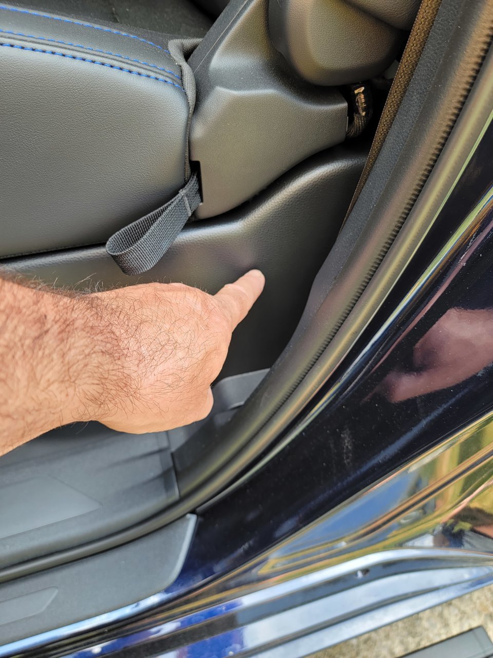

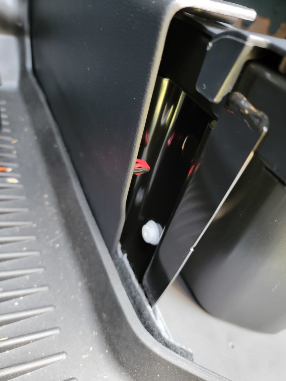

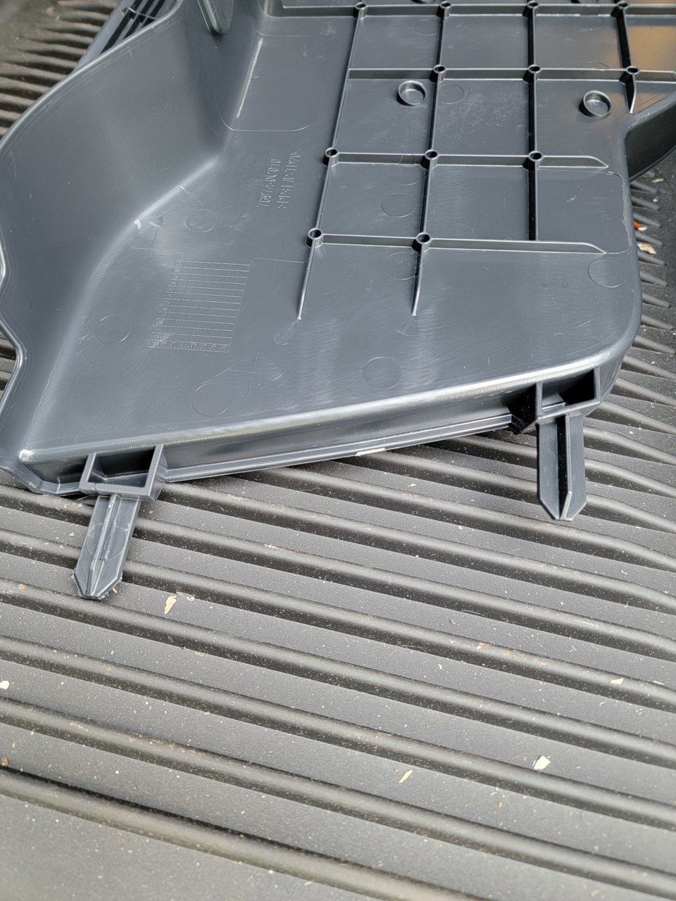

    I found a little electrical tape made this annoying rattle go away on both sides.
    See the picswith just the slightest toutch (tap tap tap)!
    Keep wrapping the two pointy thingys a layer at a time till the panel will still slid in but not rattle.
    2 min fix and hope this helps others since this cabin is soooo quiet.
