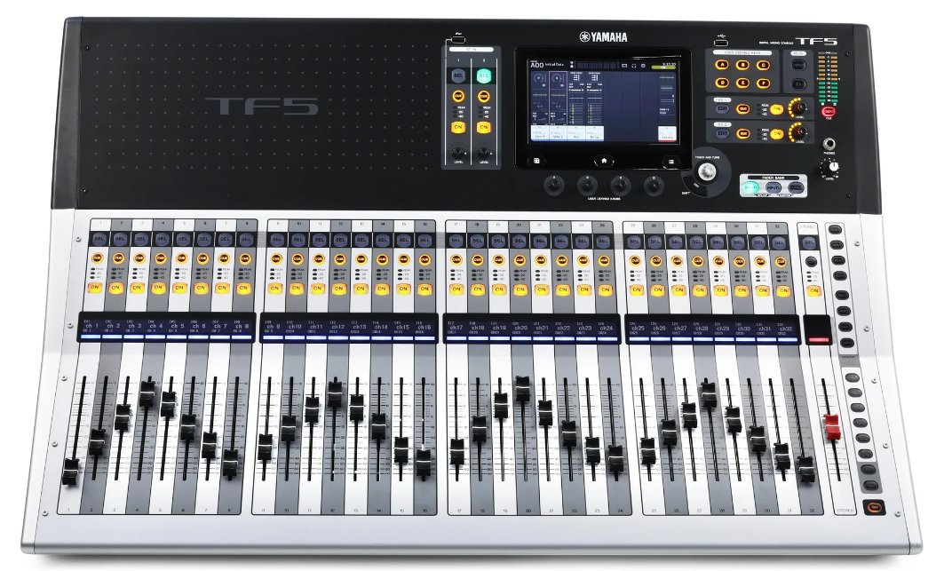

    I posted this in another thread but even though I am a network / systems admin by trade car audio intimidates me a bit because of lack of knowledge. I am still in the research mode as to what components I want. I am used to getting thrown into projects, and just for fun below is a picture of a sound mixer I was asked to setup at work and I had a huge learning curve there. That thing will still do more than I am capable of getting out of it without an audio engineers degree.
