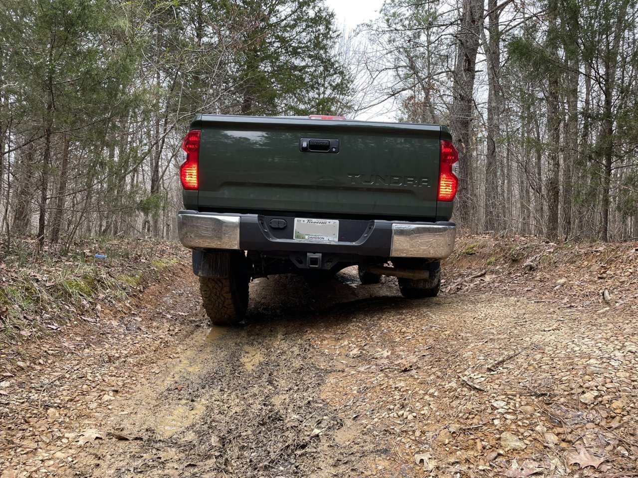

    The rear sway bar adds on-road handling and cornering at the expense of desired suspension travel when offroad. People who like seem to love it. I don't mind the way my truck handles on pavement with LT tires and no rear sway bar. And I much prefer the off-road performance without it. Depends on how much you venture off pavement, I suppose.
    This isn't quite fully stuffed, and I don't think it's close to possible with a rear sway bar:
