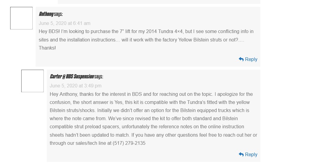

    My truck does have the yellow Bilstein struts up front. I am a little unsure if they will work with the BDS system. It sounds like they are compatible but there was no option for anything when I ordered from the package from Custom Offsets. I should probably call the sales /tech line but I know they are closed right now. Will it work off the shelf?
