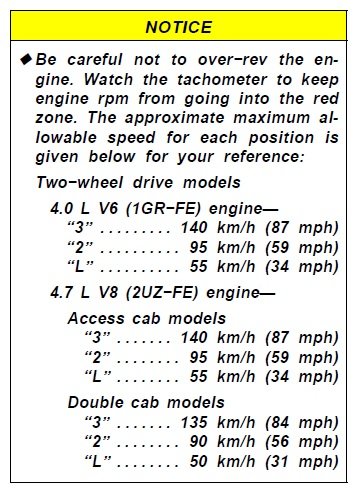

    Get my dummy question out of the way but were you in Neutral with brake peddle pressed when attempting to go into 4LO ?
    Otherwise you may wish to check that out someday because you should be able to go into 4LO from 4HI while in Shift L(1st Gear)
    From 06 Owners Manual....
    Whether it's for engine braking or help in up hill use, keep an eye on them RPM's and more importantly trans temps.

    Worth mentioning it, but this exact info is in the Owner's Manual.
    @Bought2Pull, I'm pretty sure I've mentioned it's worth taking a second to RTFM on other issues :rofl:

    Oh gosh, I am not sure. I was stopped with brake on, that much I am sure of. Hmm....
    Guys I seldom hit 60 in the Tundra, pulling or not. 55 mph is about my top speed.
    I don't have a tranny temperature gauge. What does it look like?
