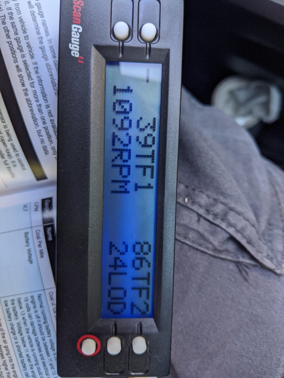

    I dont know how much that relates to changing your fluid. But it is a good way to monitor it's temps among other things

    He's probably referring to using the ScanGauge temperature reading to set the fluid level after changing.
    The first time I used the ScanGauge for that purpose @xx8xx , I would actually double-check the fluid level setting temp with the OBD jumpering method. Since the 5.7L setting temperature range is 99-111 degrees, the fluid temperature might blow through that range this time of year before it even registers on the ScanGauge.

    The ScanGauge is the simplest and easiest to use code reader that gives you transmission temperature. You plug it into the OBD port, and the corded head gives you transmission temperature (still may require some programming).
    There are many code readers, and there are several threads here on how to set up your phone or pad with an app to read transmission temperature and other engine parameters provided by OBD using Blue Tooth or WiFi. The most complicated of these is OBD Fusion or Torque Pro. Do a search if you want to wade in deeper.
