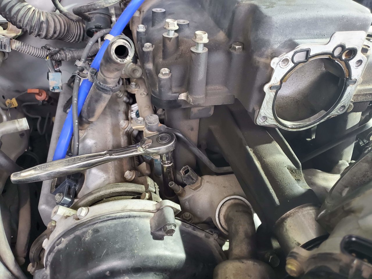

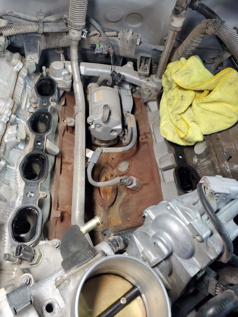

    The engine is stamped with the VIN (last 6 or 7 digits of VIN) of the vehicle it came from...some can see it under your intake throttle body, if you cant see it you will have to take the intake manifold off.
    On this pix it is to the right of the socket/rachet
    In this picture, my throttle body is laying on top of where the VIN is
    Sorry dont have a pix of the VIN itself

    Yes, starter, rebuilt supercharger, injector oring etc
