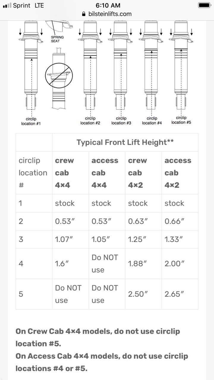

  22. Jun 26, 2021 at 6:39 AM
    Dannydirtyfingers
    Dannydirtyfingers [OP] New Member
    Feb 21, 2021
    #59408
    71
    Texas RR
    2004 Tundra AC SR5 2wd
    5100 Bilsteins 4th notch, JBA uppers

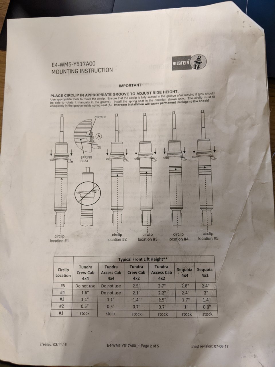

  23. Jun 26, 2021 at 6:51 AM
    Dannydirtyfingers
    Feb 21, 2021
    #59408
    71
    Texas RR
    here's the manual that came with my shocks, pretty much the same, but different numbers... bottom says the revision is 7/6/17.
    onesojourner thanks for that thread link, ill post there as well once I get some time to mess with the truck.
  24. Jun 26, 2021 at 7:26 AM
    #24
    KNABORES
    KNABORES Sarcasm incoming
    Jan 1, 2020
    #40572
    13,962
    Arkansas
    My second set came with the same instructions and the washers for the front bumpstops. I ignored the "do not use" advice for the 4th clip. I needed the 2" to level the truck out. 4th clip gave me that. Truck hasn't exploded yet.

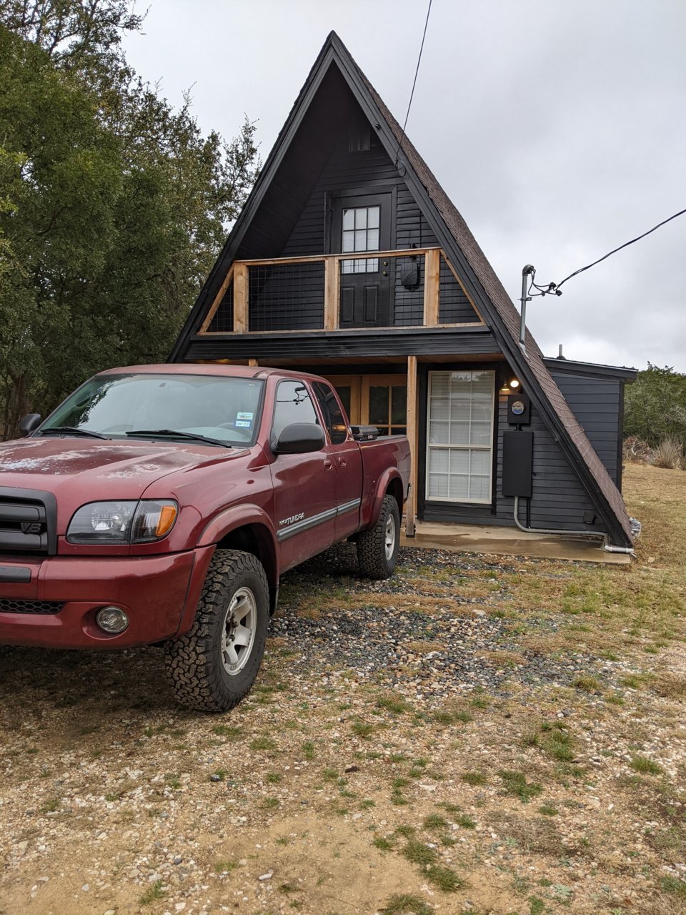

  28. Mar 15, 2022 at 1:02 PM
    #28
    Dannydirtyfingers
    Feb 21, 2021
    #59408
    71
    Texas RR
    Just a current picture
