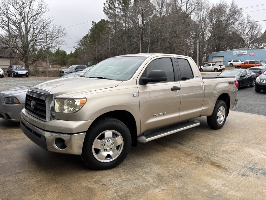

    Hello I just got Mr tundra Saturday. So far doing great. But I have noticed when I first start it up there is a wine noice in the dash. It lasts about 3 or 3 mins. Any idea what it maybe and how to fix? Thanks Kevin

    The noise is definitely in the dash and not on the other side of the firewall? The secondary air injection system will run for a minute or so when the truck is cold. What else is by the dash...... noise coming in through the speakers? Heater/AC blower motor near the right passenger footwell?
