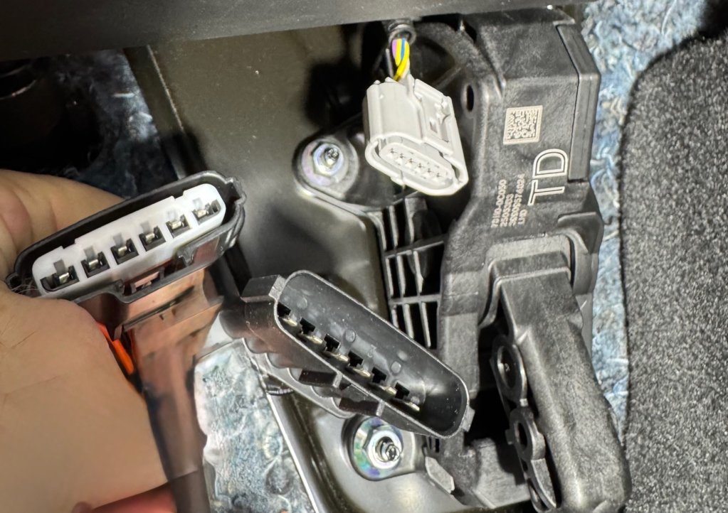

    Well, I received it the other day and immediately went to installing everything. The iDash Pro install went pretty smooth using the stealth mount and then I moved on to the actual Pedal Monster installation but when I went to plug it in --- I couldn't because the pedal monster throttle pedal plugs are different than the throttle pedal plug on my Tundra. Hmmm, I though the 24' version worked on the 25'?

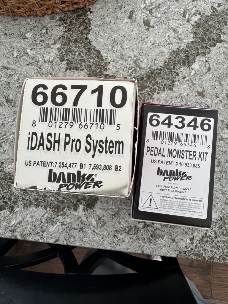

    Looking at the part #'s that I received...I received Pedal Monster Part #: 64346 ---> And I don't think this is the right version for the 24' Tundra? And if it's not the right part # for the 24' that is why it's not going to work in my 25' as well. Can anyone confirm this for me?
    I called Banks yesterday and they setup a return for me - as they insisted that they do not make a pedal monster for the 25' Tundra. I'd rather not return and just get the correct version swapped.
    And to confuse things even further, the Banks RMA for me shows that I am returning Part #64342-P
    And when I google that it leads me to believe this is the part # version that I should have received int he 1st place and that this part # will work on the 24/25 Tundra.

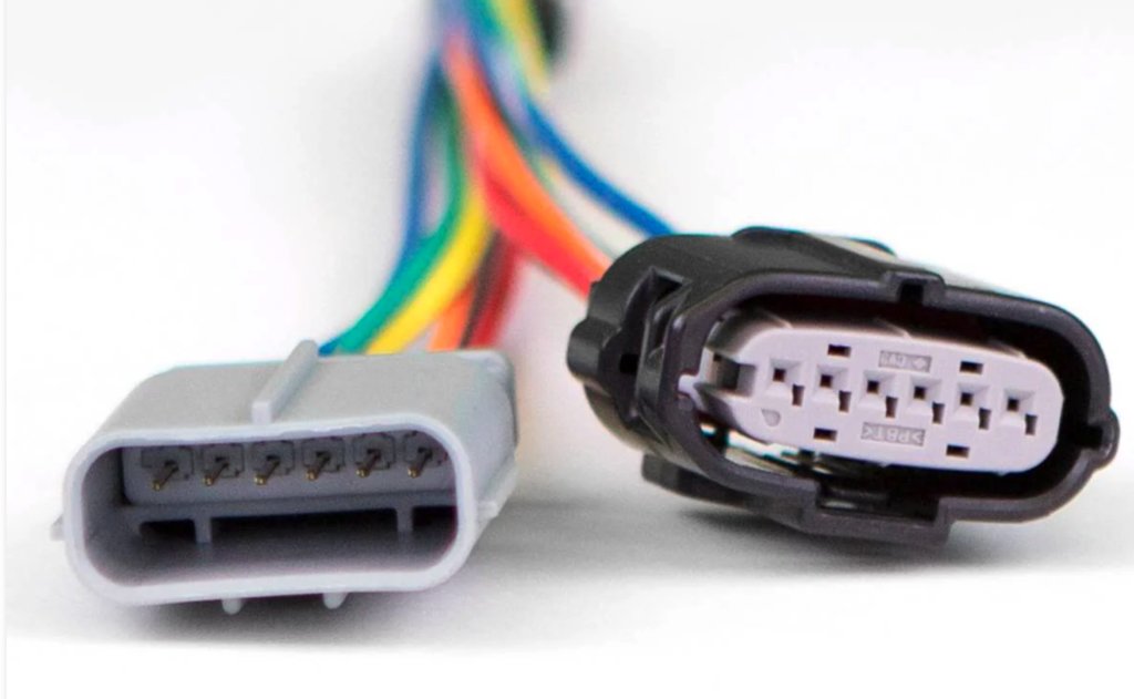

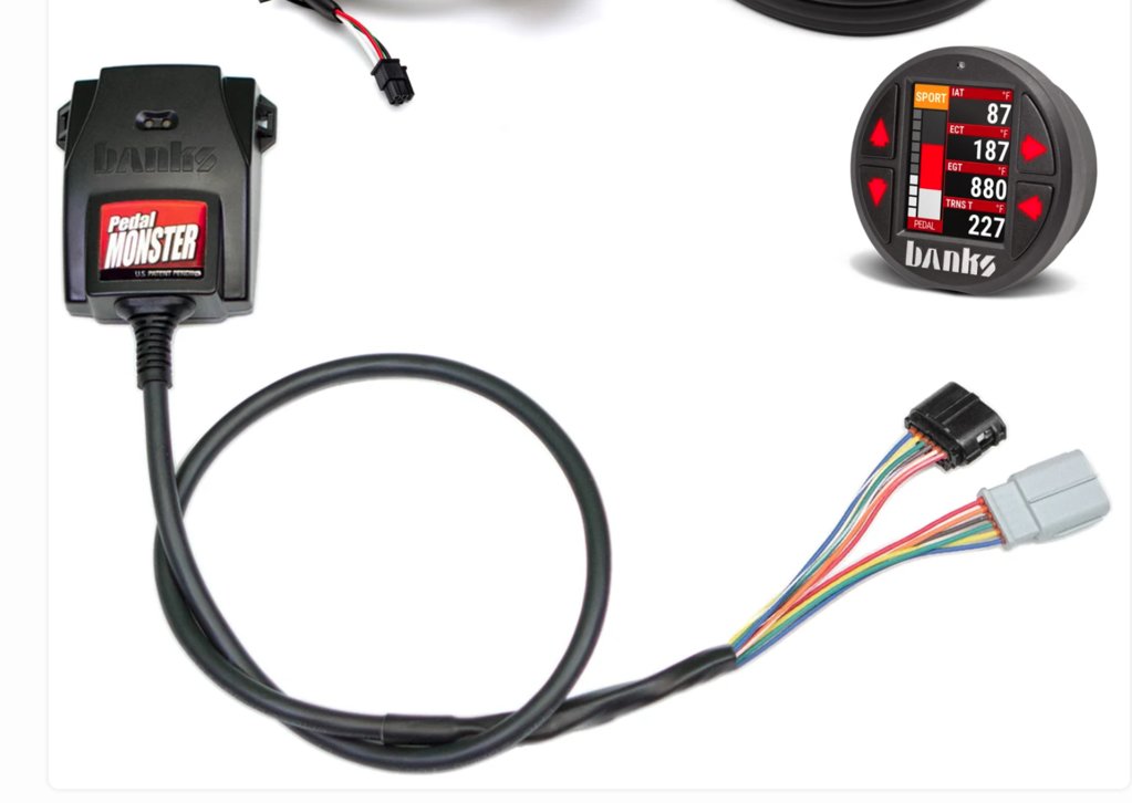

    I believe my Pedal Monster plugs should look like this (not how they look in my last picture above):
  3. Jul 4, 2025 at 11:31 AM
    sudobash
    sudobash New Member
    Jun 13, 2024
    #118355
    876
    64340 is the the one for the Tundra.
