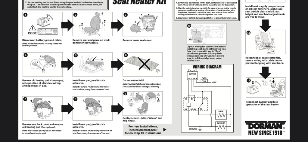

    I bought these Dorman universal seat heaters about 2 or 3 years ago.
    https://www.jegs.com/i/Dorman-Produ...X2aVQ-1n4NdpjP9AHgpS2EqAOGOHGs72hL2KguY3fi_dT

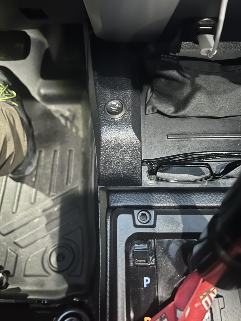

    Had some time today and decide to install them. I have Clazzio covers over my factory cloth seats. I installed these directly onto my cloth seats and reinstalled the clazzios.

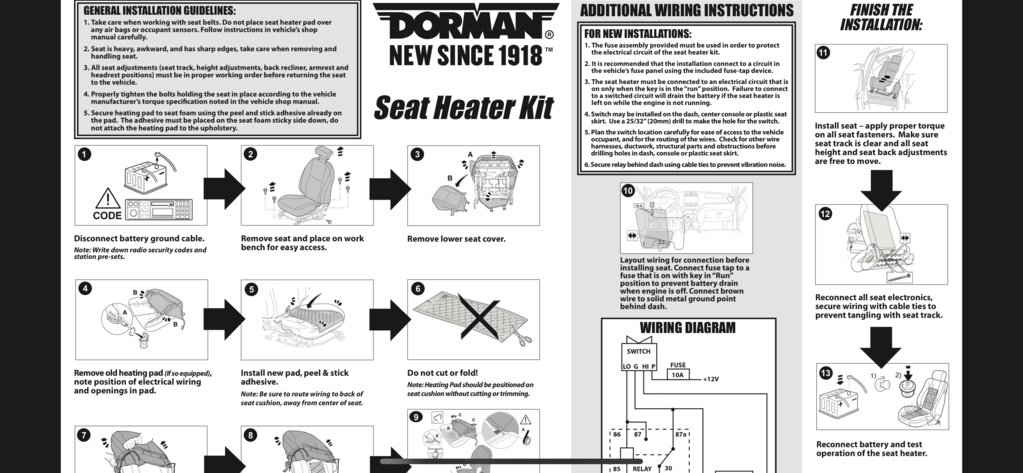

    My question is regarding the wiring harness…..do I have to wire these directly to the battery? It has a fuse tap so I am wondering if I need to to both. Or. An I just tap into an accessory wire somewhere in the truck? The instructions are below. I am not an electrical whiz so please forgive my ignorance……

    ok thanks - so simply tap into the red wire of the usb with the red wire of the seat heater and ground the brown wire to chassis?

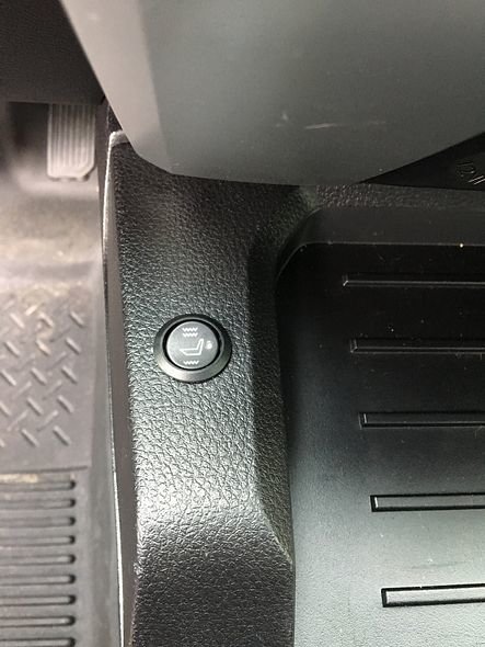

    Correct. Though I used a ground somewhere near the shifter to the left. I also mounted my switches up towards the front of the console near the upper most cup holder.

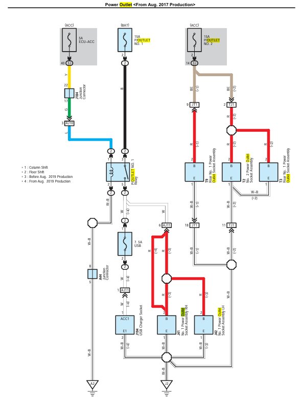

    Same here, I tapped into the 12volt plug in the console.
    They are all on the same circuit, but front and rear powered by separate 15A fuses..
    Except the USB has it's own 7.5 amp fuse.
    I also put the switches forward on the console.

    @Glockman2018 and @1lowlife , am I understanding correctly that you clipped the red power wire on the seat heater harness and tied directly to the 12 v outlet red wire? Obviously have to ground them as well but am I understanding the power part correctly? No need for the fuse tap????? I assume that’s correct since there will still be an inline fuse and relay

    Correct. I didn't use a fuse tap. Red wire to red 12v wire and I grounded it to a bolt underneath shifter area. Inline fuse and relay are zip tied to the shifter area. If I have time today I'll take a couple pictures.

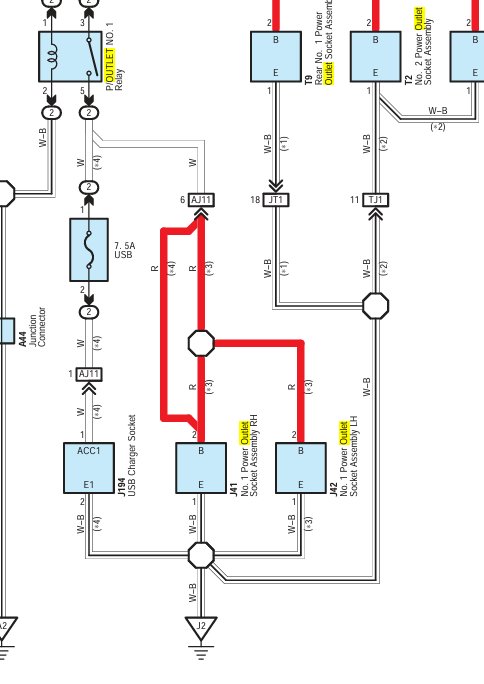

    As you can see in the wiring diagram I posted above, the dash and rear 12volt plugs are on separate fuses on your 2019..
    I tapped into the rear 12volt plugs with a POSITAP (positive and negative) and left the existing fuses that were on the seat heater wiring harness.
    On my 2014 all the plugs are on the same circuit, I don't use them anyway.

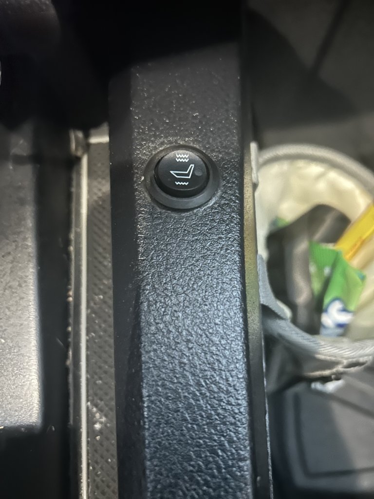

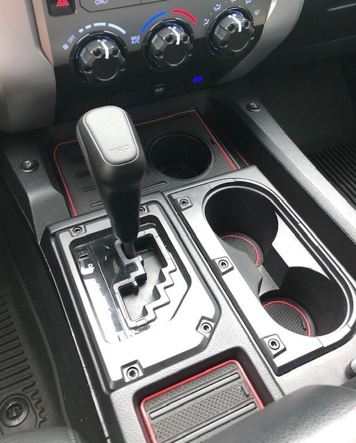

    Forgot that I never updated with pictures….took other members suggestions and installed on the console. They work really well.

    Looks good!

    The wife asked “where did you take that to get done; looks professional….” I immediately side eyed her and walked away before I said something stupid
