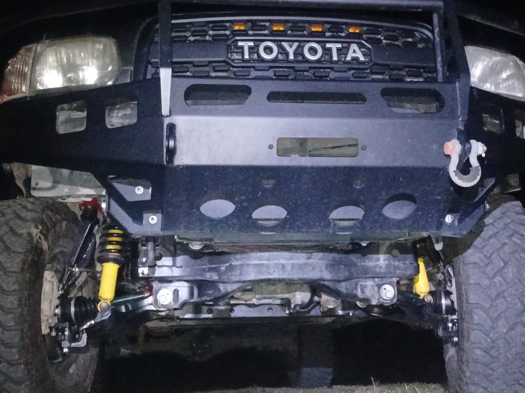

    80544.jpg I have the brute force bumpers with 4 fog light mounts. What do people do with those? Do you mount 4 amber fogs or an amber and a clear? I'm looking to get the baja design fogs but can't find anything about a 4 pack and I'm curious how to get them all 4 wired together into the factory connection so I can turn them on/off with the factory dash switch. Also do I need to put some kind of LED resistor inline with the lights? Or do the Baja Designs require that? I had an old set of LED pods a long time ago and I had to splice in a little chip so that the LEDs would work correctly with the voltage coming out of the truck I'm assuming. It's been a really long time since I've wired up light pods so I'm not sure if the newer higher-end stuff requires the same as the cheap eBay junk I had back in high school did.

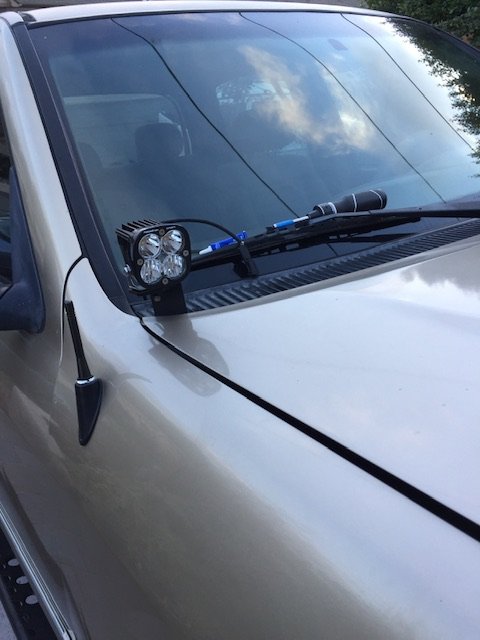

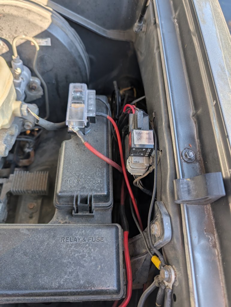

    I have a set a of clear LED pods connected to the factory fog light harness. Then I have a set yellow fogs (actually they have clear lenses that I covered with yellow Lamin-x film) wired to a separate relay and switch on the dash. Neither required additional resistors to function. I typically only switch on the yellow pods when visibility is bad (dust, fog, snow, etc).
    PXL_20241009_134938539.jpg PXL_20241009_134855836.jpg PXL_20241009_135018524.jpg
    Something like this splitter might be all you'd need though to run 4 fogs from the factory switch.

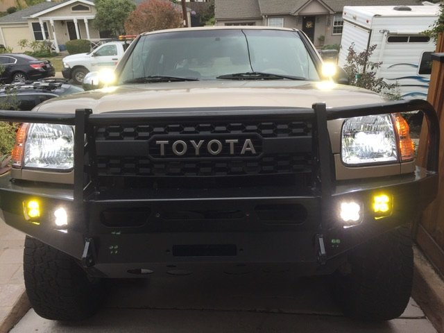

    I’m a big fan of Baja Designs. I run four Squadron Sports in the driving combo on my truck and they have been flawless. I like the idea of running a pair of clears and a pair of ambers on separate switches. Mine are currently on two different switches. For what it’s worth, they are not enough light for my truck currently and I will be upgrading to LP6 or LP9. After caging my truck, it’s now good for pretty much everything in the desert at 55mph, so I need all the light I can get.

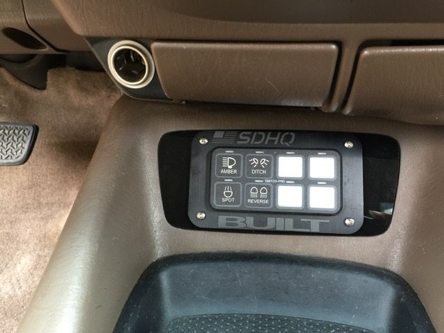

    I have the same set up, I mounted the switchpro in the center console.

    mint. Where'd you run your switch pro through? I've been holding off till I figured out exactly where was the best place to run it through and how many other things I needed to run through So I didn't have to re waterproof any holes I made.

    Through the firewall in an existing factory grommet in the footwell by the pedals and then behind the carpet over to the console. It’s not a very large gage wire for the switches. The wires for the unit in the engine bay are very large.

    Gotcha. I've got all kinds of accessories that I've held off on running through the firewall. I planning to have a 60/40 bench seat reupholstered in leather to match my captains bucket seat and only install the 60 but it'll get rid of my center console so I'm going to either have to fabricate something for the center or cut the existing one down and fiberglass the cut off portion and pain it or something to still give me something to have there. I've been trying to find a mount I saw someone have to put their auxbeam in the above sunglass holder. But a switch pro would be about the same. Got my teq grill in tonight though....baby steps.20241016_205509.jpg

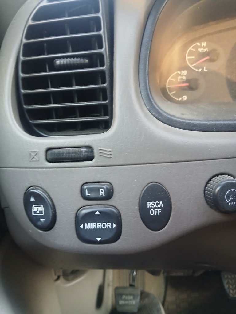

    This is what my truck looks like. My 2000 truck has switches similar to yours but I have a rocker switch for my back window and then it's mirrors and then my rollover side curtain airbag.20241017_182458.jpg
  30. Oct 17, 2024 at 3:59 PM
    #30
    bfunke
    bfunke Tundra Curmudgeon
    Oct 13, 2019
    #37321
    2,396
    South Carolina
    2018 SR-5 CM 5.7, 2000 SR-5 AC 4.7L
    2000 has a fog light switch and a blank in that spot.
