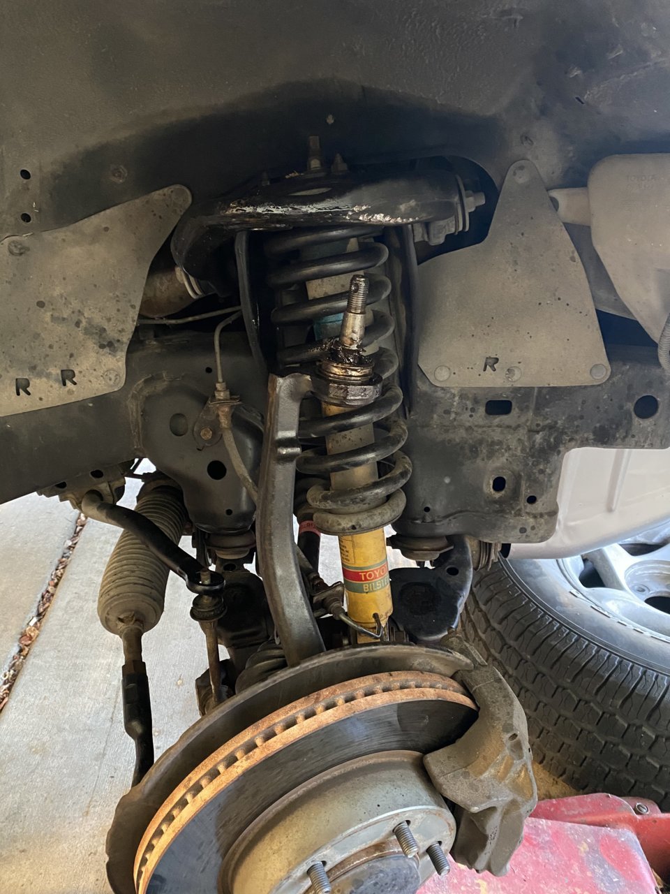

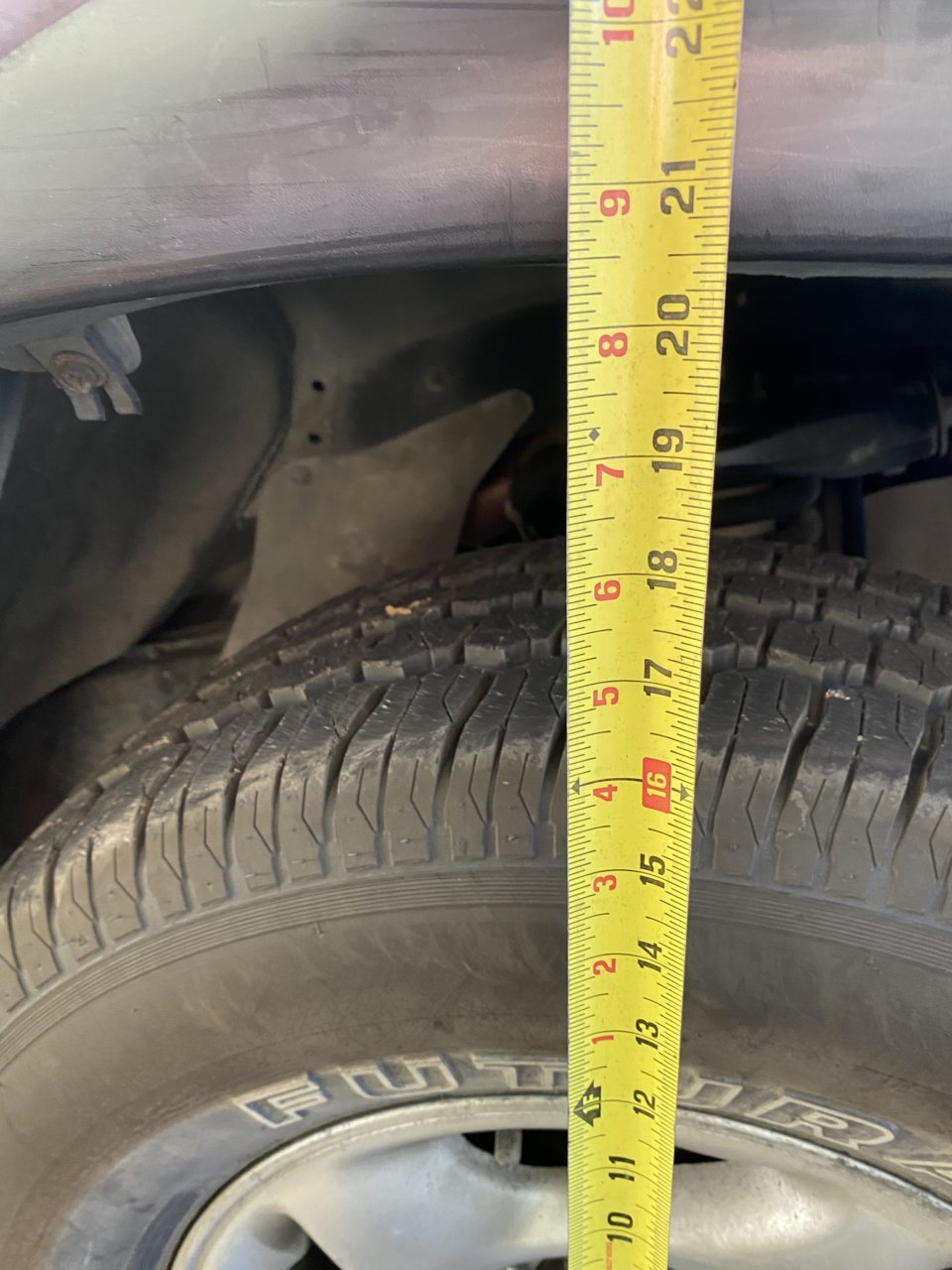

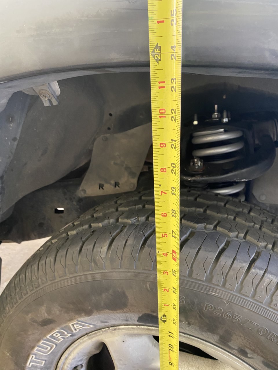

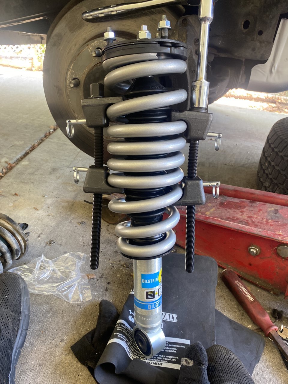

    So today I took off the original strut and coil off my 2000 Tundra 4x4 that had almost 350 k on it. I bought 5100s for the front with Eibach springs. I decided to go to the top setting. It lifted it 3” from where it was. This week I’ll be doing a Front diff drop for the cv axels and boots. I got the passenger side done today and am planning on doing the drivers side during the week. I also replaced the upper ball joint too since the boot was ripped. It was a very productive weekend.

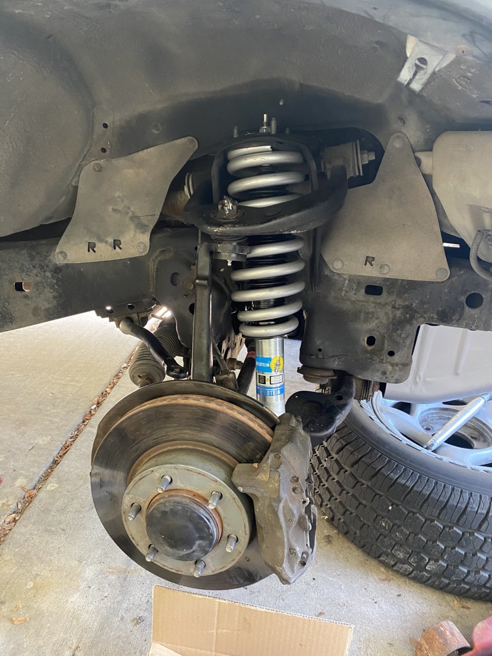

    Those are 2.5" lift coils correct? and you put the lower spring seat at the highest or lowest setting when you say "top setting"?

    Correct. Probably because my suspension was so worn out, I had 348,000 miles on the Strut and coils. At the highest setting The setting that’s not recommended

    How's the ride? the top setting would yield 2.5" of lift with a factory coil, that plus a 2.5" lift coil must have a lot of preload on that setup.

    I would definitely lower the perch. You've got no droop and vicious arm angles if that last pic is with the tires on the ground.

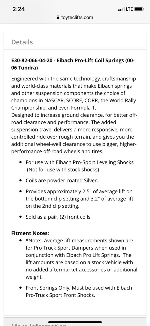

    Second clip from the bottom with those coils should give you 3.2" of lift per Eibach. moving up several perches is likely not adding lift, but increasing preload. And anything over 2-2.5" of lift is putting the upper ball joint at an increased stress angle near its limit. You will have notching of the outer cup that holds the ball joint in due to maxing out the angle. New aftermarket UCA's help with that. Uniball uppers are overkill for daily drivers and more trouble than most would like to deal with, but you do you.

    Like others have stated, please lower your bilsteins to the very bottom or the 2nd clip. Please read this from the toytec site concerning these coil springs.

    Thank you. I didn’t know, I’m gonna try the second notch on the driver side and lower the passenger side. Thank you for input

    Should the spring compressor threaded rod be bending like that??

    I thought it was bending too but it wasn’t it was just the slop in the jaws that hook on the coil it worried me to when I was compressing them. They aren’t bent at all after I took them off so they were not bending.

    I hate those things. I stopped doing coils myself simply because of those things, I never felt the warm & fuzzies when wrenching it. I plan on getting a wall mounted unit in the near future, after I buy a commercial char broiler for my outdoor bar/cooking/hangout station area

    Those should be called spring retainers, as they are not optimally designed to compress the spring. I usually compress/load the spring as best i can with a jack and the weight of the vehicle, then attach the spring clamps. Using them to screw down and compress the spring tends to wear the threads and bend the rods. Almost every pair I've ever seen are bent like that. And as far as the Uniballs, you do you. They are exposed and require more frequent cleaning and lubing. They tend to be noisier than regular ball joints if not properly maintained. They are higher performance with caveats, like many mods for cars and trucks. Not trashing them, just being real.

    Ok, but please put them both on the second notch. If you’re concerned with driver side lean, get a 1/4 inch top plate spacer.

    I’m putting them on the 1st notch to see how they preform this weekend. I appreciate everyone’s comments giving me a crash course on this
