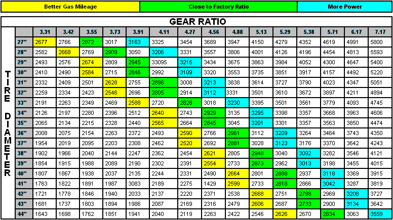

    You can definitely re-gear your differential(s). Some trucks came stock with 4.10 gears, but 4.56 and 4.88 for instance are readily available aftermarket for the 8.4" Tundra rear end.
    This chart is a good starting point, but your use case is a big factor as well.

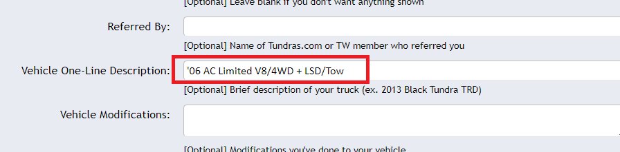

    Do us all a favor so we can have more fruitful conversations and help you out.
    Go into your user profile.
    Find the "Vehicle One-Line Description:" box and add the following info:
    • Year
    • Cab type (DC, AC, RC for double, access, regular)
    • Trim package (Limited/SR5/etc.)
    • Engine (V6/V8)
    • Drivetrain (4WD/2WD, include "MT" if manual, include "LSD" if you've got it)
    This helps us skip the "What..." questions on threads like this, or threads where you need help and don't want to re-write your truck details every time.
