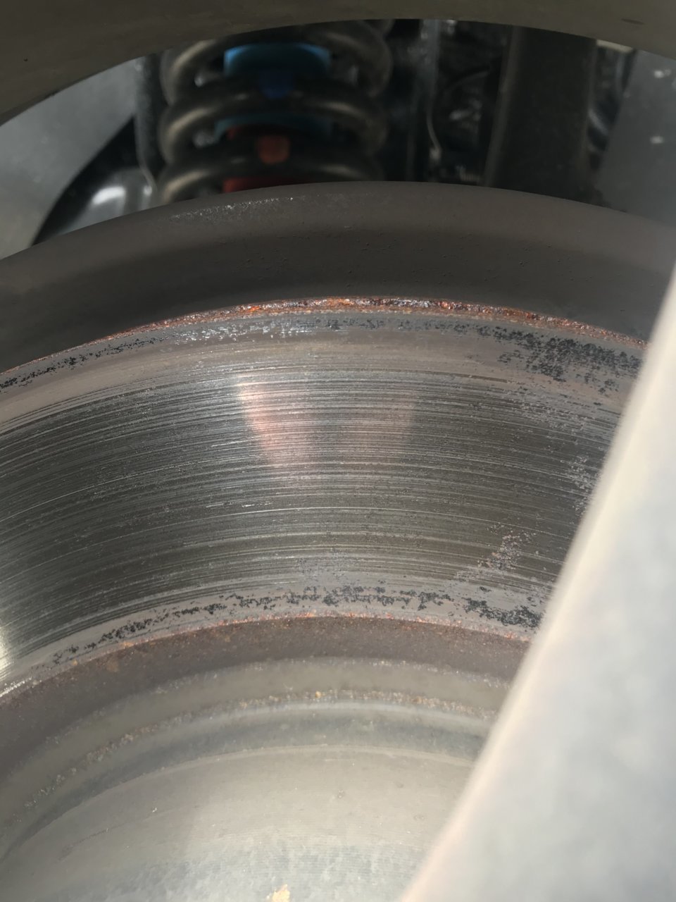

    @Tundra234 they look a little more rough than normal. I’m thinking they need a good heavy braking to clean them off. If not, to the dealer for turning.

    I have 5600 miles on mine , this is what they look like.

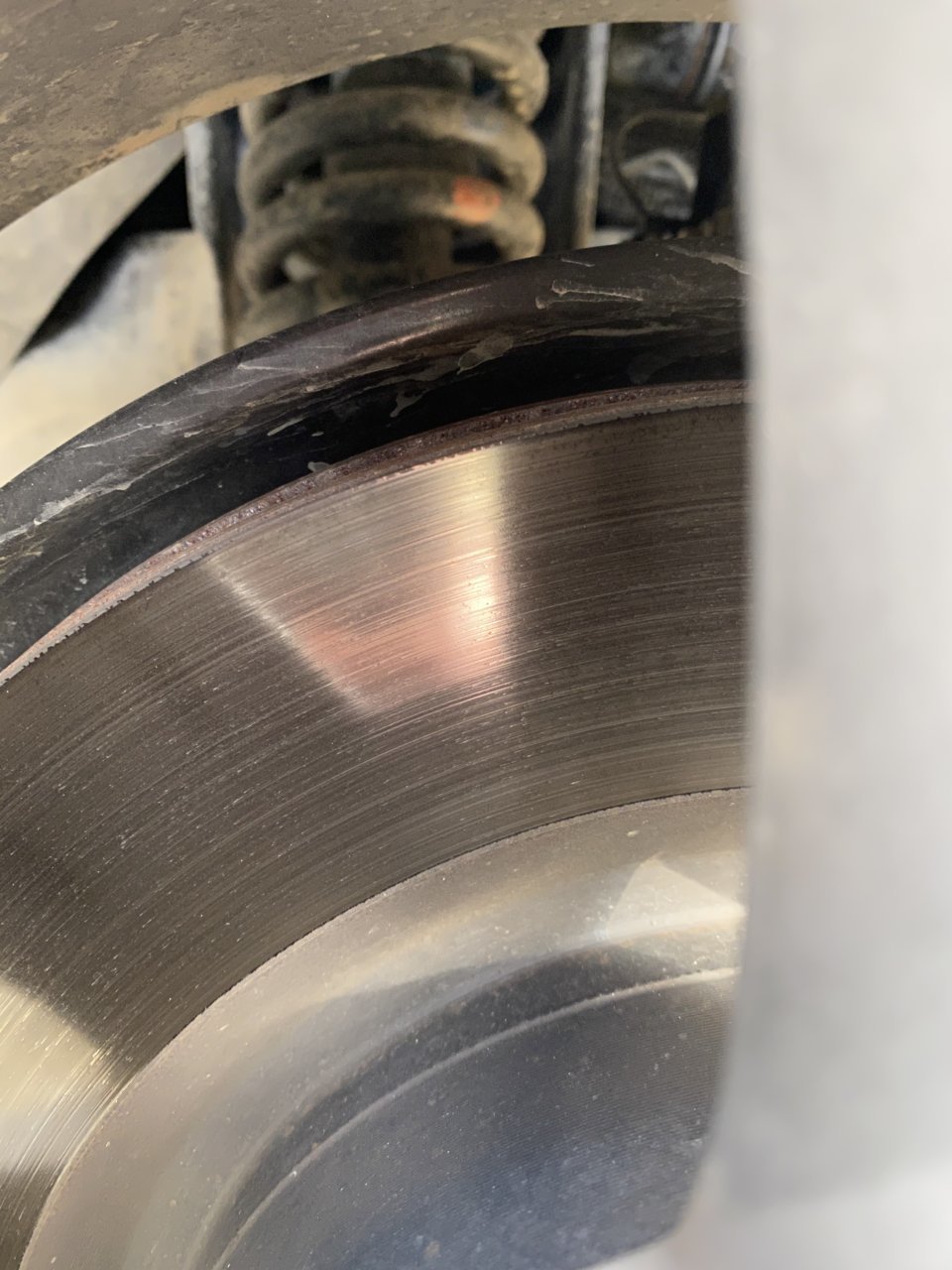

    This is what I was dealing with until I replaced them.
