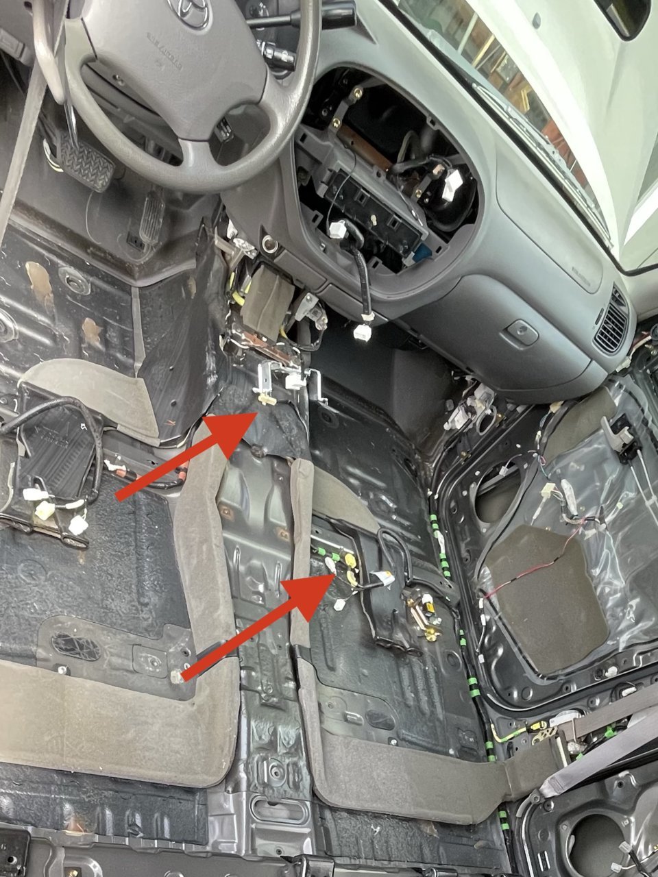

    Working a bunch of things through the truck as I install an amp/sub/speakers and wiring. Pulled the entire interior including all seats, console, almost all trim, carpets, and door panels. No engine/tranny/dash lights issue prior to getting started. Battery was disconnected for 3 or 4 days while I was working on things.
    Laid a bunch of dynamat type sound deadening in the doors and on part of the floor. Swapped all the bulbs in the center console/dash area for climate controls, hazards, 4wd, cargo lamp, etc to LED's. Not very close to finishing so I connected the battery and threw the drivers seat in and drove to work... ABS and check engine light on, speedometer not working, and mileage not registering. Seems to be driving fine.
    Thought it could be related to the passenger seat harness initially.... threw in the passenger seat and plugged in everything (i think) and no progress. I *THINK* I have all of the important stuff plugged back in but I also have nearly no clue what I'm doing... so I'm here!
    It seems unlikely, but these two plugs are not connected and I'm not sure if they should be - I can't find anything in my pile of pieces that would plug in. The passenger side seat harness has three clips plugged in and there is one more plug that is taped to the harness that I do not believe was ever connected (near the bottom right arrow). The upper arrow sits under the little mat area of the center console and I don't think was connected to anything, but I could be wrong. I even tried plugging in all of the 12v plugs just in case.
    Way beyond my depth of my knowledge and I don't know where to start looking but I'm guessing it's one of two things.

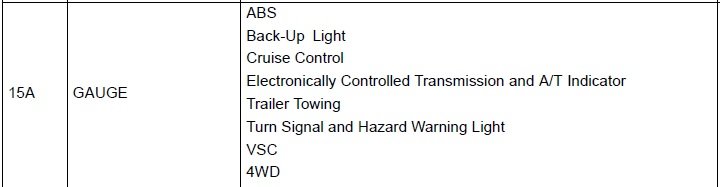

    P0453 is a curve ball but P0500 is plausible if certain items below are found....fuse, connection, etc.
    While not enough info leads me their, I'll ask anyway. At anytime did you work on the Instrument Cluster(Combination Meter) area and if so, I would re-check that all it's connectors are plugged in securely.
    Would suspect 15A Gauge fuse since some items were listed that are affected if blown(ABS, Speed, ODO) but not enough to confirm in case you left out a few items....gear selection indicator, cruise indicator....etc found in pic below.

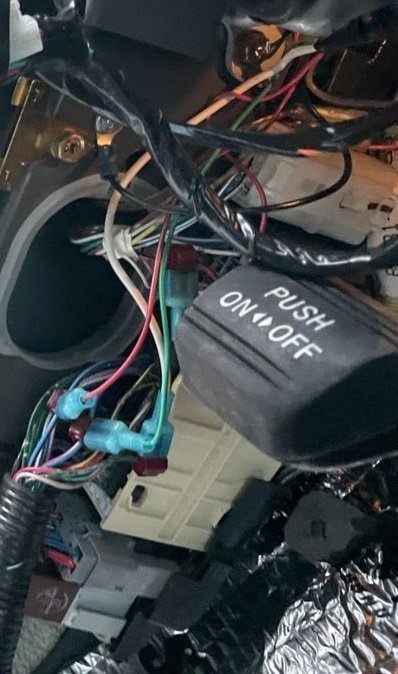

    There is a lot going on in the pic below. Certain items you mentioned come to that junction area, especially ABS input.
    How far up did you place the dynamat ?
    Upper right corner with butt connectors and questionable additions, I would make sure I did not bump something in that area if their was hand action going on while adding dynamat.

    Not only that, but all of those shit-ass T-Tap/Scotchlocks, those things mangle wiring and can cause all kinds of stupidity.

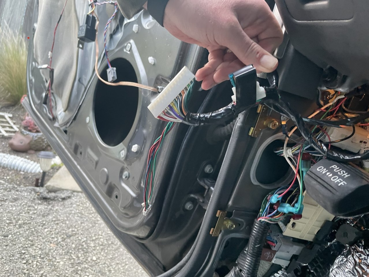

    I also see whoever installed the alarm threw relays on the door locks/windows, as you can see in OP's pic with the door card off, so they got into things pretty deep during install and hacked into multiple systems to support alarm add-on functions. I'd yank that f'er, but that's just me (@OP, I used to work at an audio/alarm/tint shop bitd, I'm pretty harsh about aftermarket alarms)
    But it's all speculation at this point. I think @BubbaW has a better line of sight than me on this one. My eyeball for electrical stuff is more farsighted than his.

    Definitely a possibility at this point. I don't have any info about the alarm but I'll go down in a few and start trying to figure it out. My plan was to get the basics done that I felt comfortable with and take to the truck to someone to tune the amp and pull the alarm before I put the carpet back in.... but apparently even that was too much for me :rofl:My thought process was that I didn't want to touch it at all because I was worried about these issues. Still feels weird that it would be causing these issues considering how much effort I put into not messing with that area, but you guys definitely know more about this stuff than I do.
    Got enough from that thread that I wasn't comfortable removing it on my own. The hope was to have it removed by someone with knowledge/experience and tune the amp after I did some of the basic labor of laying dynamat and running speak wire.... I felt comfortable with the concept but doesn't look like that is working out at this point.
