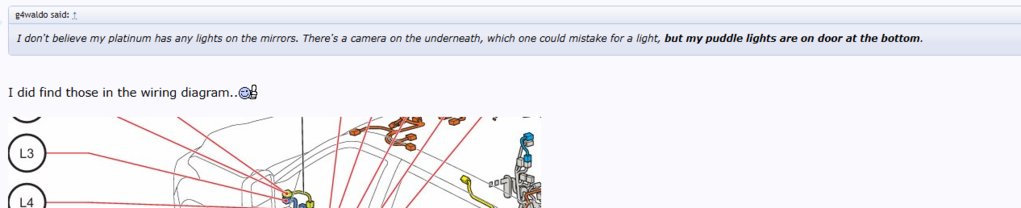

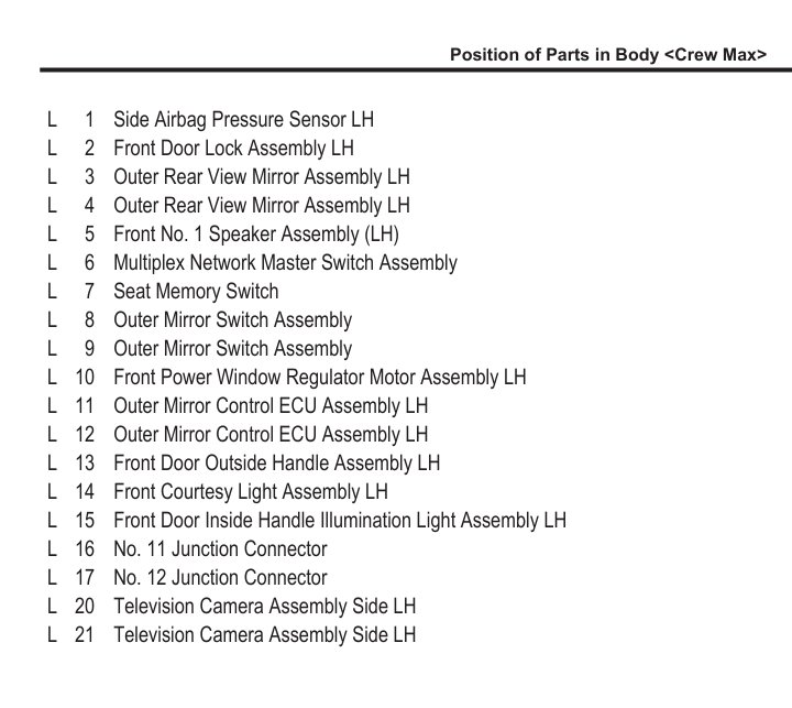

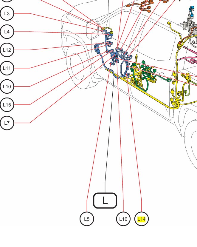

    I asked because I didn't see anything in the wiring diagrams for mirror puddle lights..:confused:

    I did find those in the wiring diagram..:thumbsup:

    Seems this wiring could be for the courtesy light in the door ... not necessarily for a light in the mirror.

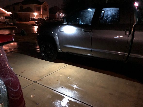

    I added the diode dynamic bed light kit, and mounted them as puddle lights. Easy fix.

    Using the bed light kit from diode, they plug and play into the oem bed light. Since they are, they act just like the bed lights/cab light. Turn on when opening doors/tailgate, or when unlocked.
