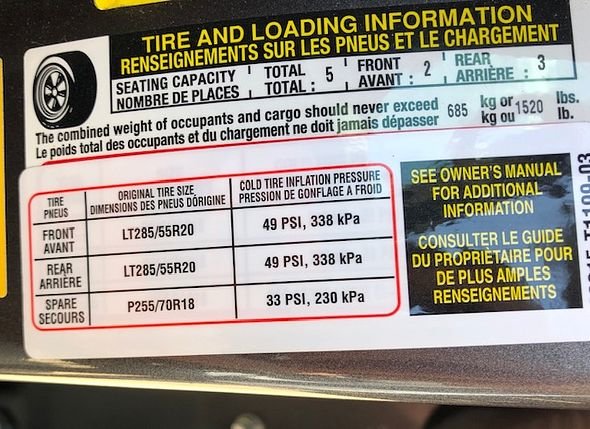

    I had 285/55/20 KOs on my 2014 when new.
    The sticker reads 49 PSI, I ran 42.

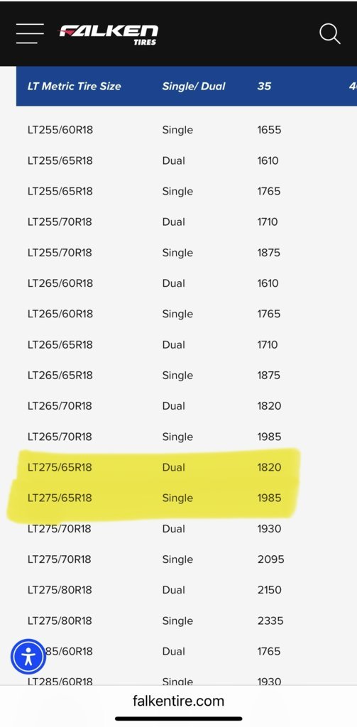

    So here is what the Falken site says for PSI and my tire.
    kinda odd, maybe I need to air down then?
  15. Jun 15, 2025 at 10:45 PM
    Tundrav82019
    Tundrav82019 [OP] New Member
    Jan 5, 2025
    #128442
    297
    Leo
    2019 Tundra Limited TRD Off Road
    Someone check me on this, could be wrong here

    Unfortunately, that isn't correct. While your maths are fine, you made some incorrect assumptions about the linearity of air pressure in a tire vs load handling. You also made some incorrect assumptions about equal weight distribution fore and aft on the vehicle's axles and tires.
    The 'airspring' of a pneumatic tire has a linear range, but is not linear throughout the entire range of inflation. If I'm not mistaken, Michelin, Toyo, and a few other MFG's have a white paper documenting this. Essentially, you need a minimum inflation pressure to start supporting a load (or rather, to a achieve a load rating), and after that minimum inflation pressure, the tire pressure behaves more or less in a linear fashion. Within that range, the tire achieves acceptable deflection of the carcass, heat retention and shedding, and loading characteristics to be deemed safe by the tire manufacture.
    Review this document from Toyo Tires: https://www.toyotires.com/media/pxcjubjs/application_of_load_inflation_tables_20200723.pdf
    The correct way to determine the inflation pressure for a tire of size or load rating different than that on the vehicle placard (assuming you aren't using a generic tire inflation calculator) is:
    - First, reference the tire size, load rating, and pressure indicated on the vehicle placard. We'll call the two items your Old Tire Size and Old Inflation Pressure
    - Locate the tire size on the inflation table listed above
    - Coordinate the top row of inflation pressures with the tire size and your listed inflation table on the placard, and note the associated load in the table. We'll call this your Old Load. If you're inflation pressure is between two listed pressures, you can use your maths to linearly interpolate the load
    - If you tire is a P rated tire being used on a pickup truck, derate the Old Load by 10%
    - Now find your New Tire Size/Ply rating on the inflation table
    - Scan to the right of that tire size until you see a New Load number that matches your Old Load number. In other words: New Load = Old Load
    - Scan up to the inflation pressure row above the New Load to realize your New Inflation Pressure.
    - As with before, if your New Load is between two pressures listed, use your maths to determine the correct pressure.
    If memory serves, a stock size LT275/65R18 is going to require around 42 or 43 PSI to match your 33 psi rear tire rating.
    But, a note about inflation pressures: OE manufactures spec the minimum pressure to support the maximum axle weight listed on the door jamb in order to achieve the softest ride safely. But those pressures can be manipulated a few pounds either way. @Mad Max for example, runs less pressure in is LT rated tires than is technically required which on an LT caracass rarely causes an issue with tire wear so long as the load on the axle remains close to the unladen weight. He's also able to run less pressure in the rear tires because in an empty pickup truck, you have closer to a 60/40 weight distribution front to back axle.
    I, on the other hand, always run MORE pressure than the bare minimum because I am always hauling stuff in the bed or towing a trailer and prefer my tires to be responsive, and be able to shoulder a heavy load without the need to inflate the tires.
