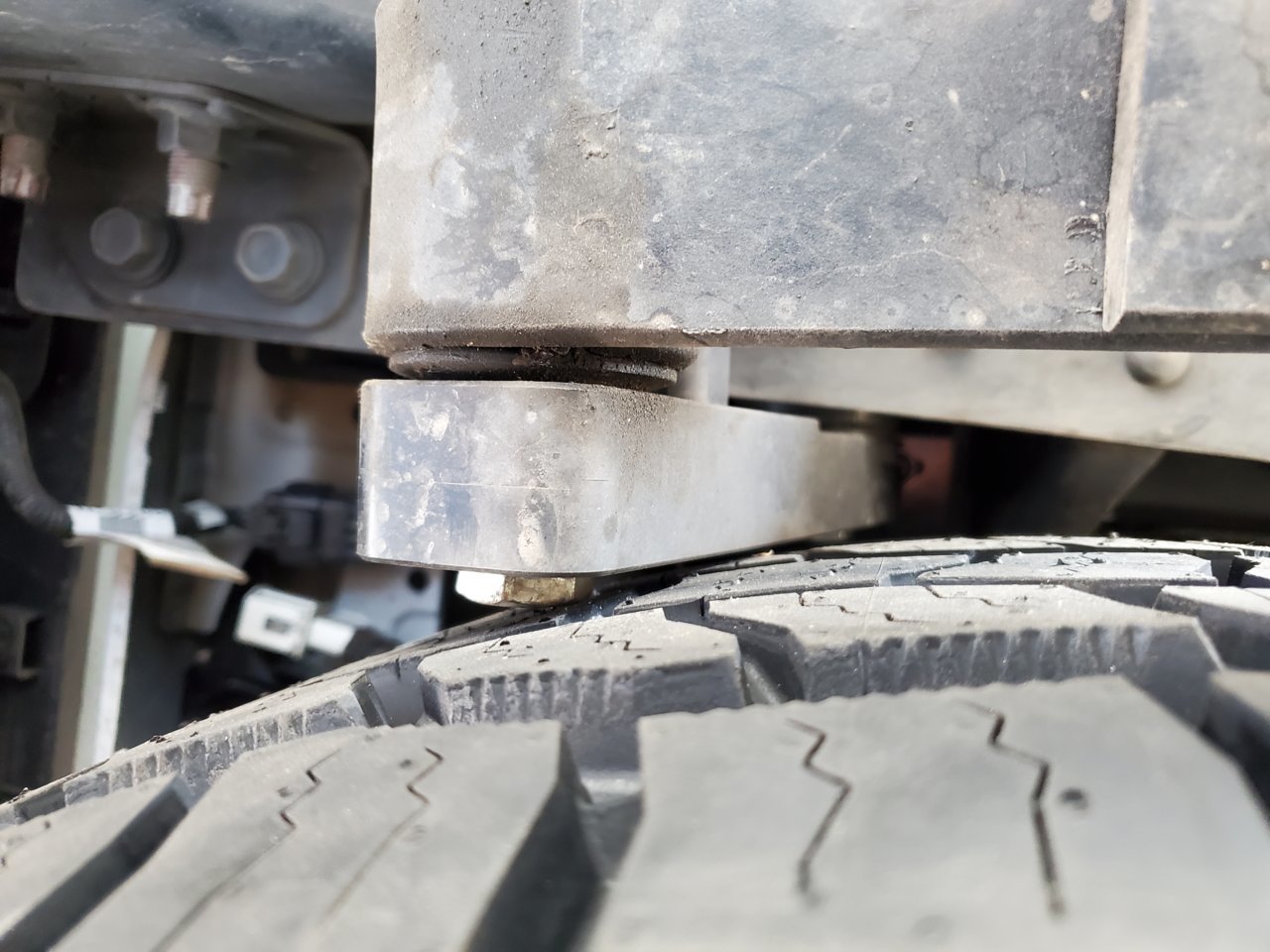

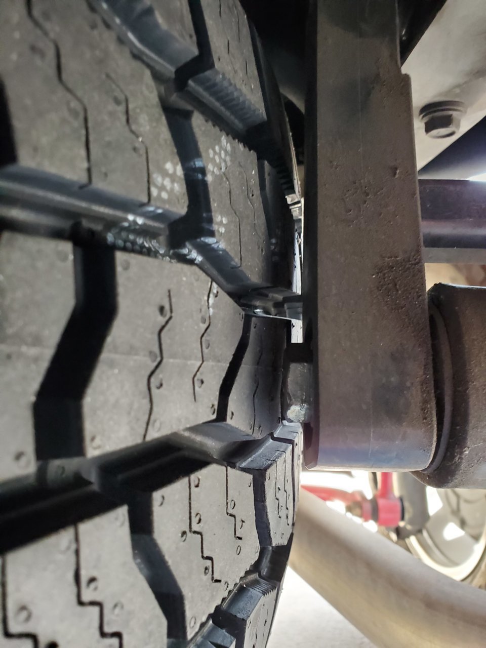

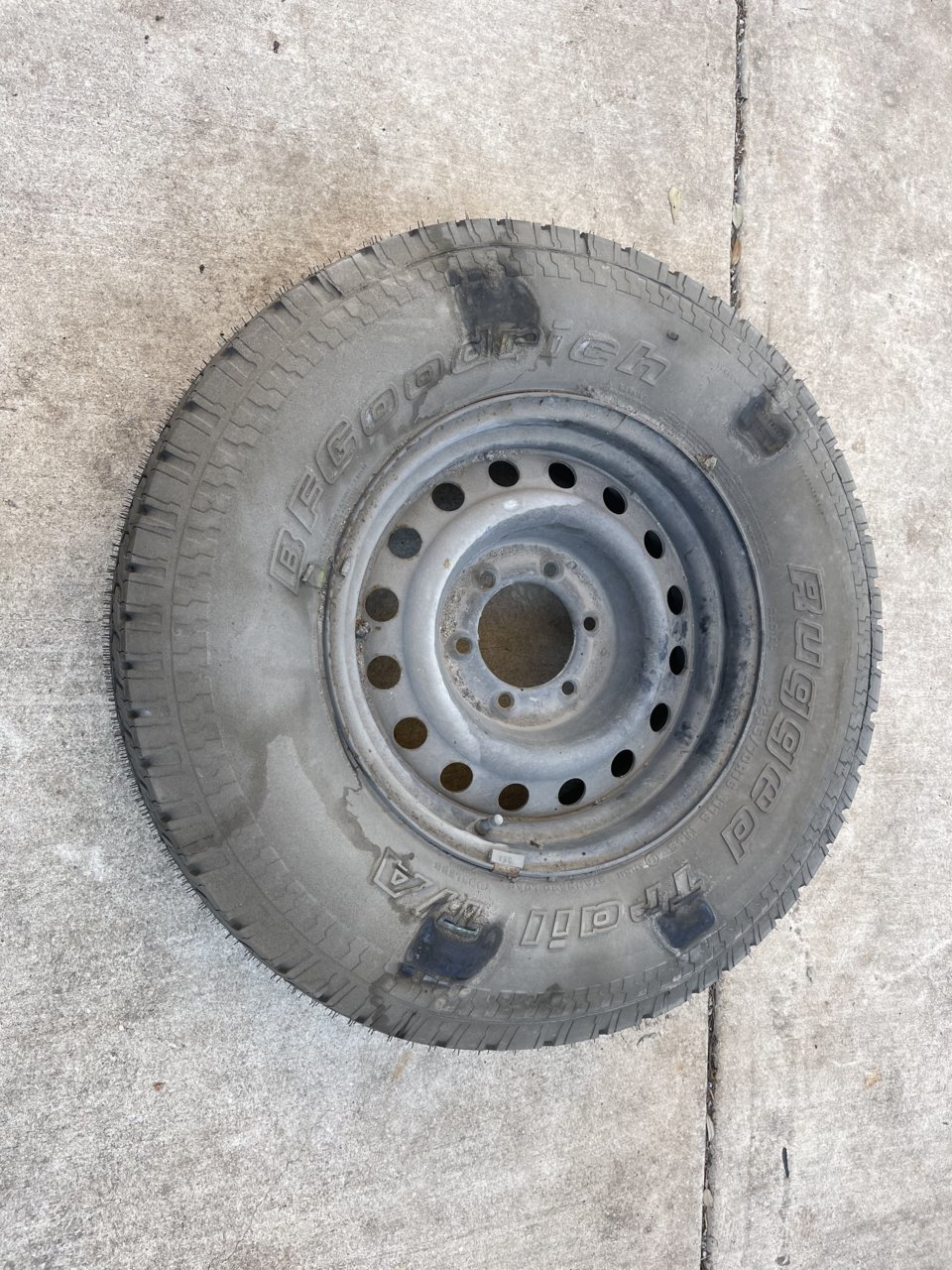

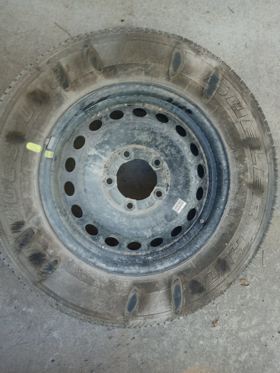

    Well. This was a surprise at 17,7xx miles when I went to swap out the OEM spare from under the bed for a larger tire.
    Ooof. Glad I found that and not somewhere between OK and AZ in the middle of nowhere when I needed it... Don't know if it actually affected the sidewall integrity. Doesn't make me feel comfortable.

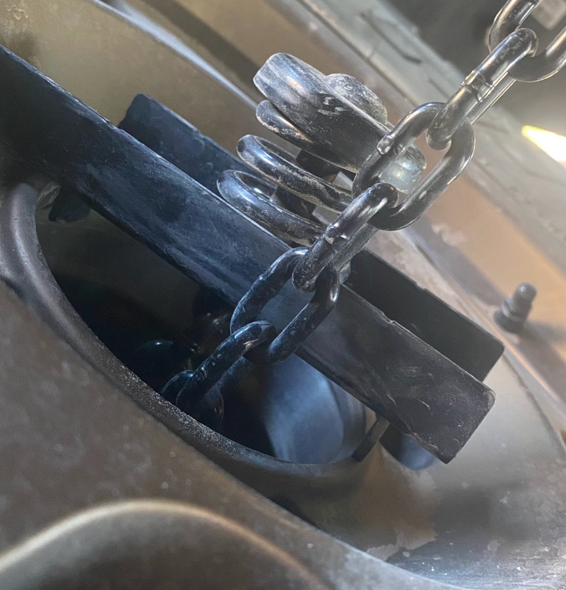

    I also flipped mine around so you can check the air pressure without having to drop it.

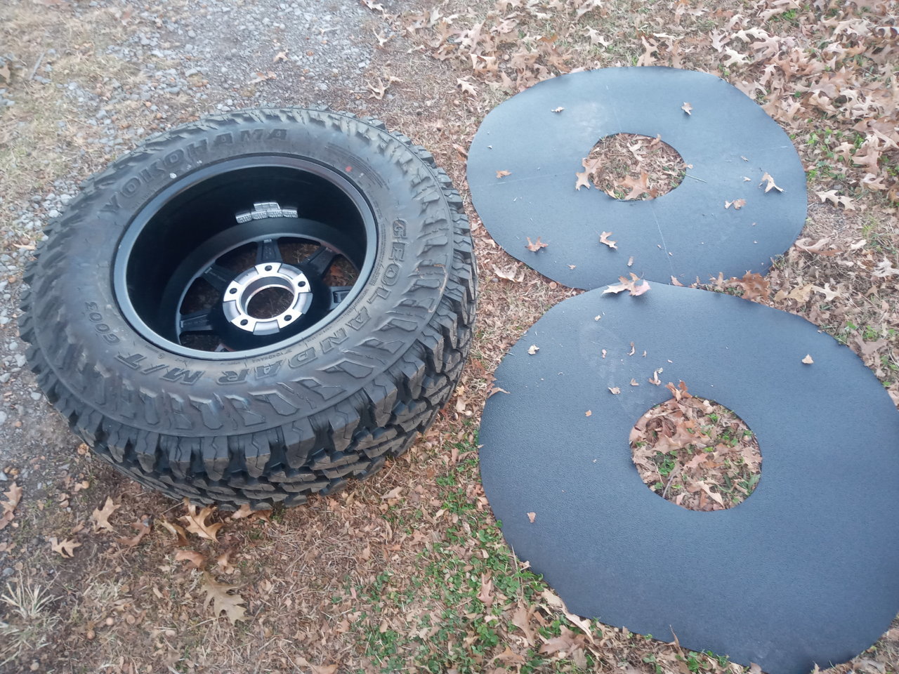

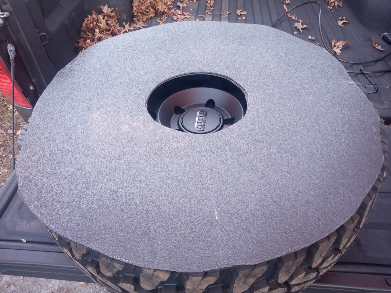

    Forgot to add. I'm in the search of a scrap piece of linoleum to cut out to add as barrier between the frame and my new $300 spare.

    I bought myself a 5th rim and matching tire, but had fitment issues under the bed (295/70/18). Going to see if I can remove the spare tire guides this weekend to make some additional room. Had rubbing on both sides on the shackles. I drove a few miles to try it, but I could immediately tell the shackles were binding up and not freely moving.

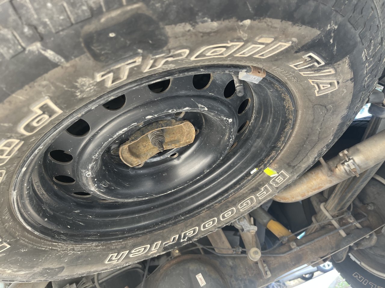

    Just a helpful hint for you guys.. if you decide to flip the spare over, there is some room inside the dish of the rim for some stuff.
    I keep a tow chain, cable ties and a few other items that can withstand the elements in there.

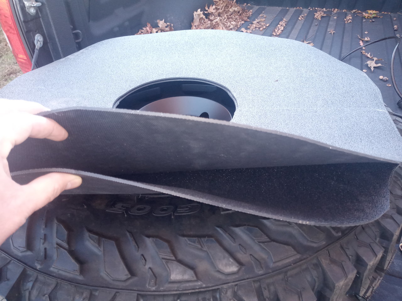

    Even better idea, pool noodle at dollar store, real simple.

    Not bad ideas ^. Cheaper than the $30 something I spent.

    I did the same many months ago, just be forewarned that if the debris makes its way between the face of the wheel and those utility mats....it will abrade at the wheel finish. Ask me how I know.... ;(

    Ooof! Glad you mentioned that. I'll take another look, but I believe the rubber mat doesn't contact the wheel at all. Perhaps a layer of tape though along the wheel's rim...

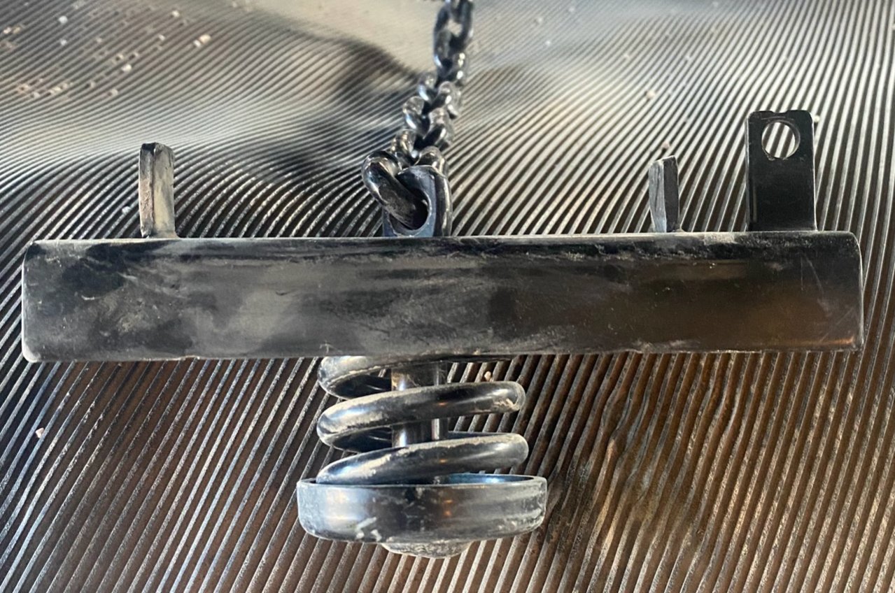

    the tire hoist is designed to sit on the hub bore and flat wheel hub mating surface. flipping the spare is not possible with alloy wheels.

    When I first tried to secure it with the chain bracket, I couldn't get the two bracket "prongs" to seat properly in the outer lug nut sockets (Method 701 wheel). I had to mount it with the inner wheel facing down.

    I still think it can be flipped, kinda depends on the wheel and if a centercap will cover scarring. In my case, I have a steel spare and it can be flipped. Someday, I will flip it and use the well for some hidden tool storage.

    Thanks @BiggHertz I thought that was my issue and you did save me some time. I still think I will pull the spare and probably tape the upper (outer wheel rim) rim b/t mats.
