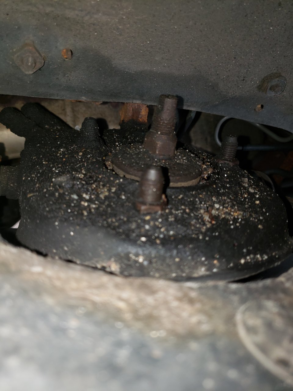

    Plan to do my shocks today.

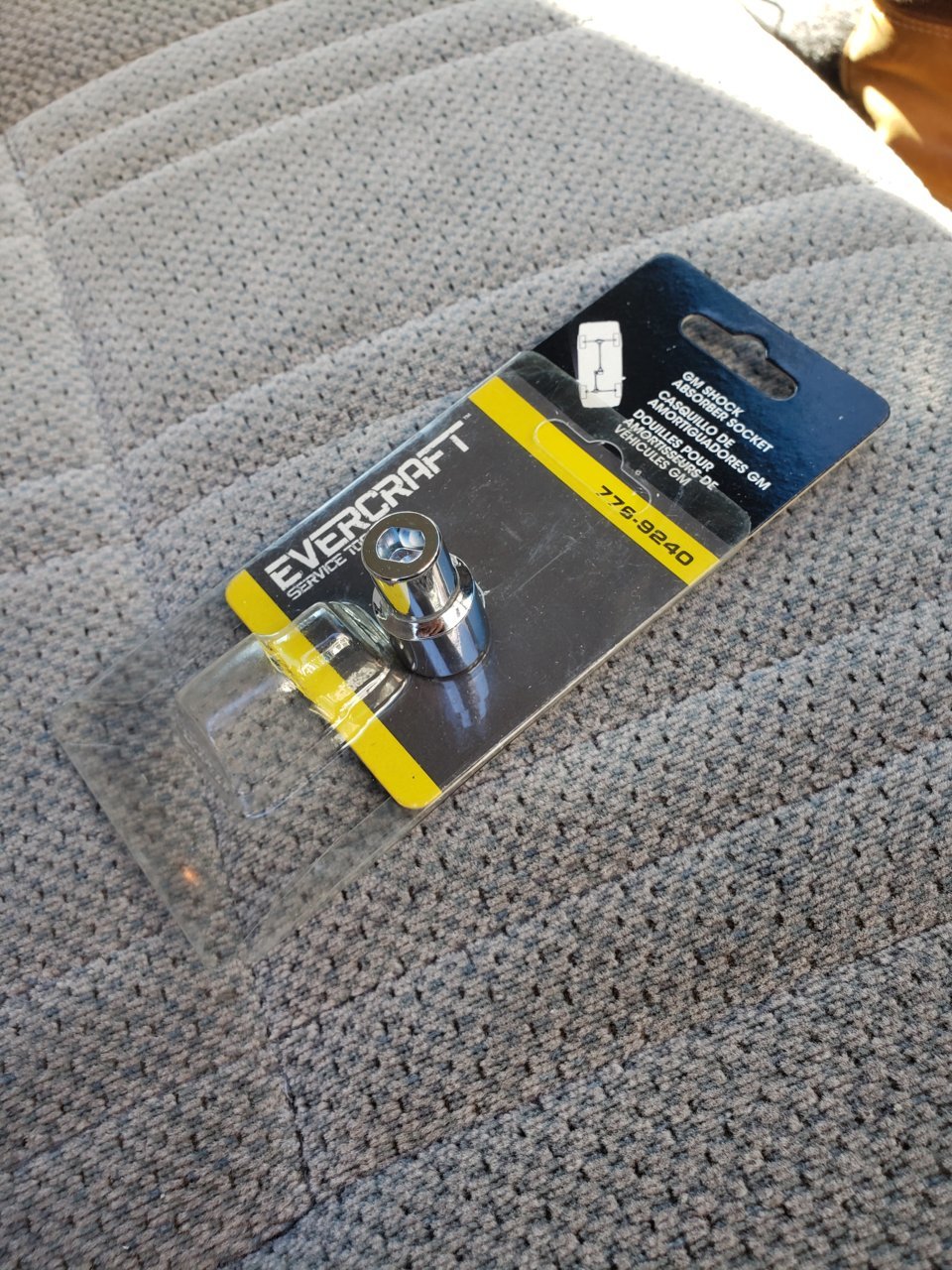

    Bought a socket to hold the shock rod in place for disassembly of old and assembly of new. It was from napa which doesn't fit since it was made for GMs.
    Pic for those who don't know what I'm talking about. (It's the rear for example but I'm doing the fronts)
    Here's what i got...

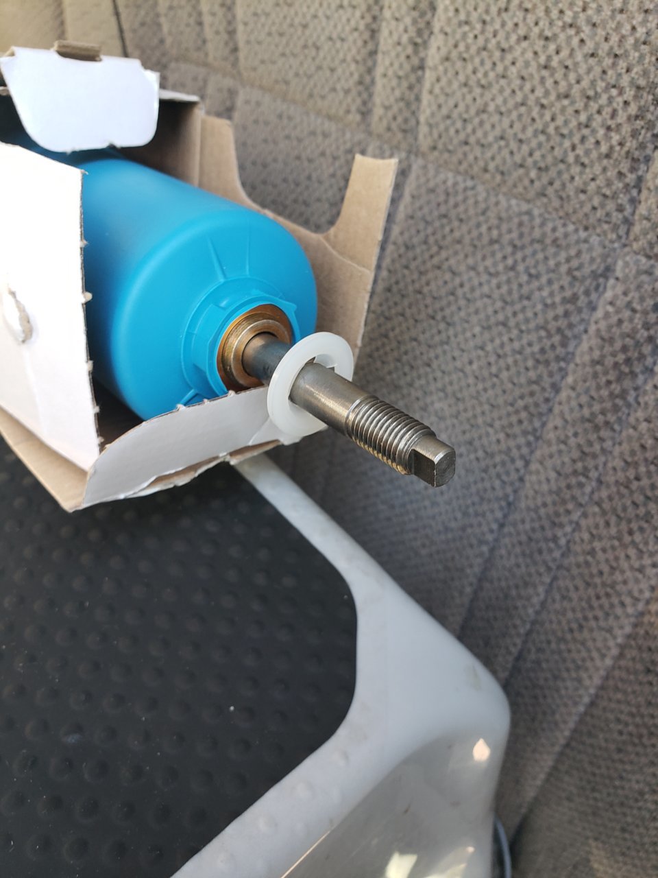

    Will any of these work or is there a socket out there that fits?

    I used my knipex pliers wrench. Which is a fancy adjustable wrench/pliers.
    The crescent wrench and/or vice grips will also work.
    There wasn't enough room for a socket iirc.

    I've never seen a shock top like that before, or never paid enough attention. Guessing the shocks are for the front? Kinda looks like the top stud from real vague memory.
    Rears were an Allen key on mine.
    I see no reason why the adjustable wrench wouldn't work, or buy a cheap wrench set, and use a proper wrench with no adjustment. Personally, I hate the "slop" in cheap adjustable wrenches. I've rounded many a fastener that way...

    Do yourself a favor and pick up some needle nose vise grips. That shock top is common on tacoma shocks and the vise grips is the best way.

    For removing the old ones just clamp a pair of vise grips on the shock shaft. Chances are if you try to just hold onto it you're just going to snap it off.

    Napa had this but it doesn't fit tightly...

    You need a crow foot wrench to tighten the nut while you hold the shaft with either the vice grip or crescent wrench.
