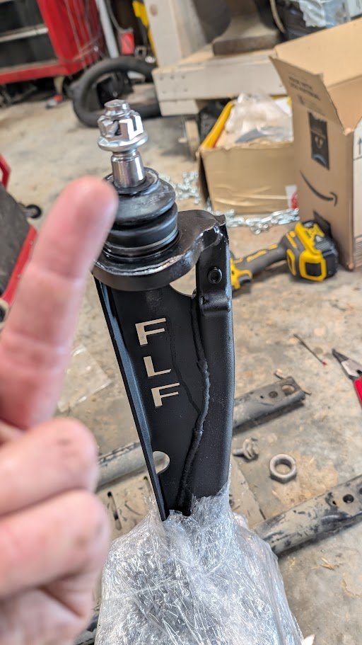

    My first repair was the massive oil leak. I isolated the leak to the oil cooler housing.
    I replaced the big oil cooler o-ring (90301-67004), oil filter bracket figure 8 o-ring (15692-50020) and the oil cooler relief valve (15695-50010). While working in the area, I found both of the bolts that go through the AC compressor to the fan bracket were missing.
    According to the Toyota service records, this truck received the SSC 70B lower ball joint recall service 11/2009 @ 72k miles. Since there is no record of the lower ball joints being replaced again, I utilized the ball joint recall kit (04006-62134) as well as new bolts (90105-12316) to replace them.

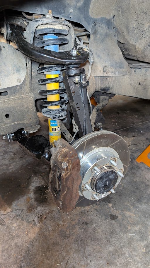

    While I was 'in there' I also replaced the front rotors and pads with Power Stop K2324-36 Front Z36 brakes. I have had great experienced with this kit on my Land Cruiser so I decided to try it out on the Tundra.

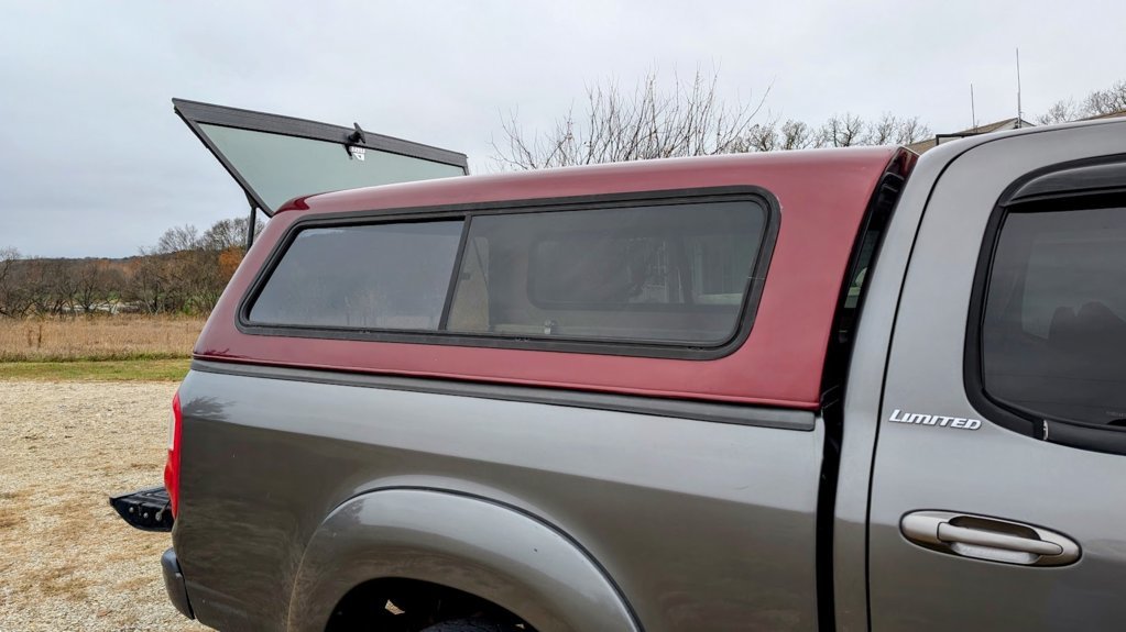

    I ditched the old toolbox in the bed and installed a secondhand Extang Solidfold bed cover. This cover installs very quick and can be removed just a quickly so the truck can be used to do truck things.

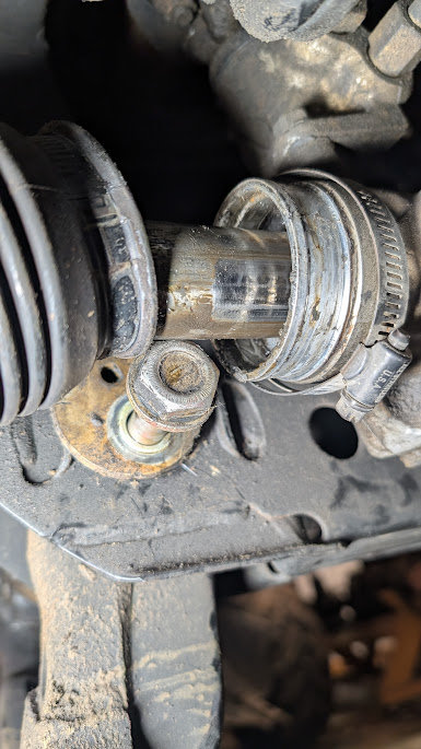

    Continuing with boring maintenance, I replaced the completely worn out steering rack bellows with a set of Moog bellows. I opted to try the Moog bellows since it only takes about a 1/2 hour to swap them out.

    I installed Bilstein 4600 shocks front/rear, 555 swaybar links, Daystar swaybar bushings and a 1/4" thick spacer (oh the horror!). The 4600's came preloaded with OEM style Moog coils. The shock assemblies I removed from the truck were a mismatched set. The silver shock is a Duralast from Autozone and the black shock is a Master Pro from O'Reilly. I think the Duralast assembly was recently installed since the fasteners were still shiny, but the lower bushing was already sagging. The Master Pro looked to be a couple of years old and the lower bushing had torn. Luckily both of the lower shock bolts were coated in anti seize.
    The front ride height went from (hub to fender) 19.125" driver and 19.25" passenger to 19.875" and 20". And ohhhhhh buddy, it rides so much nicer now. No more bouncing over dips and bumps in the road.

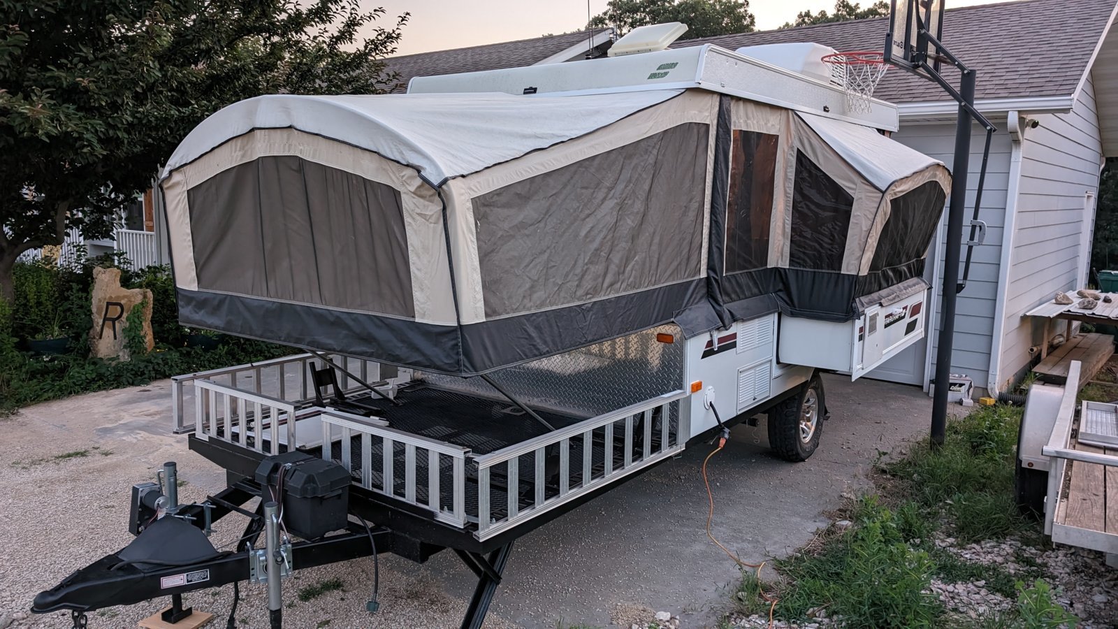

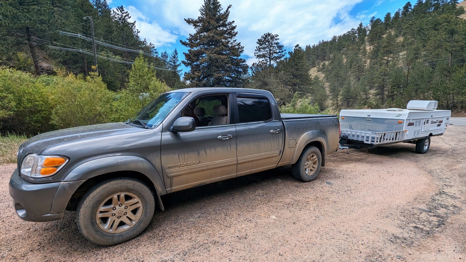

    My trip to the Rockies was short and sweet, but I brought home a new (to me) camper! The Tundra also hit 283k miles on the way home.
    The Redarc brake controller worked perfectly. My towing fuel economy was between 10 and 14 mpg, depending on the wind.

    With a growing family it should be a bit more useful than the RTT trailer I built several years ago.

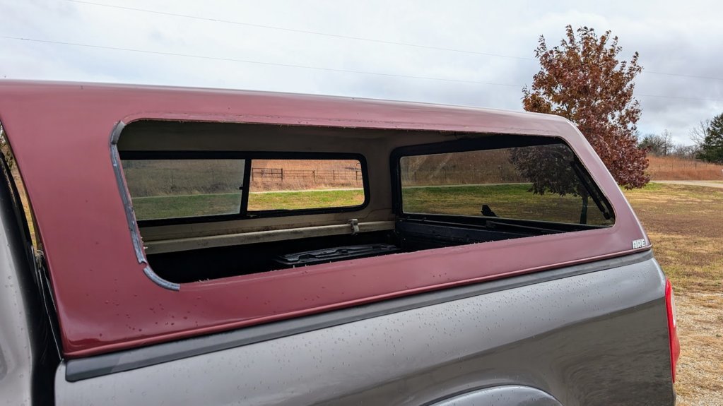

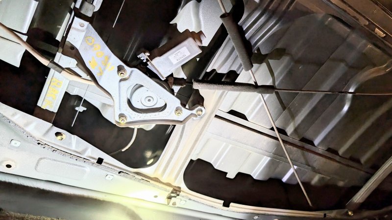

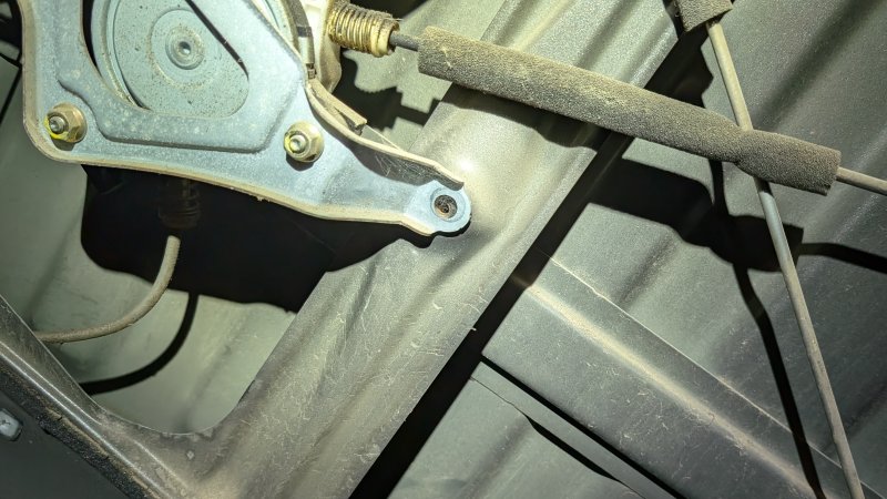

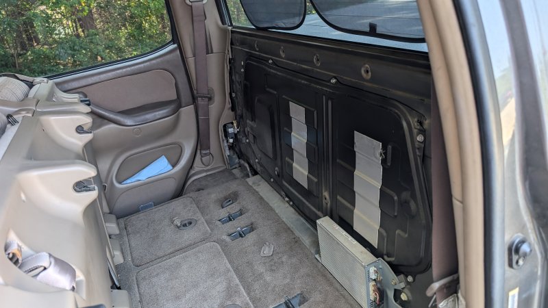

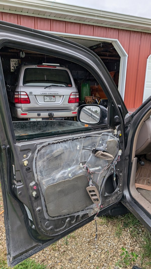

    When it rains, it pours... quite literally.
    I went to a local drive up yesterday and heard a loud "pop" when I rolled up the drivers side window. I noticed the window wasn't fully raised so I lowered it to try again. It struggled to go up and I noticed the window wasn't sitting correctly in the tacks. Despite the rain that was falling, I drove the 20 miles home. Once the door was opened up, I discovered one of the bolts that hold the window to the regulator has fallen out. This caused the window to fall out of the tracks. I loosened the front track, got the window positioned in the tracks then reattached the regulator since the bolt that fell out was in the bottom of the door cavity. This was a simple process, but it was NOT fun in the rain. In hindsight, I should have back the 100 series out of the shop to make room for the Tundra.
    I speculate the wonderfully smooth I70 corridor in Colorado (/s :rolleyes:) helped jostle that bolt out of the regulator.

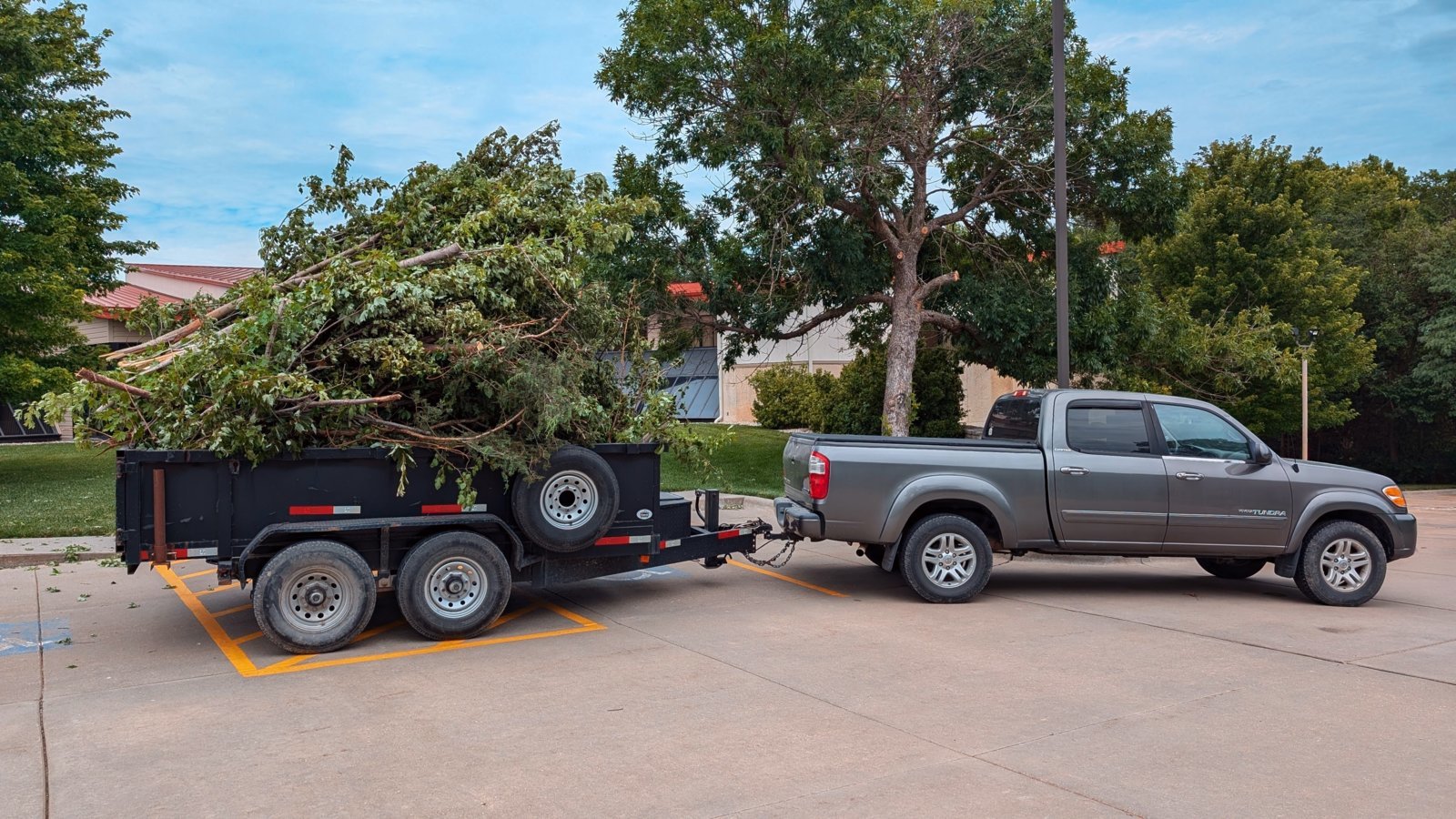

    I had to put the Tundra to work hauling storm debris. 90mph wind and 6" of rain in 1.5 hours is pretty intense for Kansas.
    I borrowed the dump trailer from a buddy who pulls it around with diesel trucks. After I used it I told him that the Tundra really noticed the weight on a couple of loads. He said that's because the trailer is 4,000 lbs empty!
