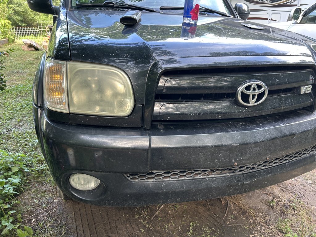

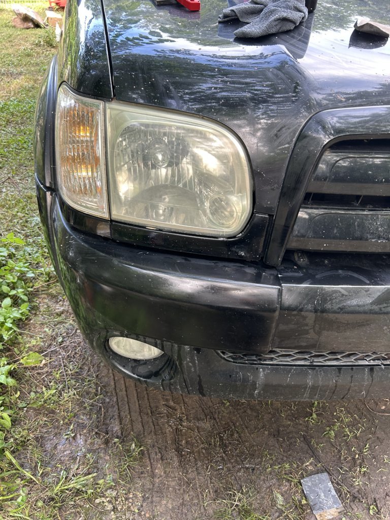

    Midnight already ran good, but when i changed plugs could see more carbon on pistons than I like to see (I had an engine ruined from previous owner running cheap gas) so I ran some ATS 505 fuel treatment through it to clean injectors, and hopefully start getting some of the carbon out.
    Idle, and acceleration is definitely smoother.
    Also took a little time and started on cleaning up the headlight glaze. Looking better.

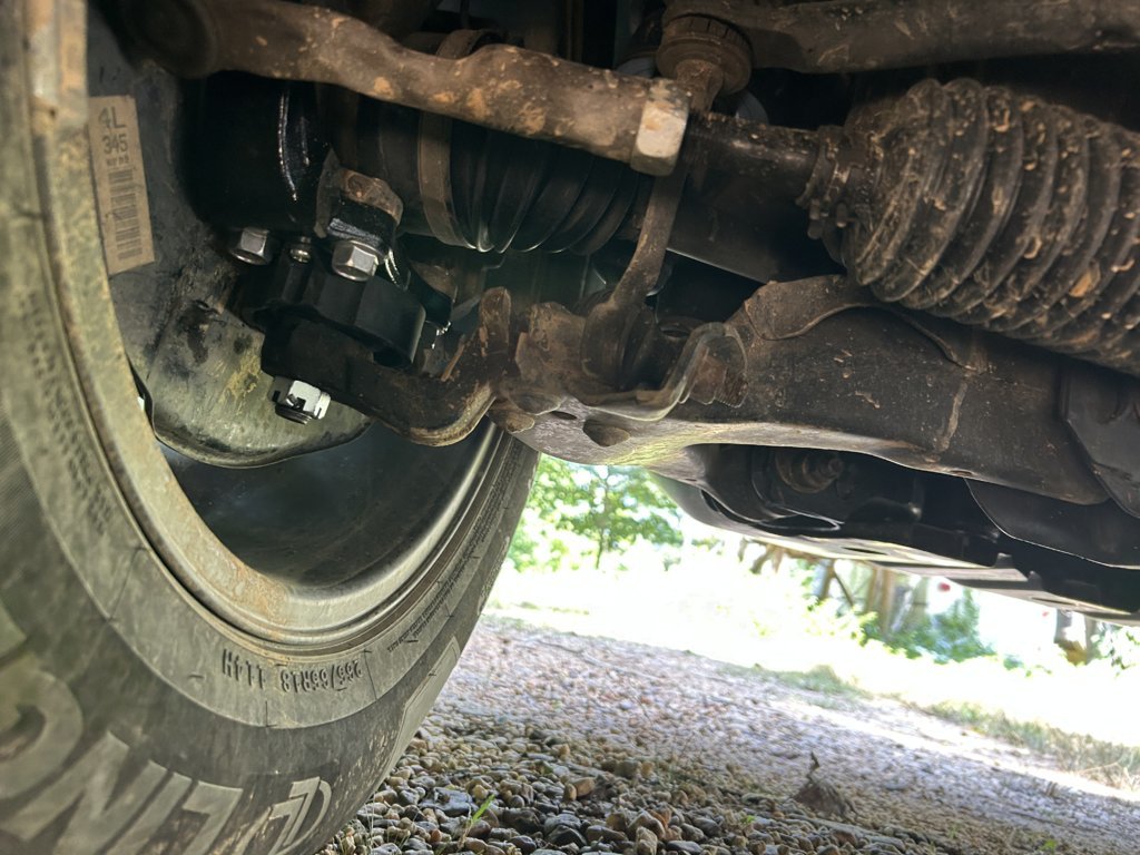

    I'M MAD!!
    Took it to front end shop I been going to for years right after got it, and told them to go over it with a fine tooth comb, and tell me everything they could find.
    Thinking the front end "mechanic" who installed my inner tie rod ends, and aligned the truck must have gotten it off, because it pulling slightly to the left, then the right, and takes too much turning of steering wheel to get it to respond.
    Had my wife help me, and I checked my front end today.
    Also told him to replace carrier bearing.
    According to the front end mechanic only thing wrong was inner tie rod end, and that my carrier bearing was good that it was my slip yoke worn out causing the problem, and I should take it to a drive shaft repair shop.
    Even though slightly doubtful I took his word without looking, and ordered a new drive shaft. When I installed I realized he didn't know what he was talking about because it was the carrier bearing. Installed New drive shaft had improper carrier bearing that squealed every time I took off, and bad u-joints so got a new carrier bearing for old one, had it balanced and been using it since so I should have doubted the rest of his evaluation.
    When installing the tie rod ends Mechanic did tell the owner to tell me I would need new rack and pinion soon, as it was seeping fluid. ATS 205 stopped that
    He didn't say a WORD about rack bushings being bad! And you can't do a proper alignment if the rack is moving over half an inch both directions.
    Been biting my tongue, but I need to tell the owner his mechanic isn't good. 3 times he been wrong on my truck, and four times he been under it. Didn't realize he had only been there 2 years, and not the same one who was so good and thorough.
    Should have been good to go by now.

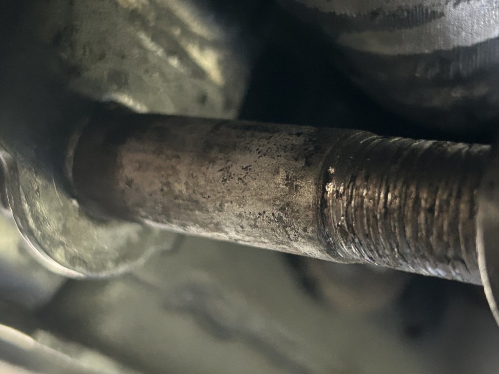

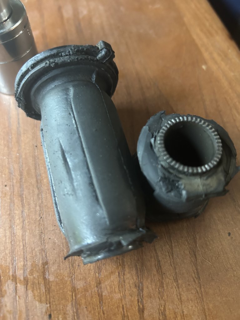

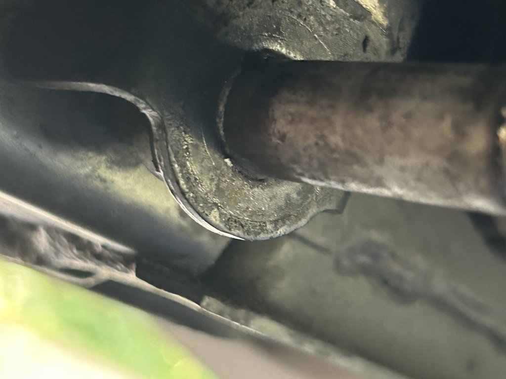

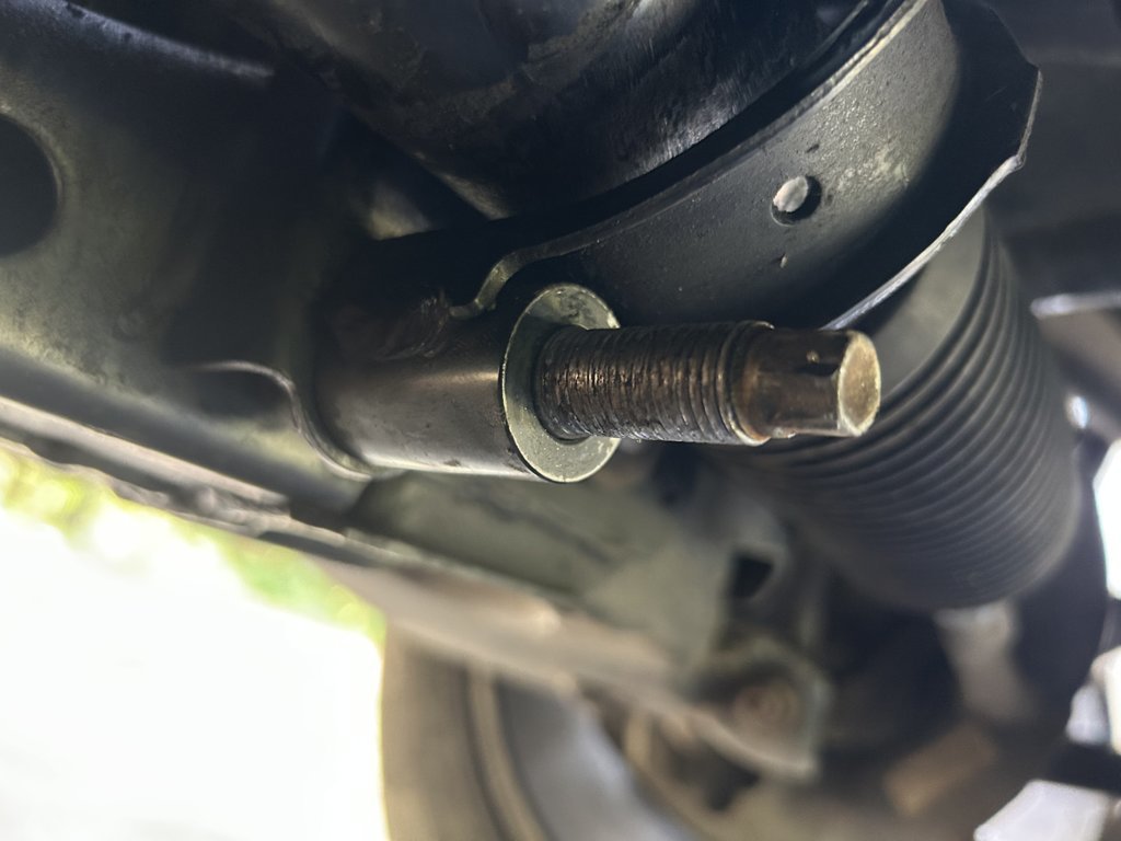

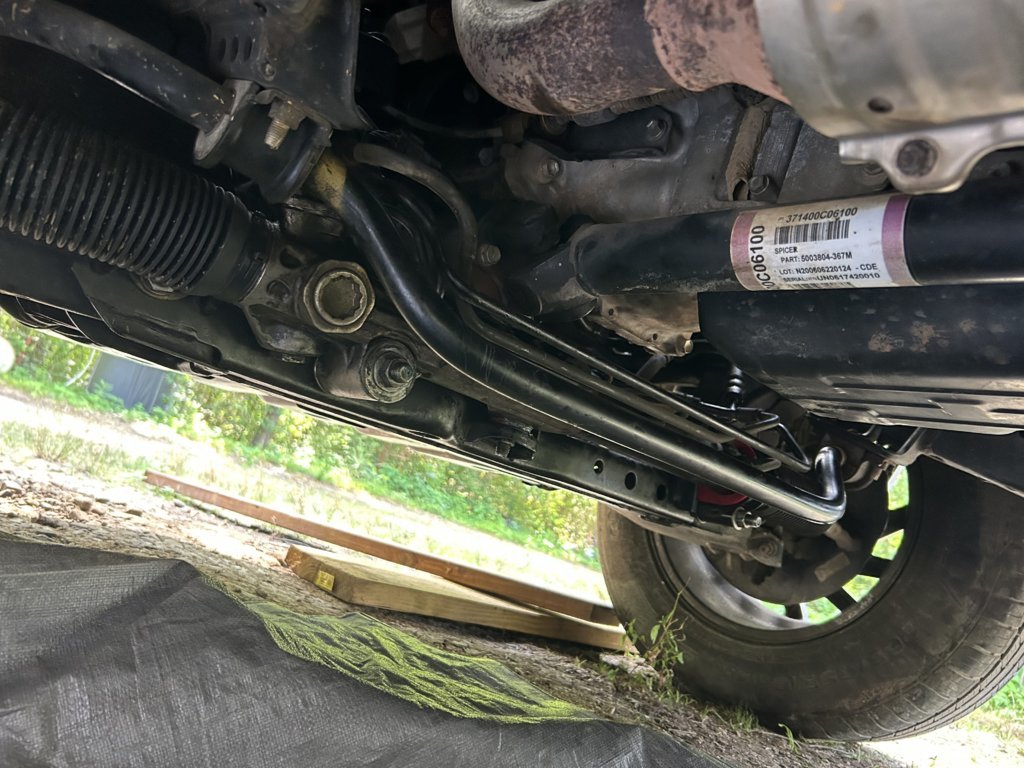

    Working on the rack bushings today.
    What a mess. Had to break out the 800lb torque impact.
    Don't know for sure it was the front end mechanic: from looking at the bolts, and knowing he was last to touch it I have a sneaky feeling he didn't want to call, and say he had missed something: but instead of saying it needed rack bushings someone decided to tighten the living fool out of all the bolts trying to take up the slack, and drove the nut threads into the shoulders of the bolts/studs.
    Going to heat the last stud later, and see if I can keep it from stripping the anchor nut in the frame. Already tried the 250lb torque impact on the stud, and it won't budge it. I really don't want to put the big one on that stud.
    At my age I really don't like crawling around under a vehicle, but from the headache the mechanic of tire shop I've taken it too, has caused me guess I'm going to have to start climbing under and checking everything myself.

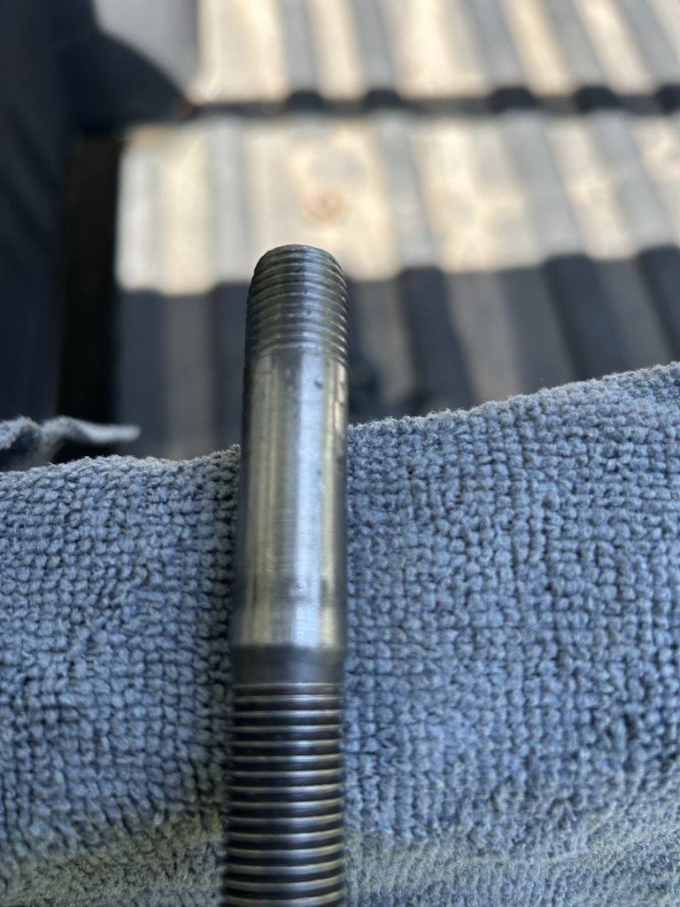

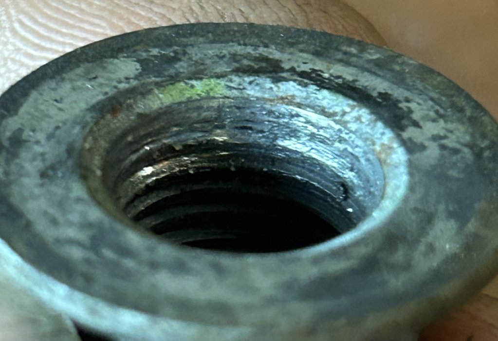

    Going to have to get some new hardware.
    Might be able to salvage this nut.

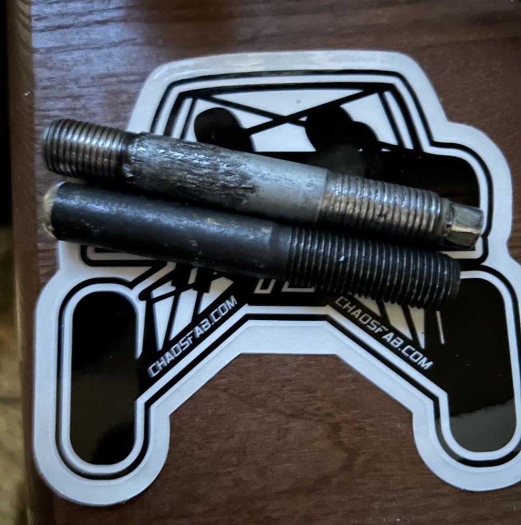

    Old bushings were bad enough just stuck socket over it and tapped it couple times with a hammer and out it came. No heat needed.
    New ones in, but still hanging because stripped stud. Don’t know how going to go about fixing it yet. Rounded off trying to get out even after heating it up at the frame.
    Going to need a cutting or rosebud tip.
    Also. I opted for the chaos bushings.
    The center bushing went together the way it should.
    The driver side: the steel guide bushing was too large OD for poly bushing, and had to be sanded down to get it to drive in, and even then it was a really hard bugger to get in.
