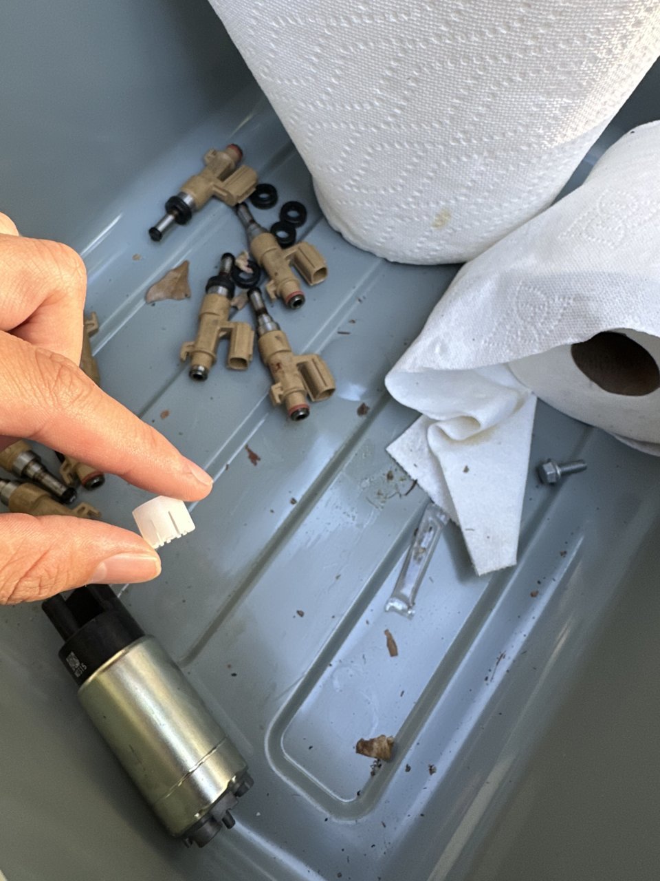

    Hello fellow tundra enthusiast,
    I am at this moment typing to you from an autozone parking lot in the dark with a headlamp, laptop, and portable wifi hotspot internet from my phone. I am currently waiting for a tow truck to tow my 2019 Tundra TRD pro home as it is not running to even get me home. So i need your help just to see what I can do to fix this adventure im having. I just installed my harrop supercharger today with my friends who have mild to no mechanical experience. After installing the supercharger and installing the stage 2 tune for it I am having misfire in 1, 2, 3, and four. It started up okay but has extremely rough idle and died/stalled when I stepped on the gas. We thought it was a fuel injector issues so we removed all the fuel injectors and found some injectors that werent seated in the rail all the way so I also on top of that had a too lean code. After clearing the codes it seemed to hold idle and i was able to drive it with extreme hesitation on the throttle to an autozone and nappa. After purchasing a battery and coming back the truck is havig trouble starting, holding idle, and missfiring again. Putting it in gear and then after touching the throttle completely stalls the truck. I've been diagnosing the truck and the unplugging the fuel lines from the fuel rails and front of the gas tank. Whats strange is that Fuel only comes out when im cranking the vehicle. No fuel comes when the Key is in the Ignition position. Same with the fuel lines on the bottom of the truck coming from the tank. In fact the smaller fuel line(which i presume is the fuel return line) I can crank and no fuel returns back to the tank. Only the fuel sending line has fuel come out when cranking. Is this normal behavior? I am convinced it is some sort of fuel issue. Maybe we got some hoses from the gas tank or fuel pumps mixed up or the fuel pump is dying. Please any and all help will be appreciated. I am in Valdosta, GA if anyone has the expertise please reach out to me. What are my options? Will the toyota dealership here touch it even if i did the modifications myself?
    Sincerely,
    Michael

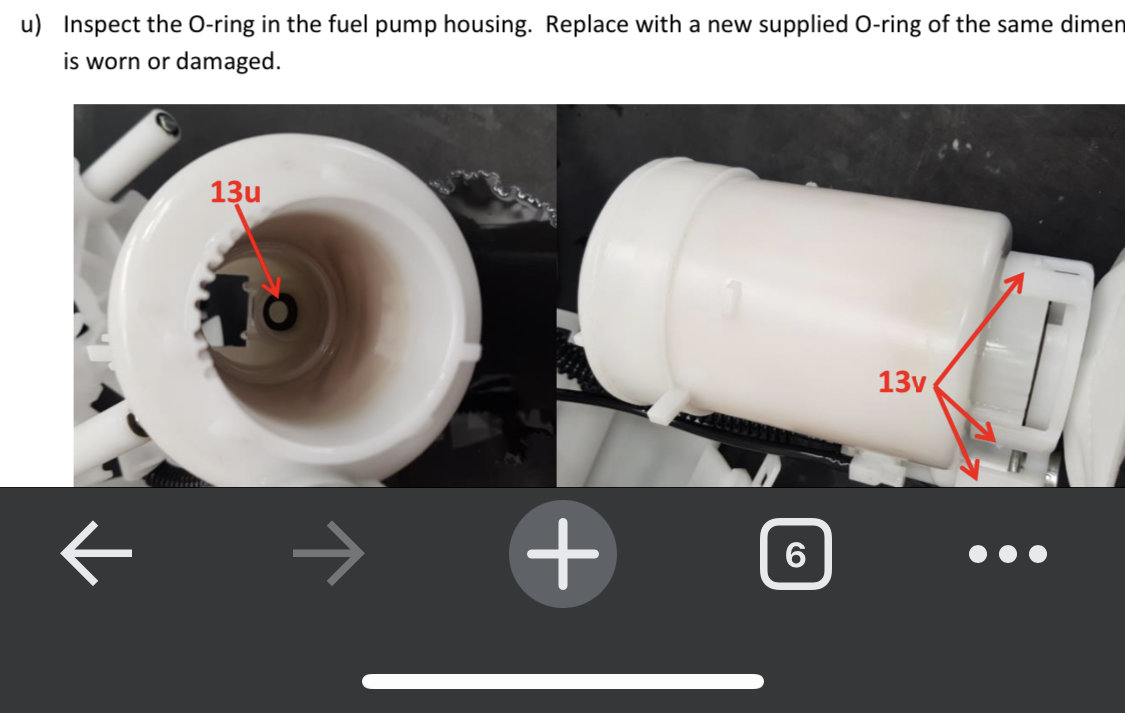

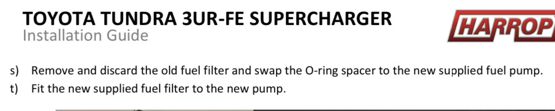

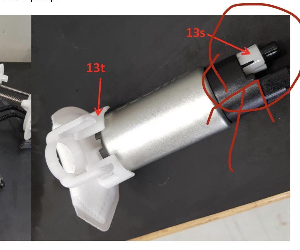

    Okay so I think I figured out the issue looking at the instructions. I had a hunch but this basically confirms it. I got my friend who had very little to no English install the fuel pump. I thought my other friend who knew English checked his work but he forgot to swap the fuel pump o ring spacer over I think. Not sure yet but I’m definitely going to drop the tank and check1C0822D3-B0A0-4306-A702-0C1773A190BF.jpgE37CC12E-E297-4C63-B3D6-878BE93E19F9.jpg

    It worked! Spacer was the culprit. Oring had nothing to back up against. When we took the fuel pump out the oring got blown out back towards the pump. Runs like a dream now. Going to go test drive this supercharger now.
