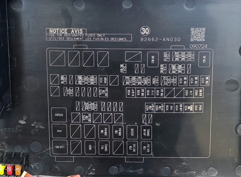

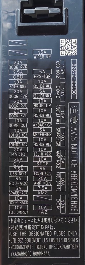

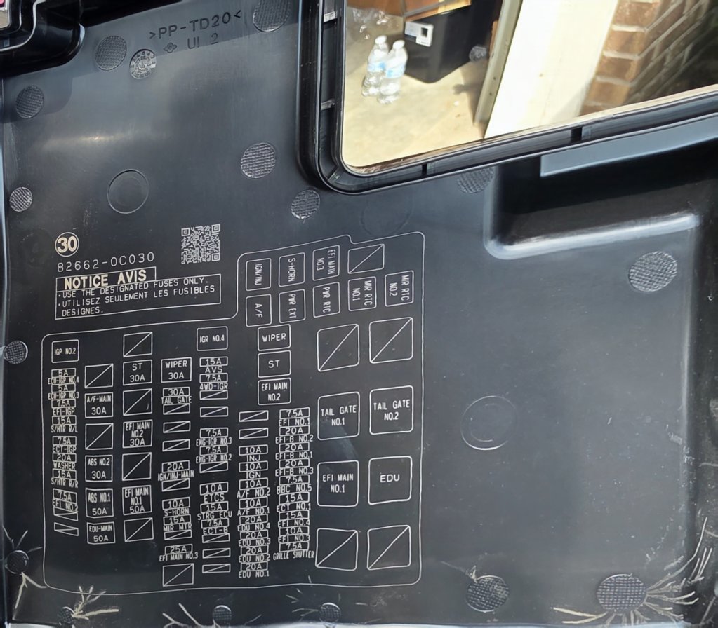

    Ok I have 3 boxes As I understand 2 in the engine area and 1 internal, right? I checked each of them but I can't identify the fuse I will send the 3 photos to see if you can help me please

    The vertical image is of the cabin
    The picture with the L-shaped cap is on the driver's side
    And the other one is from the passenger side

    It should be the one under the hood but I cant be certain.
    Does the Lid not tell you what each is for?
    If not you should still be able to check the fuses even without the fuse map.
    It's a simple matter to pull each fuse and inspect them visually.
    Or use your voltmeter.
    It'll be readily apparent either way.
