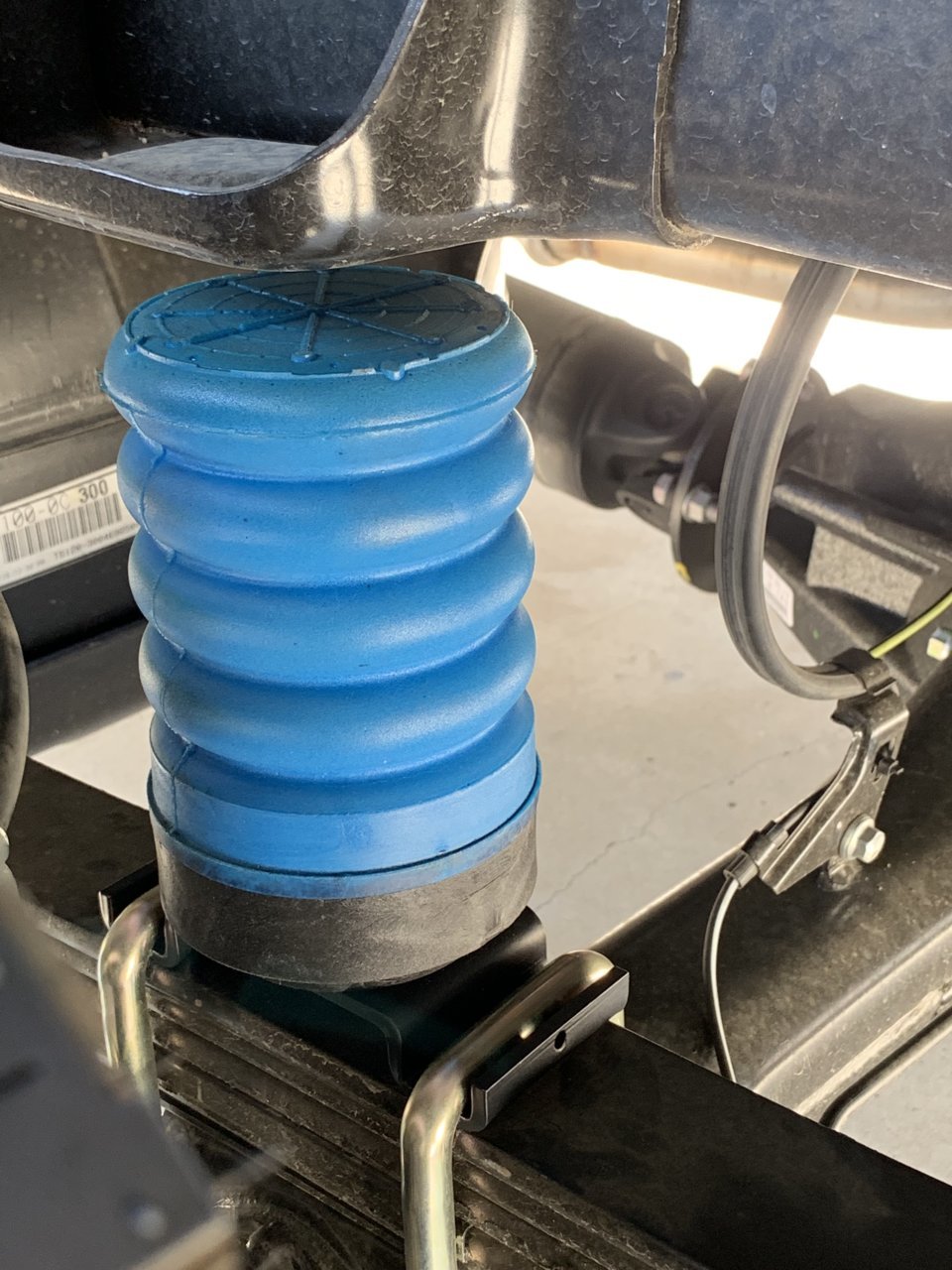

    SumoSprings work good for me when towing or loaded down.
    georgiey22, Y0TA PR0 and Black Wolf like this.

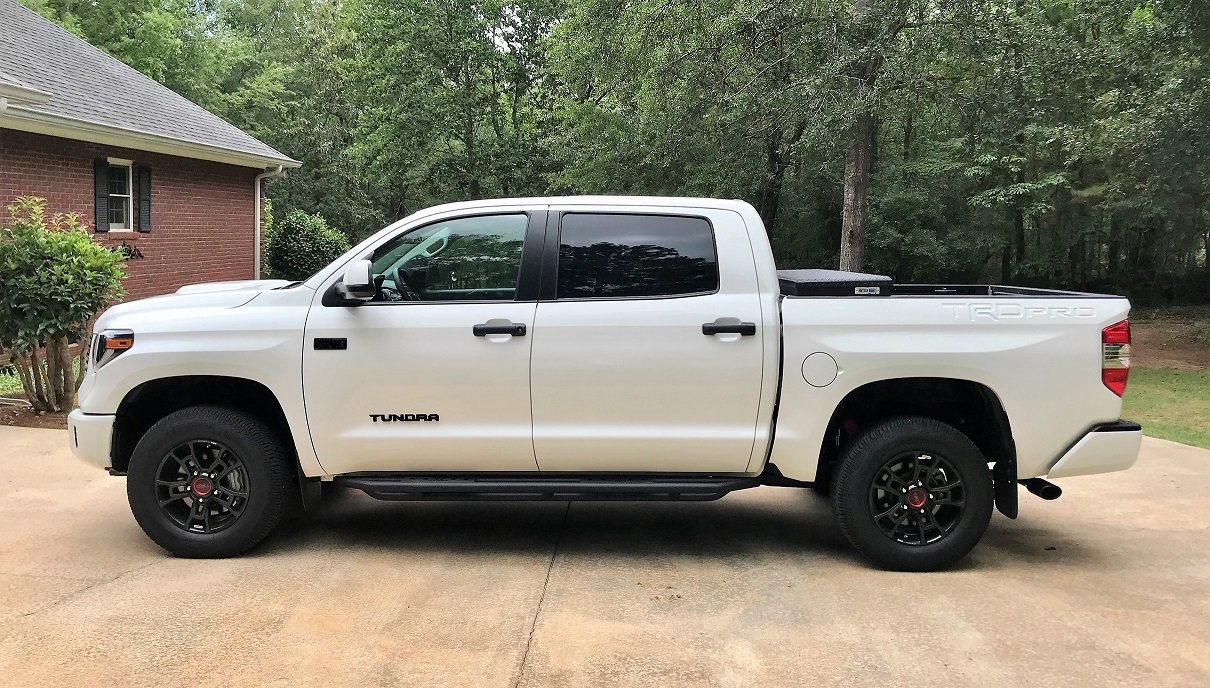

    I had the same issue with my PRO laying down while towing my Bay Boat. It wasn't terrible but THAT had to be addressed. Considered the Sumo Springs, Air Bags, Road Master Springs, etc. Finally decided on 1.5 inch lift shackles. Way cheaper, providing the results I needed. Simple to install, and presto chango, now my PRO has RAKE, and it rides exactly the same as before. Funny, a guy at the boat ramp asked me if my TRD Pro was a 3/4 Ton. He said his PRO does not sit that high in the rear. Told and showed him what I did, he was sold. I could not be happier with my decision to go with shackles.
    georgiey22 likes this.
