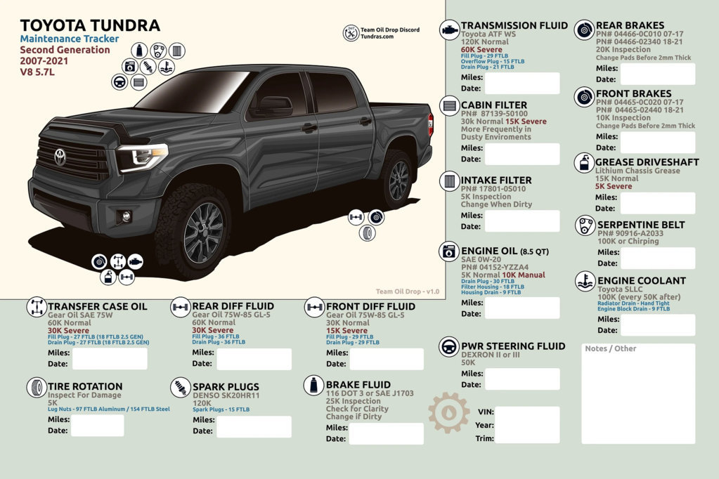

    I recently took ownership of a 2016 4x4 1794 with 90k miles. It seems to be in great shape, but I'd like to do any preventive maintenance that might be needed to keep it running for a long time to come. Synthetic oil, cabin and engine air filter and new tires were taken care of pre-purchase. Toyota Owners service history shows that Oil changes were performed on time throughout its life and front pads / rotors turned taken care of at 69k. Other than that, I see no record of fluid changes etc. There was a note about rear brakes possibly having a stuck caliper pin but no other info or indication of fix or changing rears.
    I am thinking I should go ahead and have the following changed. Thoughts? Overkill? Am I missing anything?
    Coolant
    Front / Rear Differential fluid
    Transmission fluide
    Check brakes

    Probably about time to replace the serpentine belt.

    I don't think your list is overkill at all. I'd add:
    - Brake Fluid flush
    - Transfer Case Fluid
    - Spark Plugs
    - Grease u-joints

    Add to the list: PCV valve, belt tensioner, and idler pulley. The tensioner and pulley may not be necessary, but I would do them while you are in there.
    Also, the transmission has a drain and fill plug that makes servicing it simple. I prefer a couple of drain and fills over a flush, but that topic can be hotly contested.

    I like this chart, it covers all the important bits.
    Eskew5[OP], HulkSmurf14 and blenton like this.

    I've done all of that and I'm barely over 108k

    Very helpful, thank you for sharing!
    I went out and looked at my coolant today and it looks super clean, bright red/pink so I am hopeful that means it has been changed at least once since the truck was made. I will get her in for service very soon using the info in this thread.
