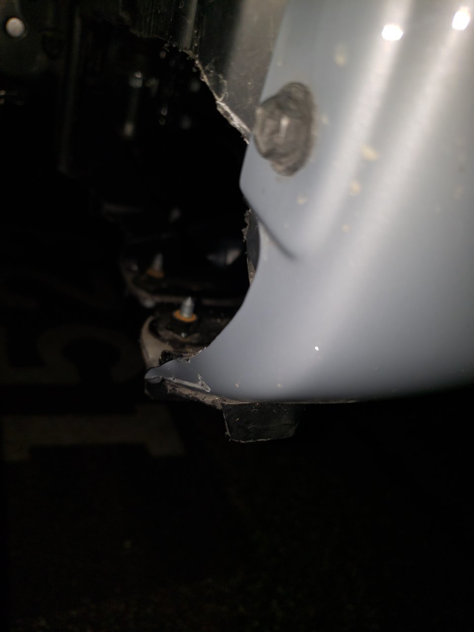

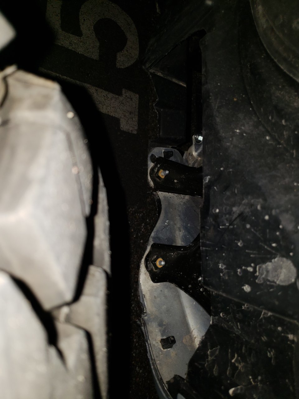

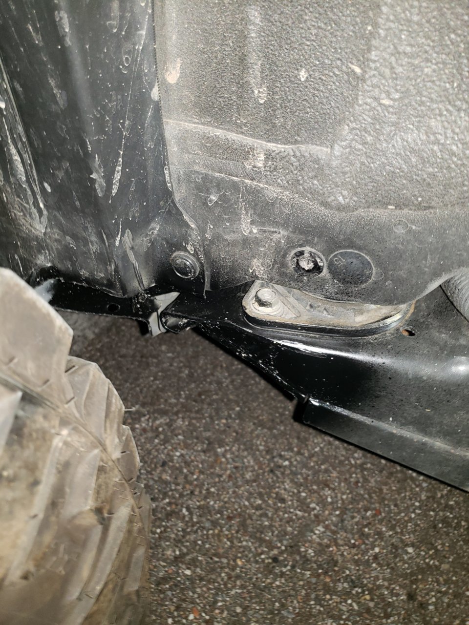

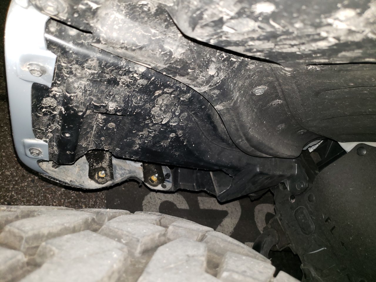

    Going to try and make this short-ish and sweet. Posting from my laptop then will upload photos from my phone so you can see what I'm looking at.
    So I picked up a Radflo 2.5 coilover kit with Toytec BOSS rear shocks w/ resis, Boss4x4s shackles, carrier bearing drop kit, and differential drop kit from Darren at Boss Offroad. Speaking to Radflo, they coilovers come preset at roughly 2.25". Also to be installed were 2" Bora spacers to retain the TRD off-road wheels (placing my offset at +9) with 35x12.5r18 Nitto Trails.
    Dropped my truck and all suspension off at Trick Trucks of Edgewater, MD two days ago and they "installed" the lift and did the alignment. I could have done this myself over the weekend, but I'm busy with work and the kid so a shop was the most practical. SEVERAL issues when I picked it up today with a NEW drop off date set for 2/21/2020.
    1. They installed and aligned the Radflos at the preset 2.25" height, then proceeded to make "adjustments" to the CMC and wheel well liner. WHY THE HELL would you start with the most invasive process first (see #2 and the shotty #3). Why not crank them up to 3" and see what you're working with before chopping?
    2. Front wheel well liner was completely butchered. Large 12" x 7" section was completely removed from behind the bumper caps due to rubbing. Not heated up and formed, not melted or lightly trimmed, completely removed.
    2a. When doing the initial #2, whatever f*cking cutting tool they used they cut into my Ecoological Bumpershellz that were paint matched. Granted, I bought them to simply cover the chrome end caps until I got an aftermarket bumper later in the year, but he proceeds to tell me the rubbing cause a portion of the passenger side end cap to sheer off. What? Come again? Clear teeth marks and a cut 1/4" into the lip of the end cap. Don't lie to me, I'm not an idiot.
    3. CMC completed, but looked super rough. Picked a 1" shard of metal from the CMC area off when I got home. Just doesn't look clean to me.
    4. They didn't even install the carrier bearing drop kit! Both bushings were thrown in the box with my take off suspension as "leftovers." WHAT?
    5. A DAMN VALVE STEM CAP IS MISSING. Small, but bro come the F on.
    Shop manager gave me the "we've never installed with these coilovers so we weren't sure how the adjustments affected the load on the coilover." Dude, start cranking and use a tape measure...are you serious? Then said since it was done, let it settle and bring it back in two weeks when they have an opening and they can crank it up and realign it and see where they're at. So they threw everything together at the 2.25" ride height and severely butchered my liners/CMC and aligned it and gave it back to me today. I couldn't leave the truck as I need transportation for work.
    I'm going down there tomorrow morning first thing and listing out all the problems. I'm going to request they adjust it to 3.25", realign it, and order me new wheel well liners that I'll reinstall and shape accordingly. The Bumpershellz I can ignore as they will be trashed in the future anyways and the damage is minimal. We will see how it goes.
    Sort of just venting, but I'm heated. Problem is I have a temper, rather large, and covered in tattoos....so I know when I go down there tomorrow to confront the shop manager it will get ugly based on appearances alone.
    Currently center cap to fender I'm at 23 and 2/10ths driver side, 23 and 3/10ths passenger side.

    20200205_185954.jpg 20200205_185939.jpg 20200205_185924.jpg 20200205_185807.jpg 20200205_185912.jpg Pics

    That's one of the worst BMC/CMC jobs I've seen. It can be fixed, but I'd find another shop to fix it. I'm still scratching my head on the decisions they made.

    That cab mount chop is terrible! They didn't even chop the part of the mount that will cause the most problems for clearance. I did better than that in my driveway on jack stands.
