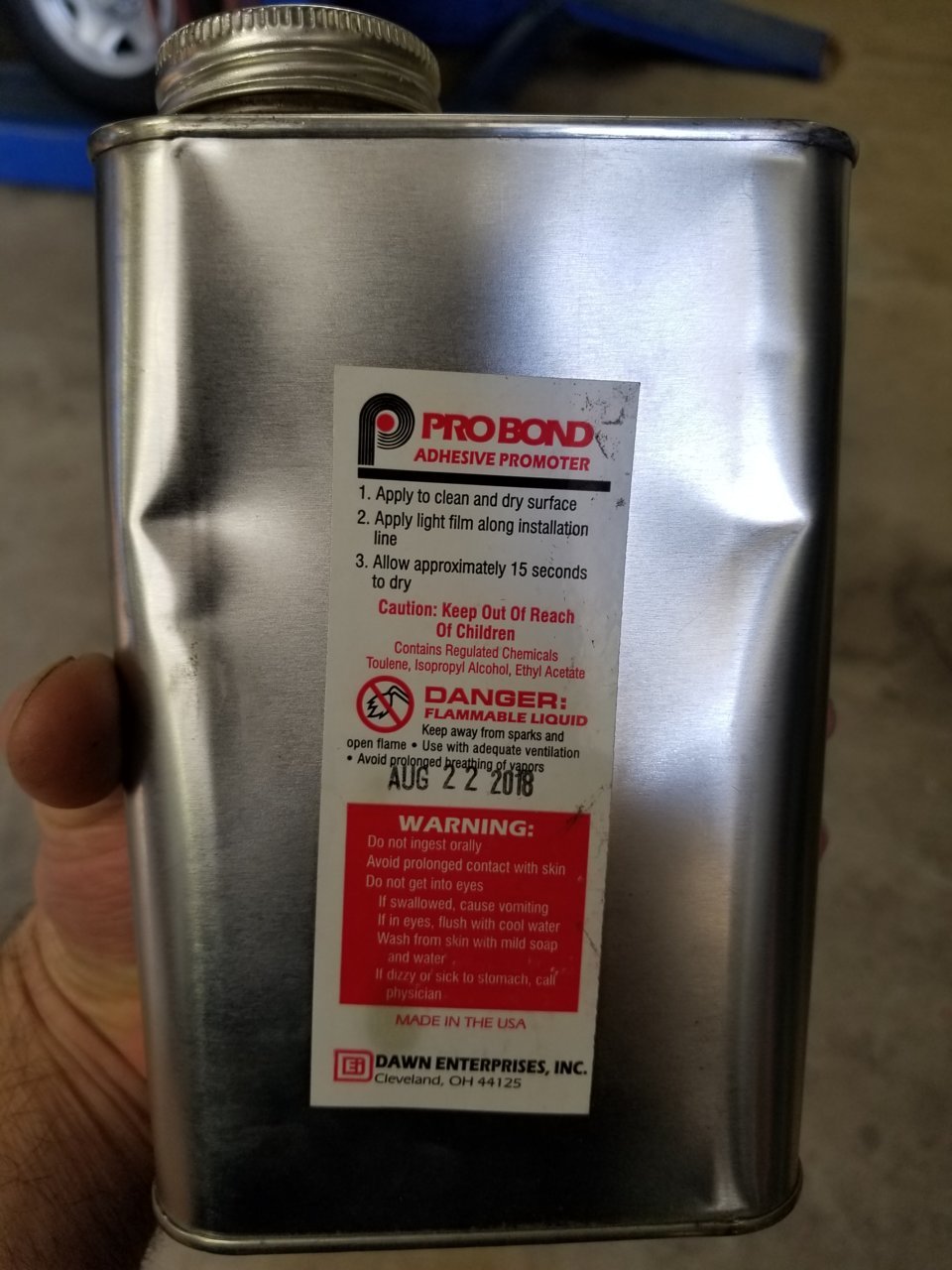

    Check your local auto parts stores for adhesive promoter. The stuff I use is ProBond but 3M also has it. The 3M promoter also comes in a single use packet.20180420_173744.jpg

    Exactly, this is the right way to do it. Any auto paint supply place will have it too. You can also buy activator in a presoaked wipe.
