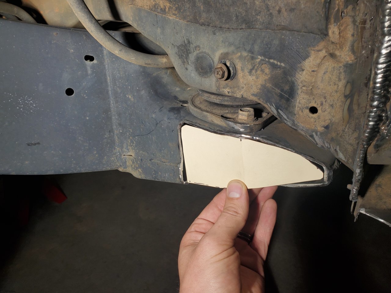

    What @joonbug said. I made one side 3 or 4 times. Comically dumb until I decided to make some templates.20220309_192138.jpg
