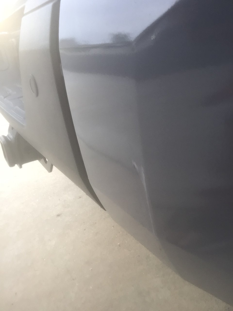

  15. Dec 14, 2018 at 4:00 PM
    SocaliTundra958
    SocaliTundra958 [OP] New Member
    Nov 29, 2017
    #11254
    117
    Temecula
    2018 SR5 CREWMAX TUNDRA
    stock
    Here’s an image of the scratch but was considered a collision by the service person I was speaking too,
    Not even close to a dent, yet it would be a cause???
  16. Dec 14, 2018 at 5:25 PM
    shlunky
    shlunky New Member
    Oct 15, 2018
    #20599
    82
    BWAHAHAHAHAHAAAHA
    THAT is some funny stuff. I truly hope you don't ever have to go back to that dealership again.
