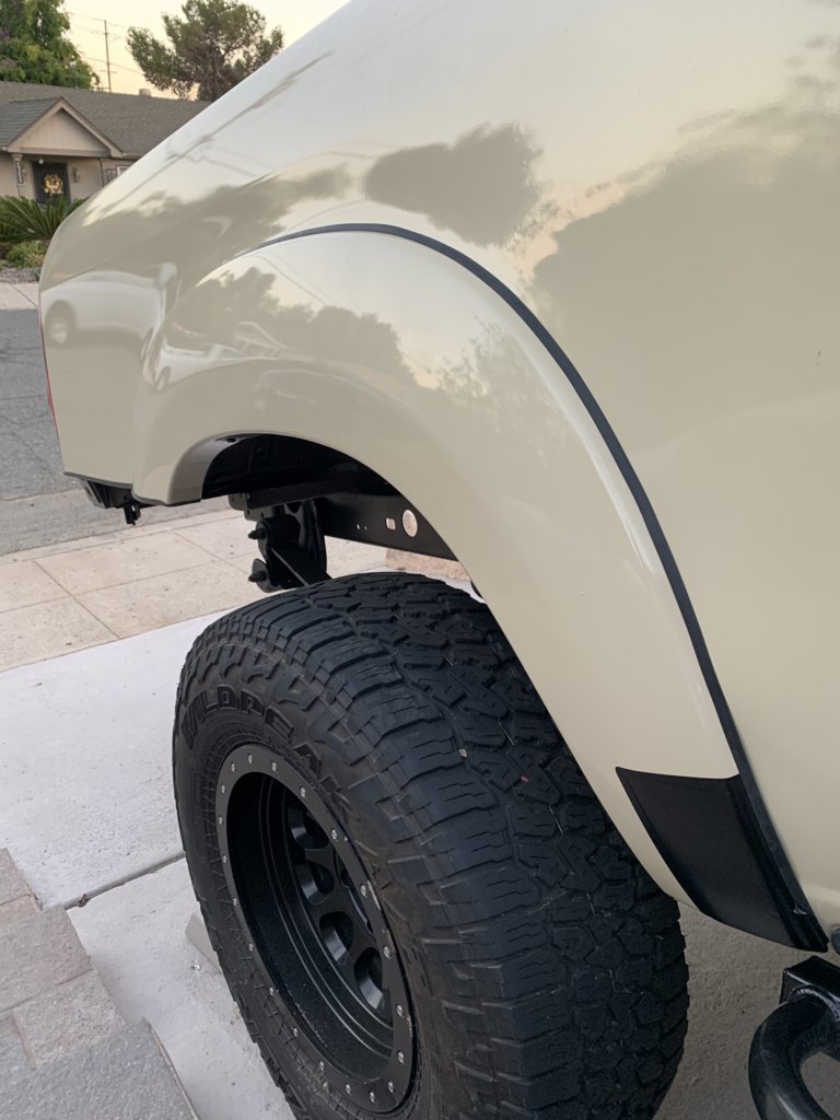

    I used Metro Restyling to wrap my faded hood. Some wraps are "breathable," in case you have a small amount of trapped air in a hot environment you won't end up with a large air bubble forming due to the heating. I only did my hood which is a large flat surface, so pretty easy and I had three small areas I messed up that you would have to look very close to notice. It took one hour.
    You might notice the side mirrors are wrapped in the pic but I took those pieces off as it wasn't a good enough job for my satisfaction.

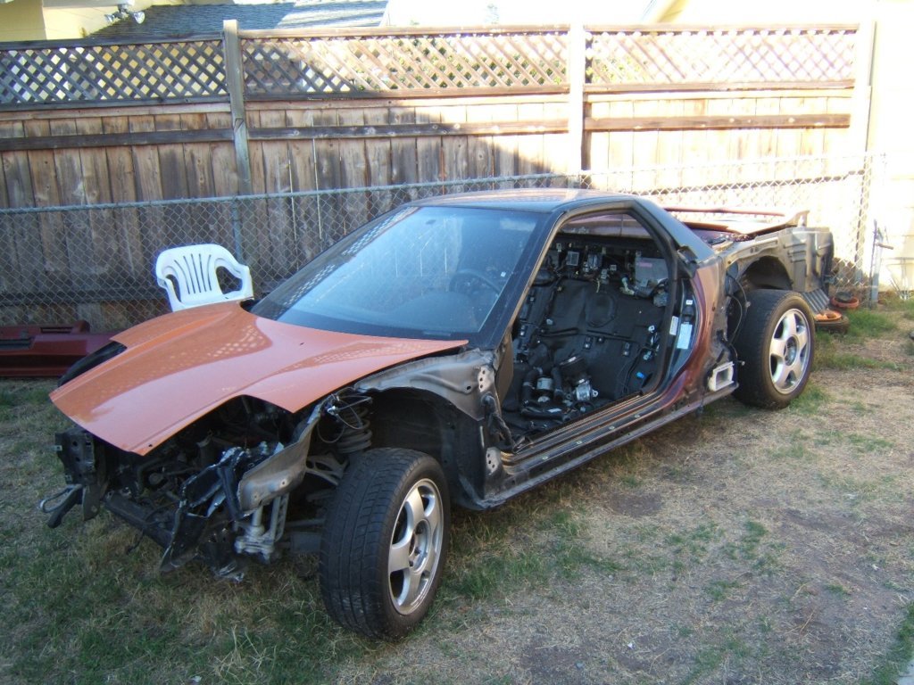

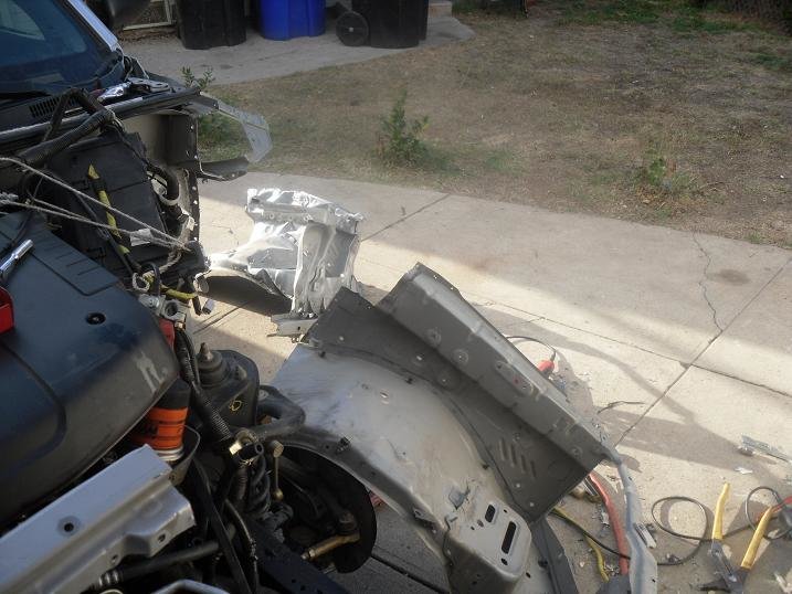

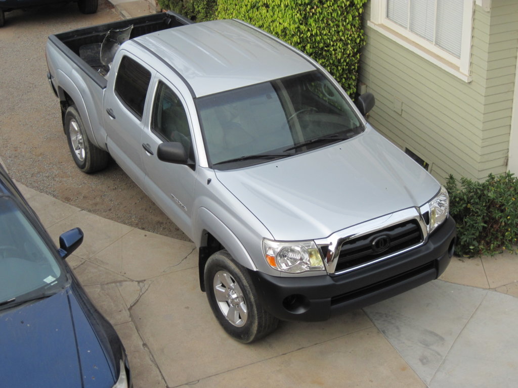

    I live in San Diego and restored a wrecked NSX and a wrecked 2006 Tacoma outside before. No garage in houses under a million dollars in San Diego (I don't have a million dollars) I see your garage drool... So outside and good weather is all I have to work with. I don't see precut kits for 2003 Tundra's out there, too little demand I guess. How many feet roll would I need? 75? I do have a variable temp heat gun and have used it in the past, once had a body shop about 20 years ago. I have no access to a paint booth out here, my last 2 stage paint project lasted about 10 years with open exposure to our sun out here, hoping PPF wrap will last at least as long. Plan to learn doing door jambs first as training exercise where mistakes aren't as critical. How many mil should I get?

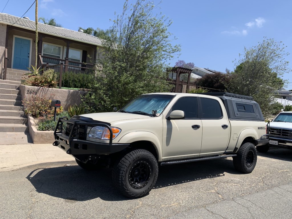

    Cheetah wrap.com. $549 for a 60inch x 75 ft roll, it would be enough for your truck…,,…..if you don’ t have any big do- overs. I am going to be redoing my hood to a satin finish. If you want you could come over and check it out while I do it and help me and you can learn how to do it. I have all the tools ,I live in San Diego…..Fletcher Hills area..
