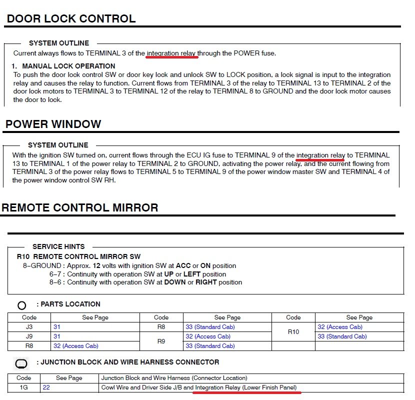

    What is a possible problem which comes up quite often is water penetration which causes corrosion inside the Integration Relay circuit located on back of Cab fuse panel. All three of the circuits with problems meet up at the Integration relay before heading to their respective circuits.

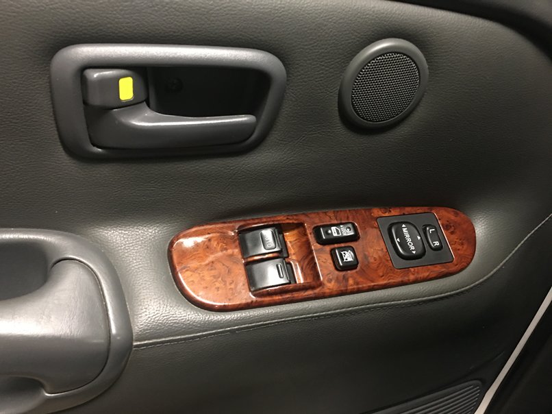

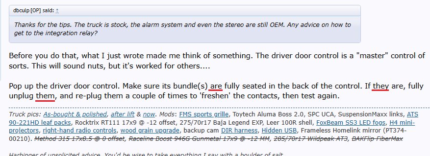

    If aftermarket alarm is present, the doors will have had relays installed, teed off the controls, i.e. the installer would've been in the doors futzing with the main harness to the master/driver door control. If they were to either not fully snap the control in, or damage a wire, ground, couple of wires, it could lend to all the symptoms.
    Before you do that, what I just wrote made me think of something. The driver door control is a "master" control of sorts. This will sound nuts, but it's worked for others....
    Pop up the driver door control. Make sure its bundle(s) are fully seated in the back of the control. If they are, fully unplug them, and re-plug them a couple of times to 'freshen' the contacts, then test again.

    Everything he says is not working is on the driver door control for AC trucks, which the OP owns. I think you may be thinking of DC mirror control being on the dash.
    I'm going by OPs avatar showing an AC, since they didn't bother to explain what cab of truck they have, probably not understanding why it's important. They should really update their 'Vehicle One-Line Description' in their profile to read 2000 AC Limited since we don't necessarily need to know if it's TRD. I didn't think "TRD Limited" was even a thing. Sounds almost like someone got sticker-happy on the bed.

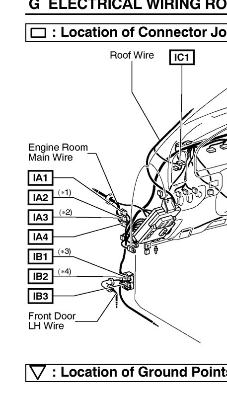

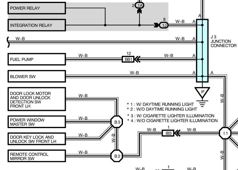

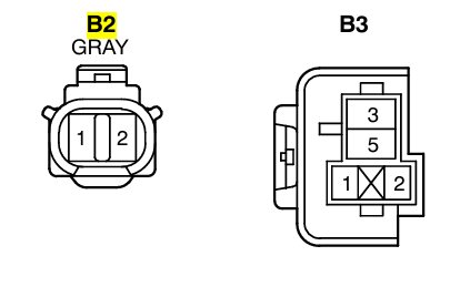

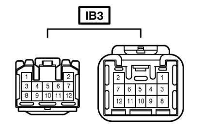

    All of these components do share:
    IB3 LH - IF3 RH connector for power and ground
    Also, the IF ground point and B2 and B3 splice points in the LH door
    It would be worth looking into for voltage and ground testing..

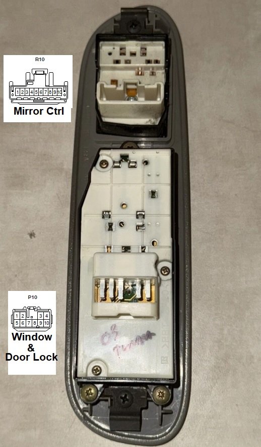

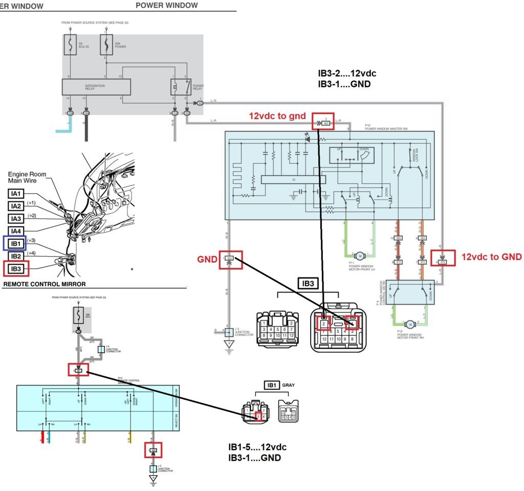

    The reason being, I'm looking at the EWD and know there are 2 separate connectors at the Master assembly, 1 for the Remote Mirror(R10) with it's own separate circuit board and the other for the Pwr Window/Door Lock(P10) with their own circuit board. I forgot some folks don't do EWD's and would not know that....my bad.
    If @dbculp wishes to check the connectors as you suggested, it would be a good time to also check voltages at that Master assembly and other locations as @1lowlife suggested....if he's equipped with a volt ohm meter.
    @dbculp, I have attached mirror and window drawings from EWD if it will help. The complete 2000 EWD can be had at this link---->Ultimate TUNDRA Wiring Diagrams Collection | Toyota Tundra Forum

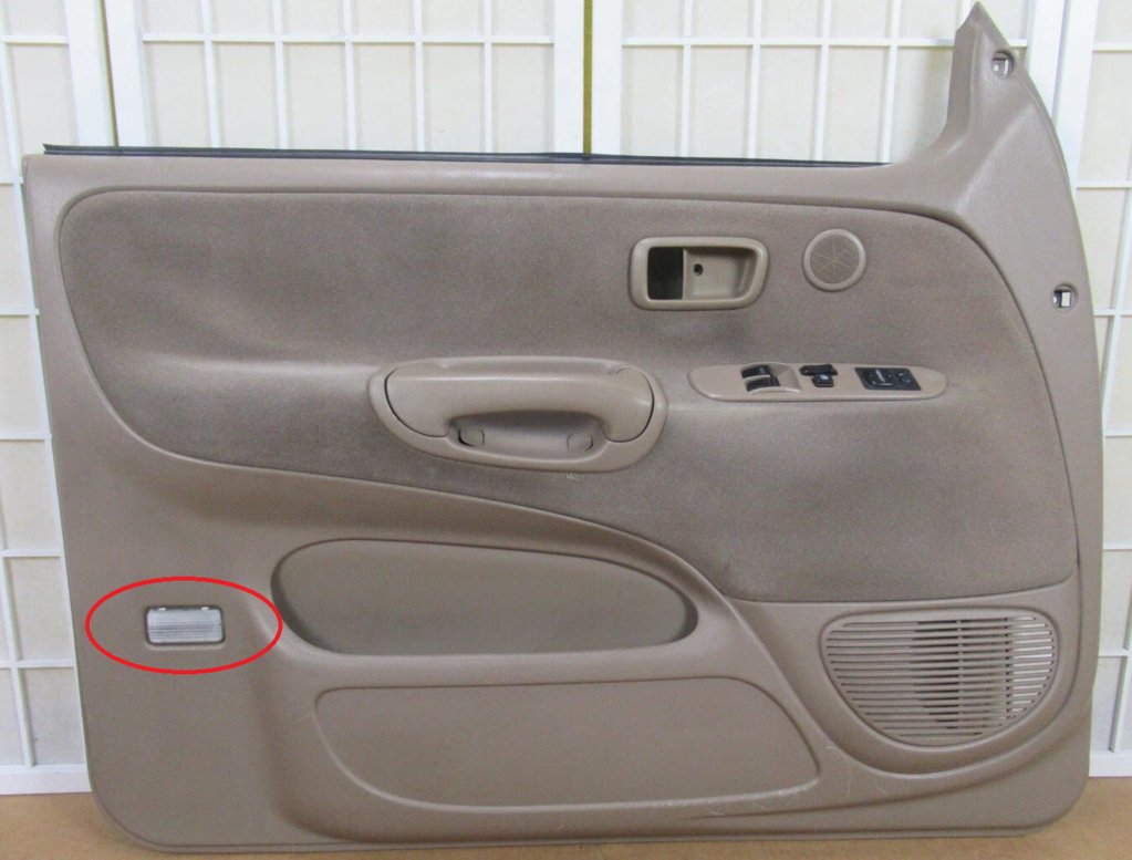

    Does the courtesy light in the door card turn on when the door is open, the one on the jamb side? Just to prove if any power is hitting the door.

    And this is the courtesy light I'm talking about. It should turn on when the door is open. It's the only other thing I can think of in the door that gets power. And the only other thing (other than the speakers) which is on a wire that would send a debuggable signal, and I think you'd know clearly if the speakers weren't working. And if you can think of any maintenance item you did recently, like trying to install a backup camera, that could be good info too.

    If you indeed choose that route, know that's it not for the faint of heart. It's not that it's a difficult job but patience will be your friend. Also when unplugging connectors, mark them good so you know where they go or take good pictures. Definitely unplug battery before diving inn
    If you are equipped and capable of making voltage measurements, I'd take the lead from the info @1lowlife shared and also the EWD's I uploaded and make some checks before diving into the Integration relay.
    The connectors showing in @1lowlife post IB3(driver kick panel) and IF3(pass kick panel) are quick checks for power window and/or mirror. If proper voltage is not there with key in IGN ON position, the next point those signals go is directly to the Integ Relay. Pulling Drver or Pass kick panels are not difficult to remove....just small amount of time.
    The below is power window and mirror checks. If either are not there, your headed toward Integ Relay. Any other checks, let us know.

    Also, the courtesy light does come on when the door is open, so there is at least some power getting into the door.
