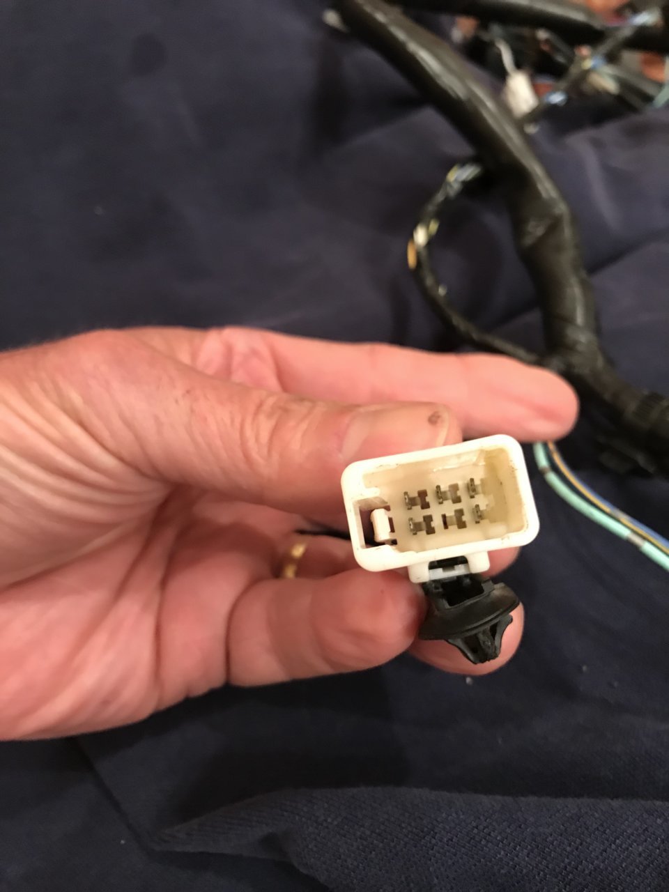

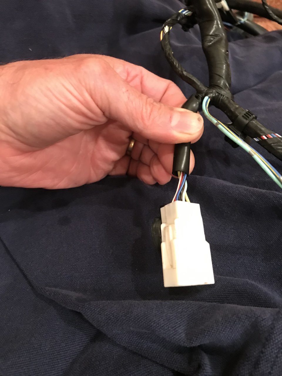

    This little thing is going to give me a problem. Somebody cut off the one on the drivers harness. The housing is available from Toyota but I bet it will not be pinned. I will get it ordered tomorrow and see what I get.

    Most of the terminals on these old trucks are 090 style so pretty easy to source and add. I don’t recognize that specific connector though. And you need something to serve as a reference for the pinouts. Or the doc w colors.

    upload_2022-3-16_6-28-5.jpg The pins in it are little flat rectangles like diving boards about half an inch long each? I do have the wire diagram and I have traced and labeled all of the cut wires.

    Hopefully good news from the Toyota dealer. The connector number is 90980-11452 and the man on the phone said I could get the pins and wires for it. The connector itself showed to be back ordered, but he said he would have an ETA in a day or two. The pins and wires I can get tomorrow.
