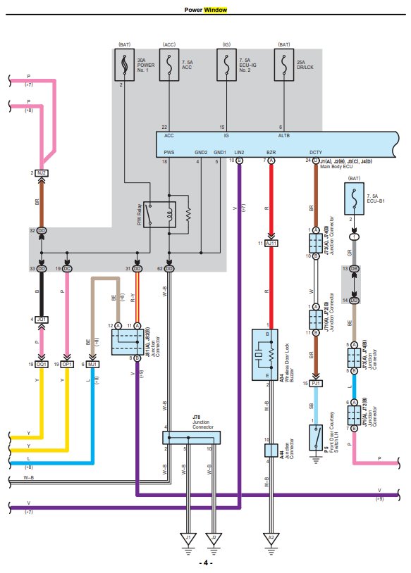

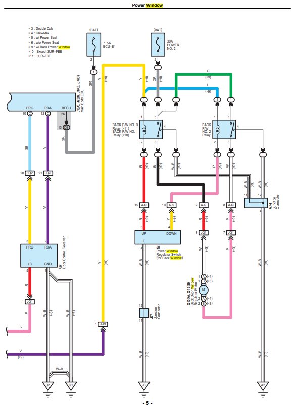

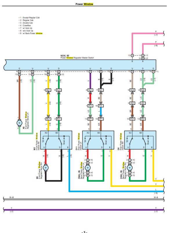

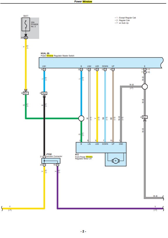

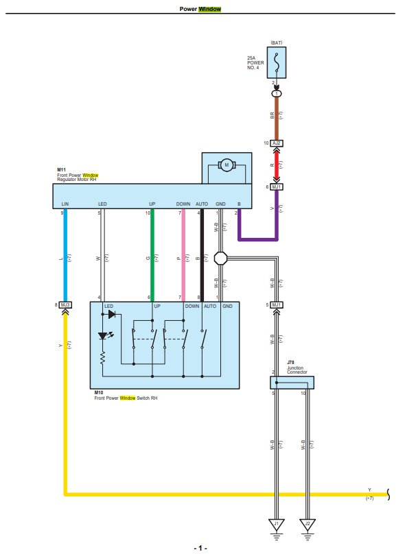

    If you can read wiring diagrams they can be found here.
    Ultimate TUNDRA Wiring Diagrams Collection | Toyota Tundra Forum (tundras.com)
    What trim level do you have, SR SR% Limted etc.
    It makes a difference because higher trim levels have auto-up and down.
    It makes a difference in reading the diagrams
    I'll post the pages that pertain to the windows.
    At least you will know what color wire does what.

    I have those printed off already and have been looking at them as well. Checked the power 4 25a fuse and power 2 30a fuse under hood. All good

    Well I found a cut wire (green) on the driver side in the boot between the door and cab. There is also a few wires that insulation is broken and can see bare copper wire. Now the fun to get in there to repair them. Anyway would explain why it was intermittent. As I continued to open and close the driver door it would probably make contact
