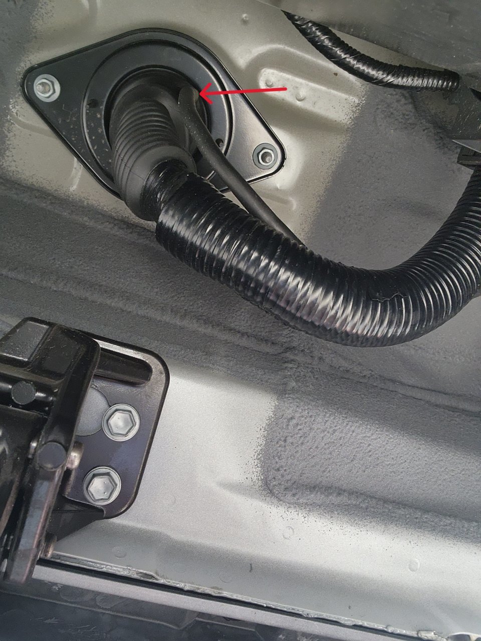

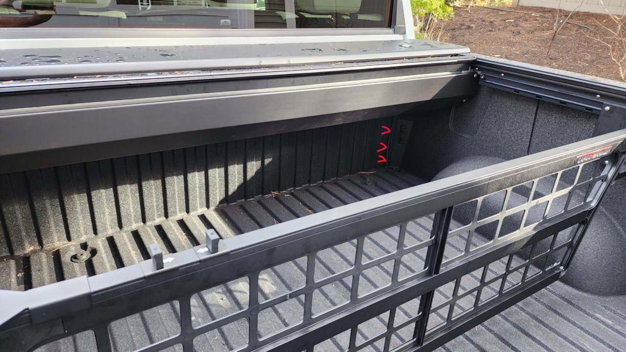

    Hi,
    TIP:
    Just installed the Roll'n'Lock E-Series tonneau cover. To my surprise, there is no battery under the hood, and found it to be under the back seat, drivers side. So after snipping off a few zip ties I started over. I called Roll'n'Lock and they have never installed on a hybrid so they were not much help.
    Their system is designed to route wiring to the driver's side of the bed. I found it "much" easier to route to the passenger side. This is because the main harness comes up through the passenger side of the rear seat which then can be fed through to the driver's side, where the battery is located. I included a couple of pictures to help. I used some of the tar tape that was included with the tonneau cover to seal the penetration area of the grommet.
    Hope this helps!!
