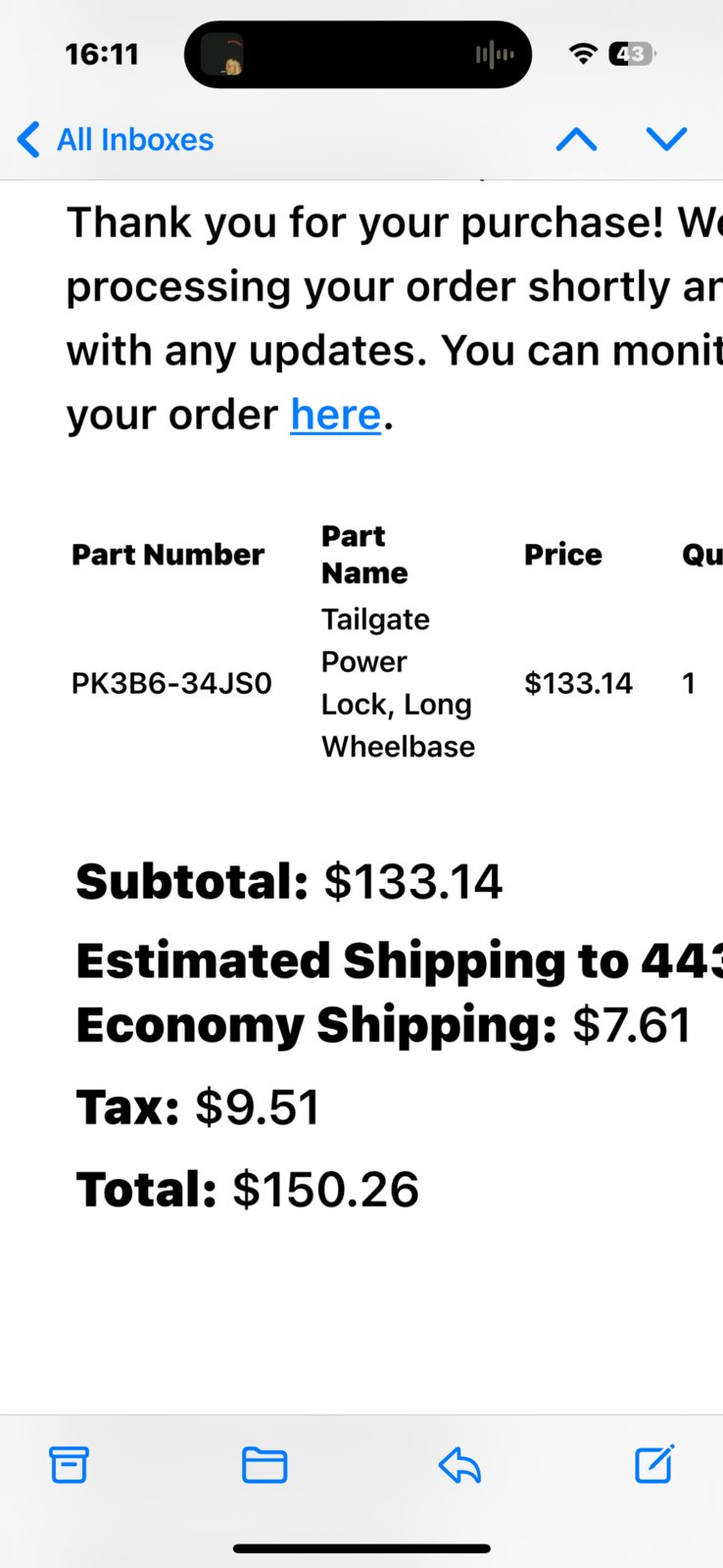

    I also ordered the OEM. for $150 out the door it's not horrible. This thread convinced me to buy it. Now it's just sitting in my garage waiting for me to find the free hour to actually install it.

    do you remember where you bought it from ? Best price I can find is from BAM for $200 out the door.
