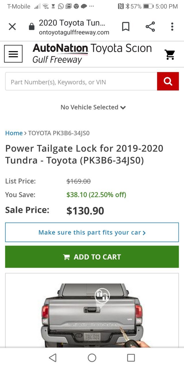

    Here's a screen shot of the part number. I got it for about that price maybe less. But my family does have an auto business so I get stuff at cost. Hope it helps.Screenshot_20201008_170007_com.android.chrome.jpg
