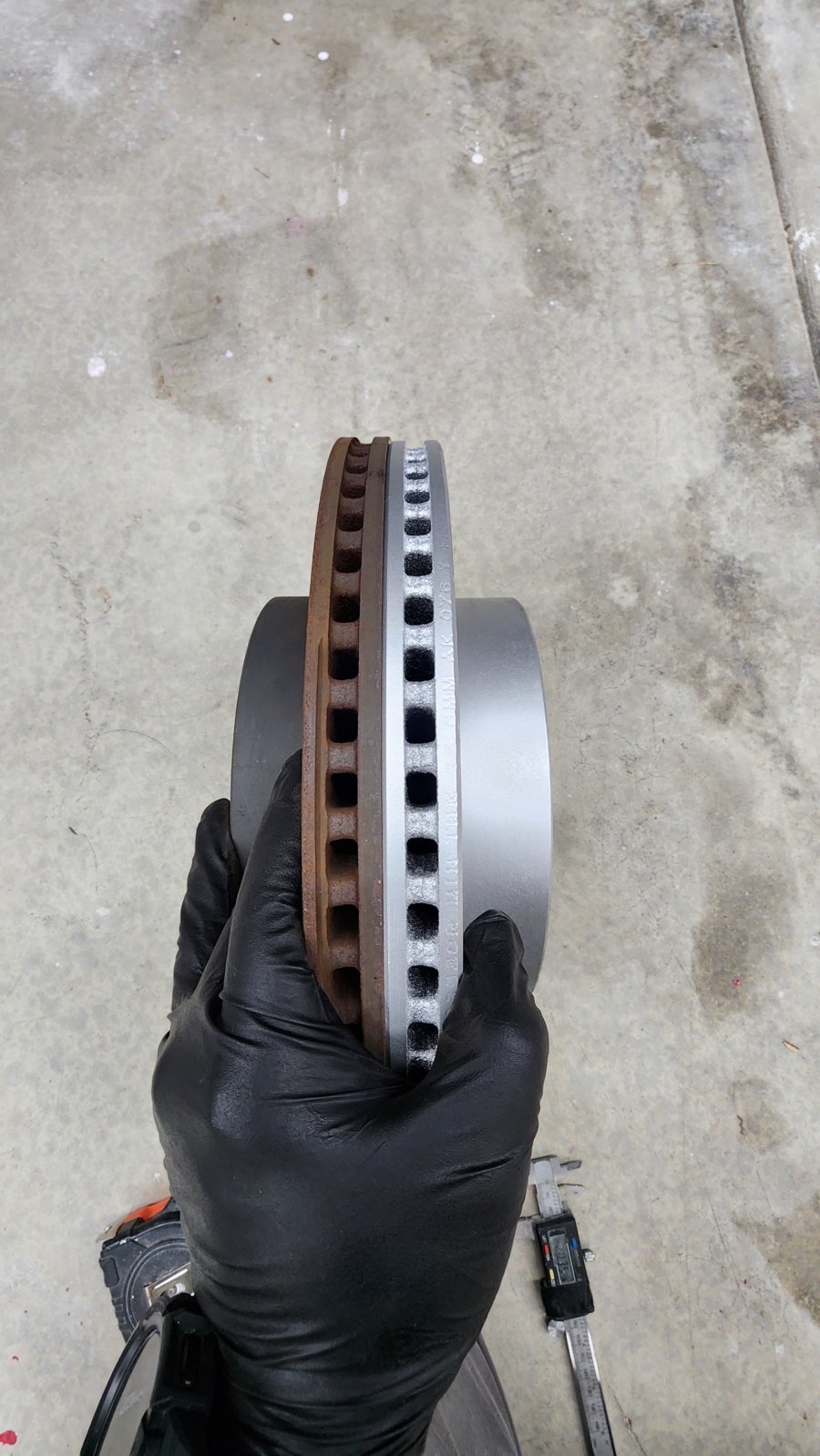

  7. Apr 28, 2024 at 8:19 PM
    eddiefromcali
    eddiefromcali [OP] New Member
    Mar 14, 2022
    #75818
    2,964
    Eddie
    2022 Tundra Platinum
    100% Stock
    Napa rotors on right. 20mm thick. Stock rotors are 19.83 inside the wear lip. Lip is 20mm thick
    Napa rotors vents are 9.20mm X 8.43mm. Stocks are 8.99 X 8.23mm
    Both 16.5lbs
    ATV25 and Kap1 like this.

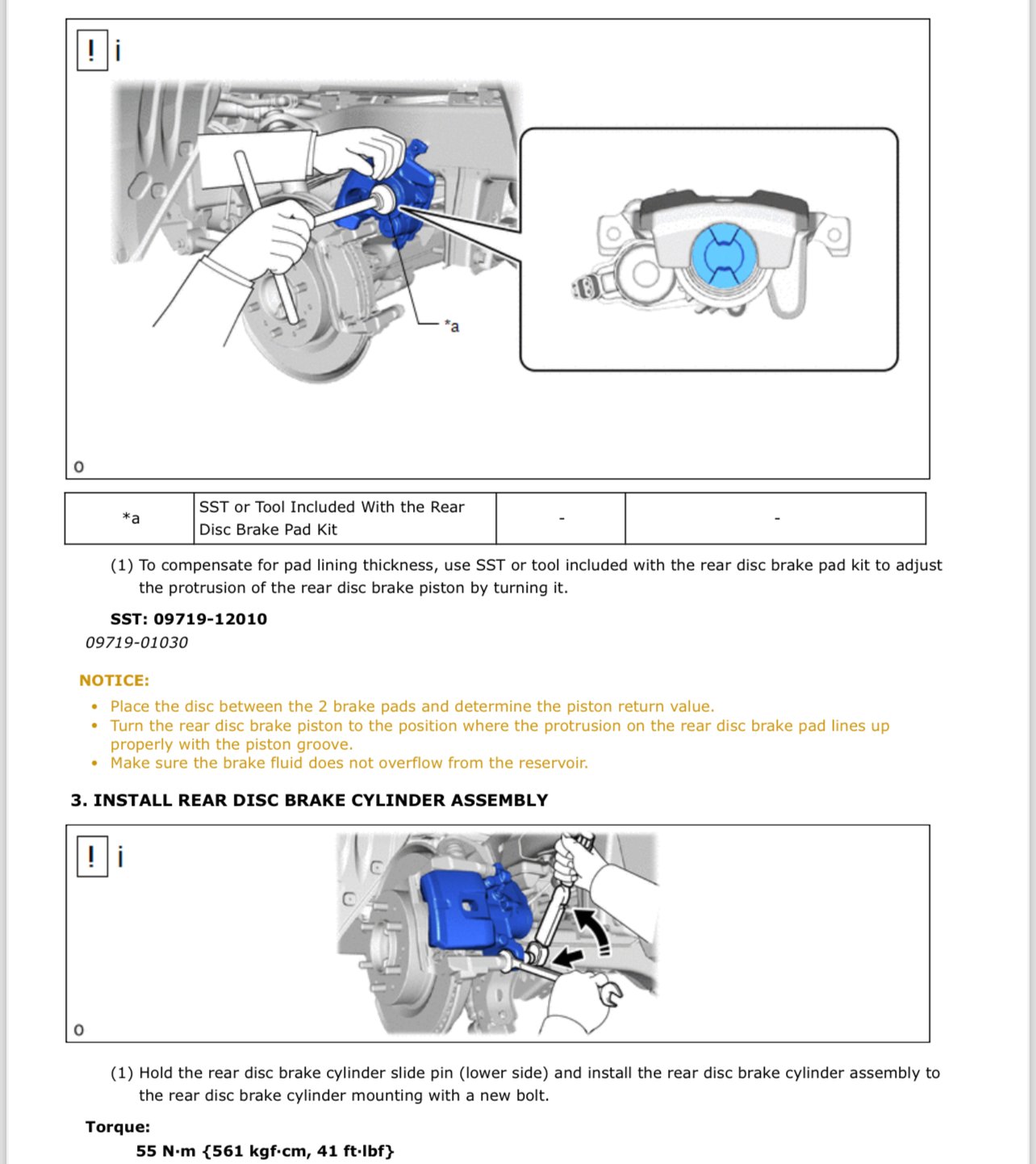

  11. Apr 29, 2024 at 7:30 AM
    TakiEvo
    TakiEvo New Member
    Dec 28, 2021
    #72363
    651
    Allentown, PA
    2022 SR5 TRD Sport Crewmax White
    There’s no special trick for the electronic integrated parking brake on the 3rd gen. It’s just like a regular mechanical integrated parking brake.
    Just got to turn the piston in with a brake caliper compressor tool. They like $25 from Amazon.
  12. Apr 29, 2024 at 8:01 AM
    eddiefromcali
    Mar 14, 2022
    #75818
    2,964
    Eddie
    100% Stock
    Did try that and it did spin but it kept twisting the seal. Didn't know that was the actual procedure. Thanks!

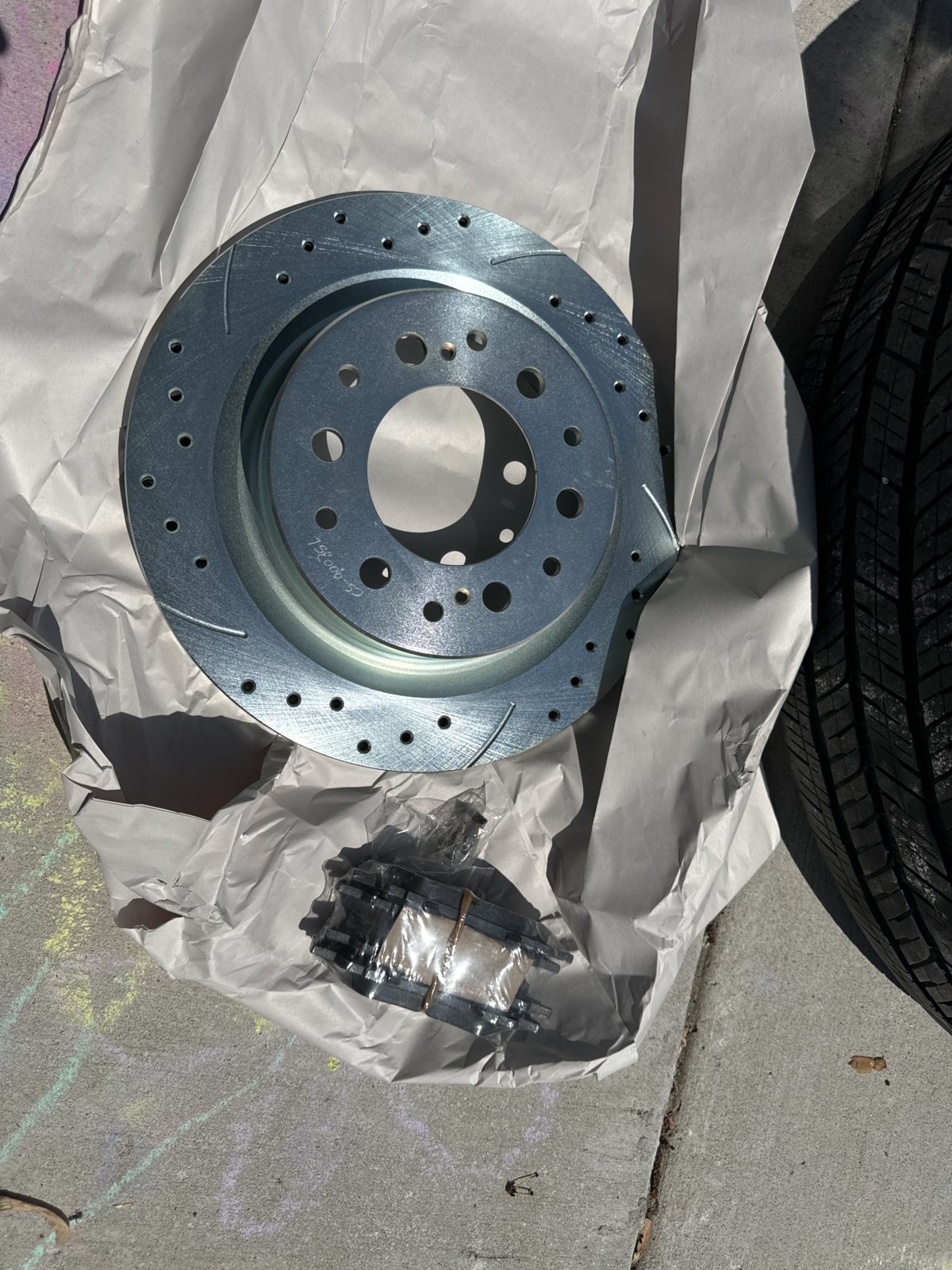

  16. May 12, 2024 at 9:33 AM
    BlazingGSXR
    BlazingGSXR New Member
    May 12, 2024
    #116734
    2
    Jeff
    2022 Army Green Crewmax Tundra Limited
    AFE hot charge pipes, TRD air filters
    Brakeperformance.com
    These are for the rear. Have had the fronts on for around 15k miles already. $210 for pads and rotors
