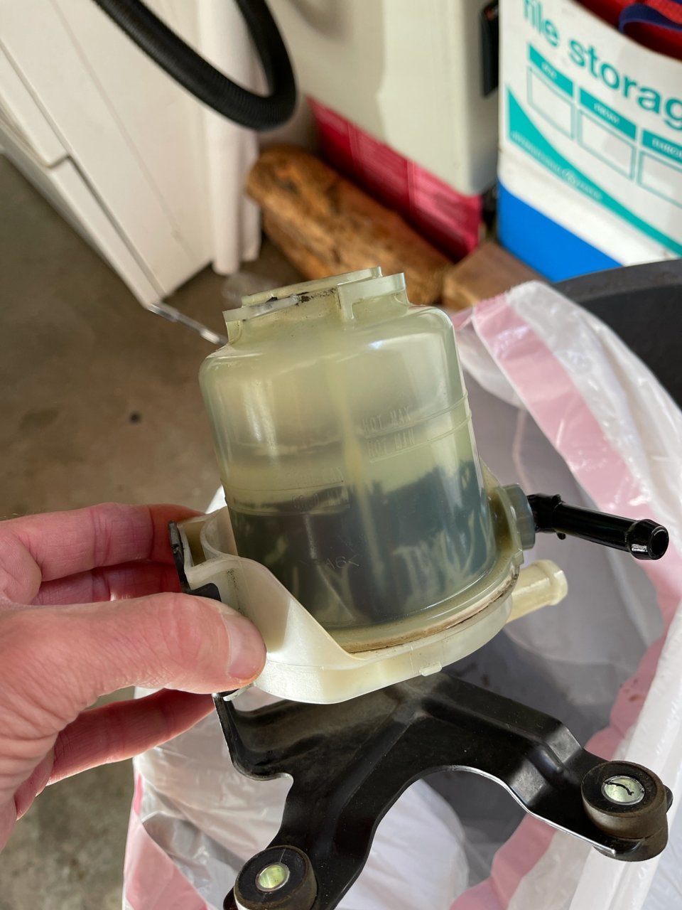

  8. Feb 19, 2021 at 10:28 AM
    Rocko9999
    Rocko9999 New Member
    Dec 30, 2020
    #56832
    951
    Thanks. I changed a few more reservoirs worth then pulled the reservoir and cleaned it. Had a coating of black slime inside. Sprayed it out well with brake cleaner and got the screens clean. Seems to be much quieter now. I think 2-3 more times and most of the fluid should be replaced.
