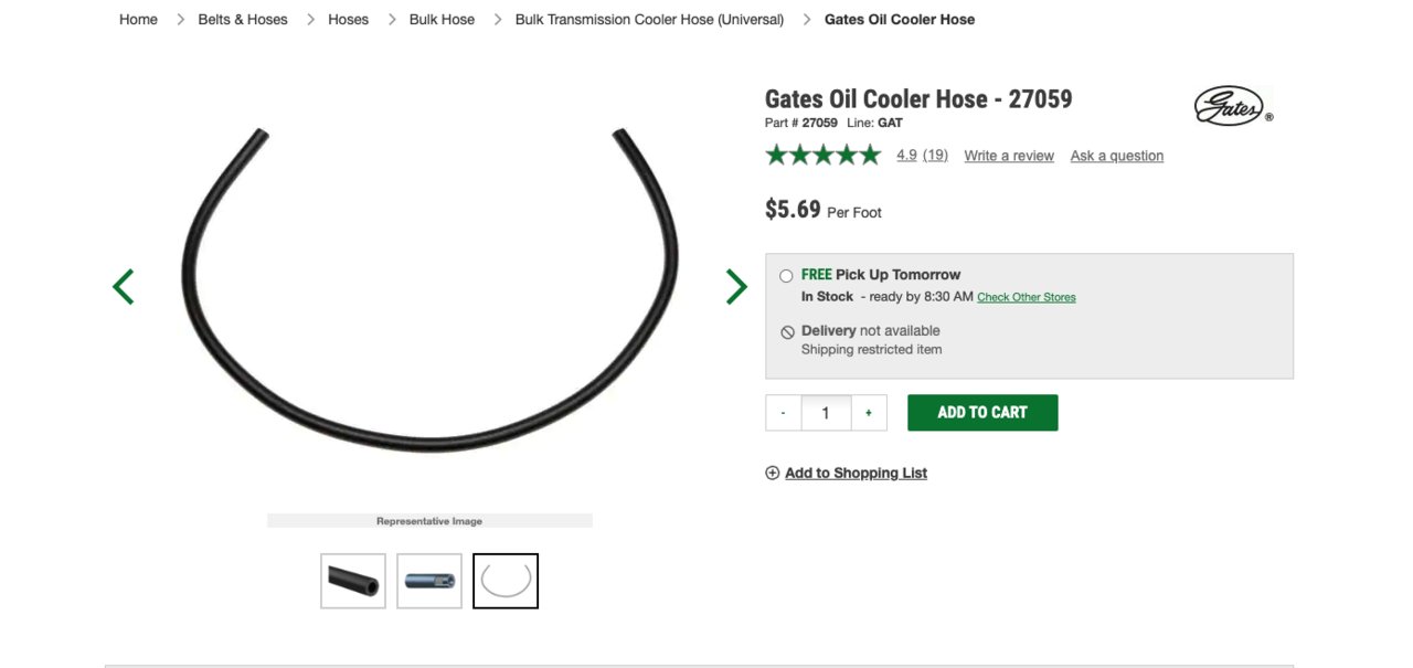

    - Cooler to reservoir line is leaking, I'm looking at the Gates oil cooler hose 3/8 inch hose as a replacement, since toyota doesn't just sell the hose itself, they just want to charge the whole cooler assembly for $$.
