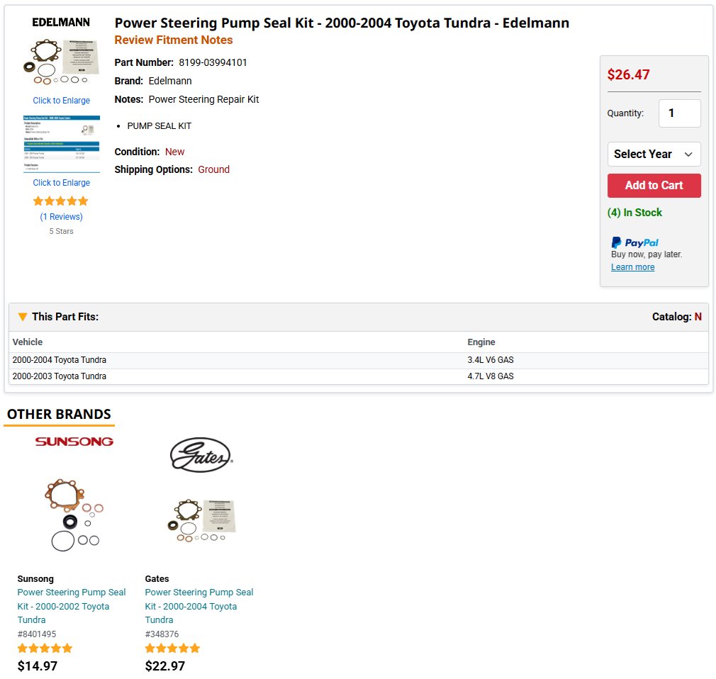

    Nothing for naught but there's supposedly a rebuild kit or two out there, here's one I found: https://www.partsgeek.com/m4r61x9-toyota-tundra-power-steering-pump-seal-kit.html
    I cannot confirm or deny it's right, but it seems to fit and is a fraction of what a new part cost. But until you tell us why you need one, can't really know if a simple rebuild is in order.

    Actually, posting this here just 'cause. Parts numbers listed here.
    There may be more than one kit, I'd trust the Gates kit, looks identical to the phoo for the more expensive Edelmann kit, though some have had luck with Sunsong lines on our trucks...

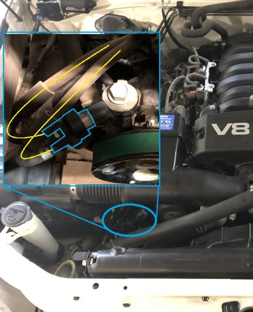

    One. Our trucks have a natural low groan from the power steering pumps. It was very offputting to me when I first got my truck, I was thinking to myself 5ish years ago, "How the hell would the power steering pump be going out with 60k original miles?!" A lot of people say putting a tablespoon of liquid fabric softener into the reservoir helps reduce some of that. I'd really need to hear it with my own ears to confirm whether your groan is naturally what we expect, but it's worth mentioning, every 1st gen I've ever heard has a slight groan to the power steering, and it's a sound I associate with - after 40 years of turning wrenches - a sketchy power steering pump.
    Two. "Takes a few seconds for assist to kick in". "Assist" comes from the Power Steering Air Control Valve which is located here (the blue thingy). That valve is known to fail, and when it finally does fail, you'll sometimes see puffs of smoke out the exhaust during cold starts. If the vacuum hoses going to/from it (yellow lines) are cracked or loose, it will behave as you've described also, but soon-to-fail valve may also. The valve is expensive, regardless whether you buy OEM or aftermarket, but it's very easy to test if it's working properly or not. It's sometimes a bitch to remove the valve so you can reinstall another. The valve is one-way, so if it's sticking as it tries to open, you'd absolutely feel a delay in power steering to kick in. Again, testing will answer whether the valve is the problem. But the basic concept of that little blue rabbit-ear looking valve is simple: When the pressure rises in the power steering system because you're turning the wheel, the valve either closes or opens (I forget), which changes the vacuum pressure on the engine, causing the idle to kick up, IIRC, making it easy to turn.

    Thank you for that info. I haven’t had any smoke on startup since I bought the truck in November but I will definitely test that valve later today.

    Performed another flush today, this time I thoroughly removed all the fluid and spent wayyy too long cleaning the reservoir and got a ton of junk out, refilled it and bled it and still very loud. So fr33lance or rebuild kit will likely be in my future.
    My valve seems to be faulty as rpm neither increased or decreased during the test.

    Seriously. Supposedly helps. Haven't tried it myself, but multiple people here have done it with our trucks and previous vehicles. You may want to research which brand is recommended.
    As long as you followed the directions to the letter, and didn't forget to fully turn the wheel full-lock left or right before starting the test, then yeah, valve is likely bad.
    Honestly, the Dorman brand part from a reputable source (i.e. not scAmazon or fleaBay) should do you fine. If SMP (Standard Motor Products) sells one, I'd trust them too.
    BEFORE you replace or service the pump, replace that valve heed this warning. Air in the system *will* cause added moaning/groaning. If, after flushing the system, you didn't chock your rear wheels, lift both front wheels, start the truck, and turn the wheels lock-to-lock a few dozen times slowly to push ALL air out of the system, you should do that. Draining/refilling is a very easy/common way to introduced air bubbles into the system.
