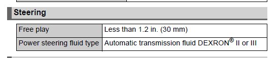

    Manual says use atf. Went ahead and did it that way but after seeing Car Care Nut video he discouraged it because of possible issues with seals long term. Should I change it again to power steering fluid? Noticed when it’s very cold it feels different. Otherwise feels fine .

    I used exactly what my owners manual said, the color at least matched lol.

    I used STP Dex III.

    Or just stick with the Toyota recommended fluid. P/N 00718-ATF0020210807_102222_4760655d96d967ce720c8cfb0ec2ee2c14c019a4 (2).jpg
    This is the new bottle. The old bottle just says automatic transmission fluid. Both are same P/N.

    Thanks for all the responses. Went with Toyota atf. Guess I’m good for awhile

    If the color matched, then someone must have done it before you, the stuff that comes stock is clear and not red.

    Nope bought the truck new. It was red when I checked every time I changed oil. I do my own maintenance and work. I have trust issues, lol. At the end of the day I used Dex III ( red color) like the owners manual says.

    Wow, every other report I've seen from people here is that thier fluid was clear. Mine definitely was clear since new, which was why I went down a rabbit hole trying to figure out the correct fluid, ended up going with the Toyota Dex II+III fluid 00718-ATF00.

    Mine was clear when I changed it. Owners manual calls for DexIII, red it is…

    Just got finished with my first power steering flush. I used castrol synthetic multivehicle. Looked up the spec sheet and it complies with current Toyota standards. Used about 1.3 qts to flush.
    A fluid evacuator hooked up to the return line made quick and clean work out of it.
