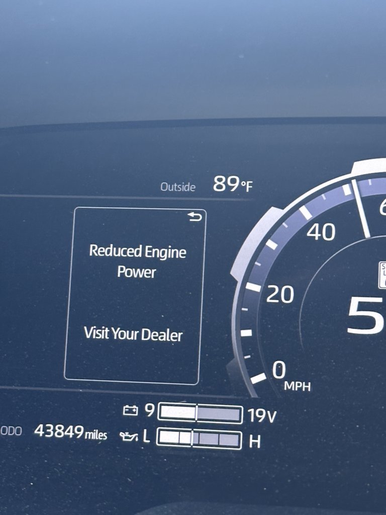

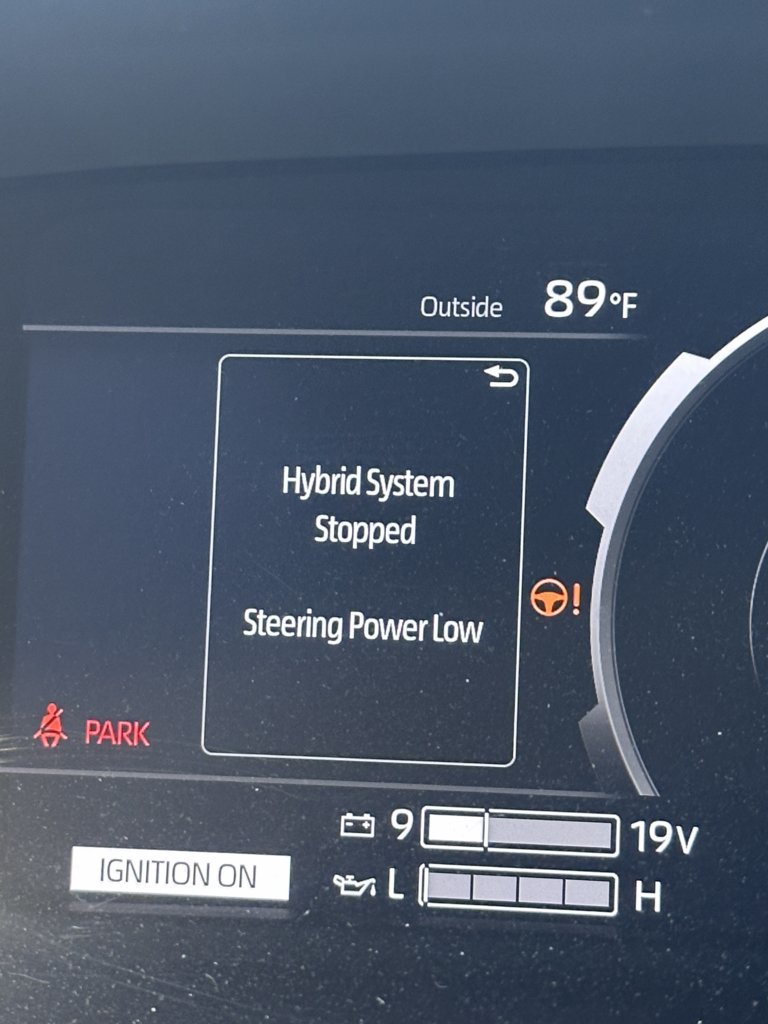

  19. Jul 31, 2023 at 12:51 PM
    bbigelow6573
    bbigelow6573 New Member
    Jul 4, 2022
    #80283
    11
    Brian
    2022 Crewcab Platinum
    Has anyone here had there engine shut down do the the steering?
    I had to have my truck towed to the dealership
    iKampz likes this.
  20. Jul 31, 2023 at 8:44 PM
    xc_tc
    xc_tc New Member
    Dec 28, 2021
    #72329
    895
    Your engine shut off for another reason. Since the steering is electric, you get this warning when then engine shuts off abnormally.
  21. Jul 31, 2023 at 9:12 PM
    bbigelow6573
    Jul 4, 2022
    #80283
    11
    Brian
    So far the shop can’t find around the battery why there was electrical smoke and no errors. The area toyota rep will be here on Wednesday to look at it. I hope something is figured out.
  22. Aug 1, 2023 at 5:16 AM
    EmergencyMaximum
    EmergencyMaximum New Member
    May 28, 2022
    #78904
    1,355
    That voltage looks a little low on the gauge.
