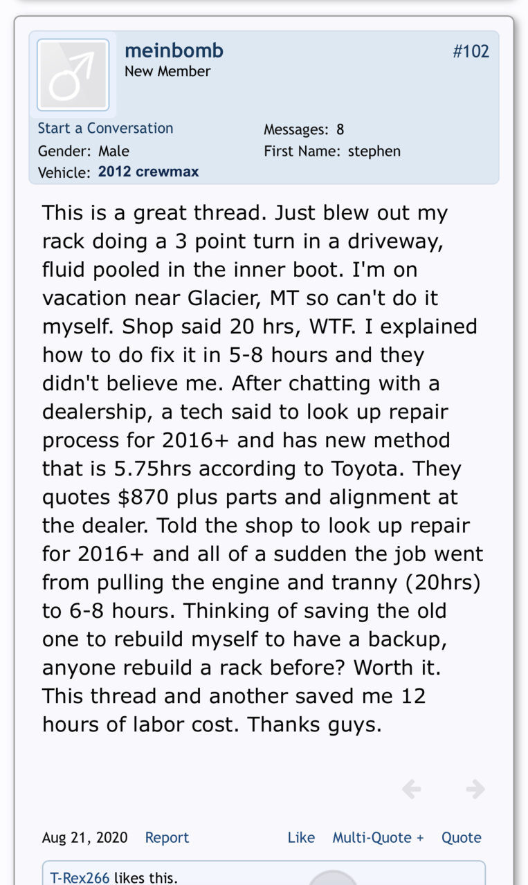

    I just read his thread on the steering rack issue. My parts quote isn’t bad, $500 or so. Seems fair.
    The hours are what put the price so high.
    the book shows 15hrs and pulling the engine. I spoke to the Tech and he said it was a super simple job and the only thing that needed to come out were the tie rods and a few other things directly related — not the engine and tranny.
    I also read that post 2015, Toyota updated the book and made this a 5.75hr job. So that would be why the quote was so high, and the tech was saying it’s no biggie.
    I don’t think I’m delusional in thinking the job will be done for far less than 3Gs. But if I am, correct me now
