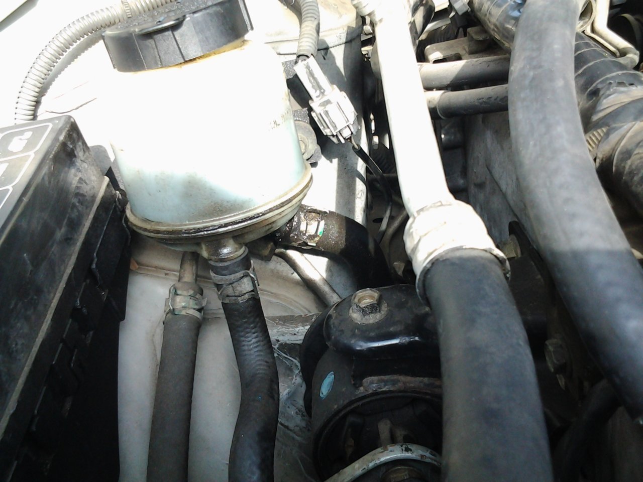

    the farest tube on the right seems pretty bad is has oil around the clamp area and goes down to the power sterring pump. Any idea how what to do about that

    Clean up with degreaser and check for cuts or cracks on hose and reservoir aswell as tightness of clamp.
