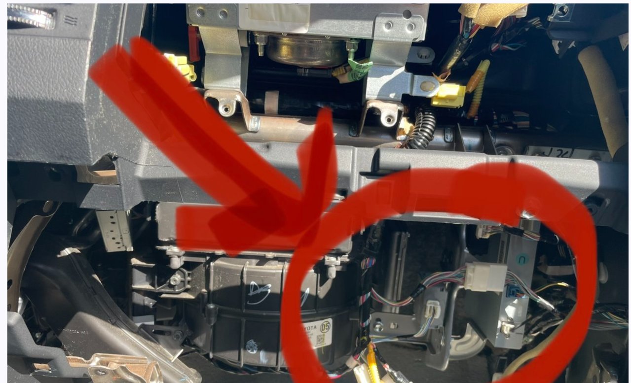

  4. Nov 14, 2022 at 10:59 AM
    Tappling
    Tappling New Member
    Nov 12, 2022
    #86607
    3
    South Carolina
    11 Tundra 5.7L Crewmax RWD
    None
    Where is this part located on the 2011? I cant find it. See picture
